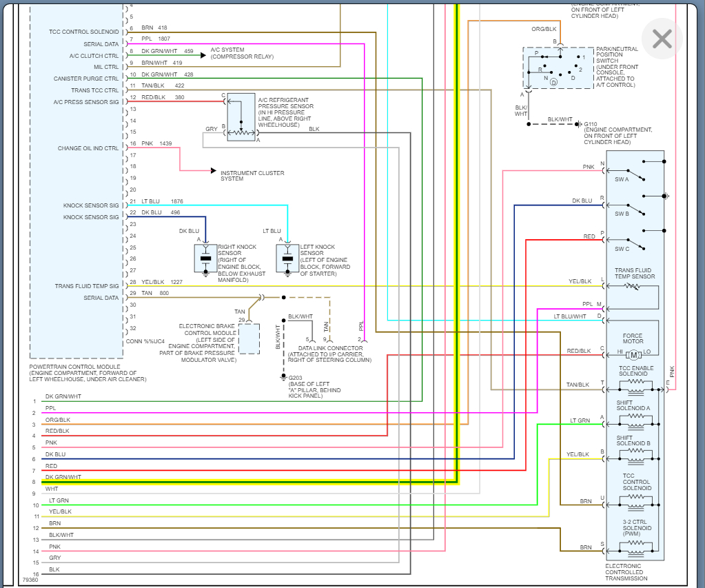

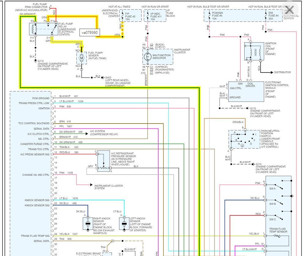

put gas in throttle intake. runs and stops not getting gas to plug.
Jun 5, 2022 at 3:32 PM
We need to start with the basics. That means we need to find out if the pump is building any pressure at all.
Here is a guide that will help with this:
If there is no pressure, then we need to remove the relay and jump power to see if the pump will come on.
If it doesn't then we most likely have a failed pump.
If the pump comes on, then we have a power issue and we need to check the fuse and relay.

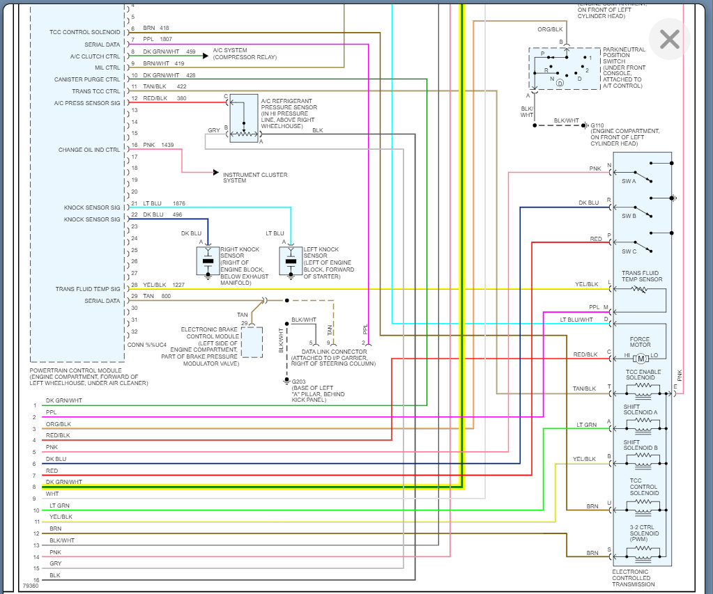

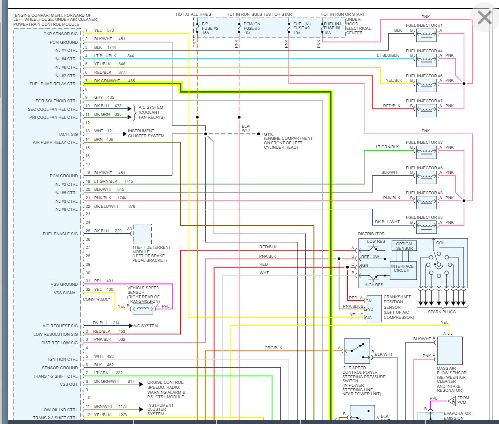

I am attaching the wiring diagram below which will help with all of this but the most common cause of this is a failed fuel pump.
Running through this process will confirm this.
Let us know what you find, and we can go from there. Thanks
