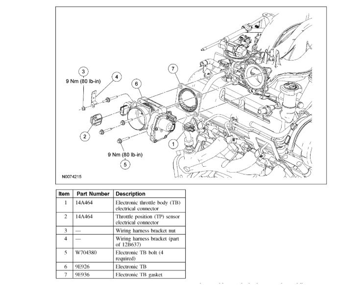

Some research is telling me the throttle body motor or TPS sensor?

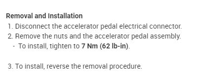

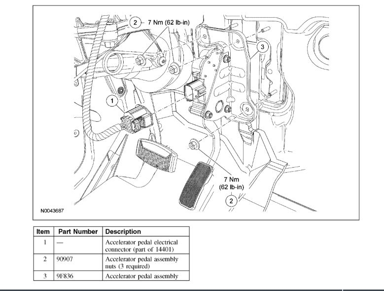

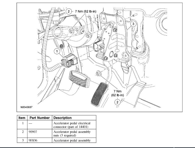

The common causes are the throttle body or the APP or the pedal sensor itself.
https://www.2carpros.com/articles/reduced-power-limp-mode
You need a real scan tool to access the codes. Once you get the codes, then post them here so I can help further.

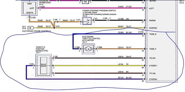

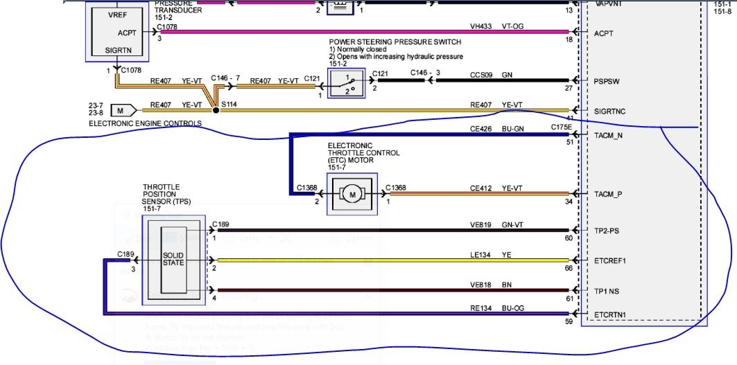

I attached a wiring diagram for you to view of the throttle body control.
Check the connector to be sure it is clean, tight and no damage. It is a common issue for this problem.
With your scan tool can you read live data on the pedal sensor inside the truck?

Will check the connectors and clean the entire throttle body unit and re install.
A new throttle body motor is $230 and a TPS sensor is $146...

Took it back and a another day later they diagnosed a bad TPS sensor on the throttle body. Another $165.00 to replace that sensor and I was on my way.
