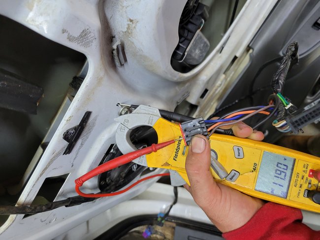

I have the truck listed above duramax with no functions from the driver side to the front passenger window or door locks.
The passenger door module has no functions either.
I do have 12v coming in on the orange wire
I have pulled the wires out of the door jamb and checked for broken wires
I have checked the driver side fuse for the passenger door
The PDM has been replaced.

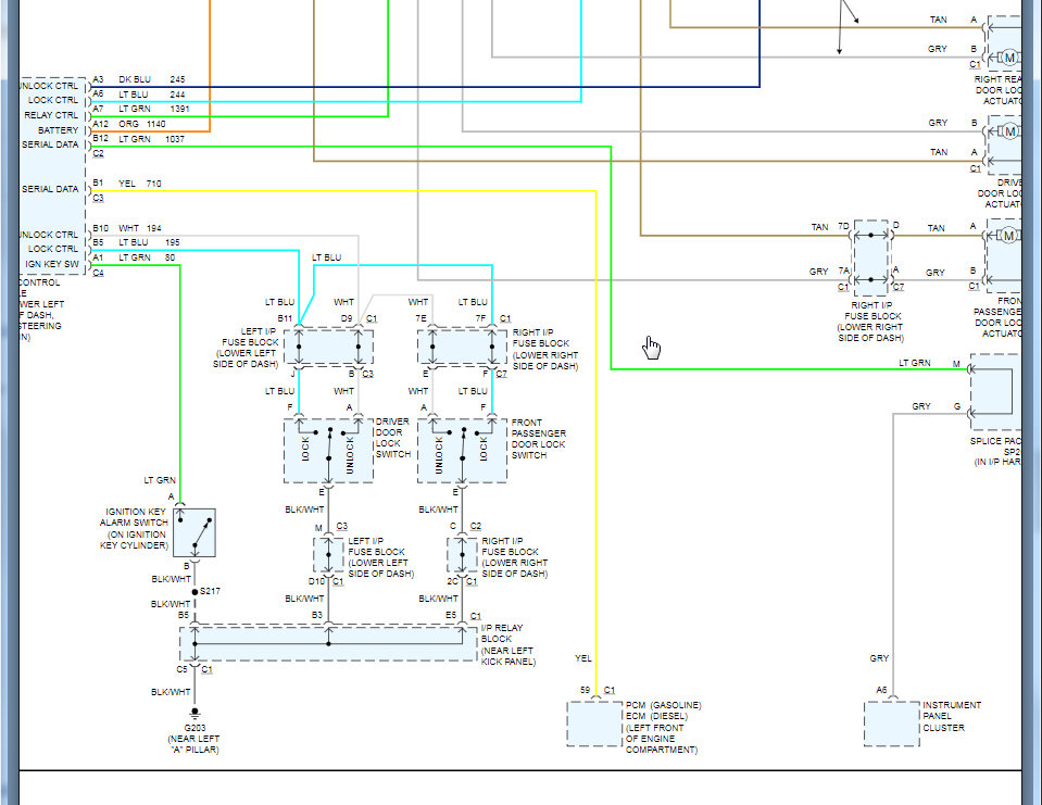

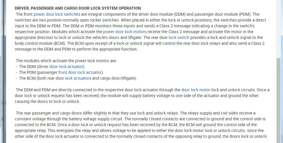

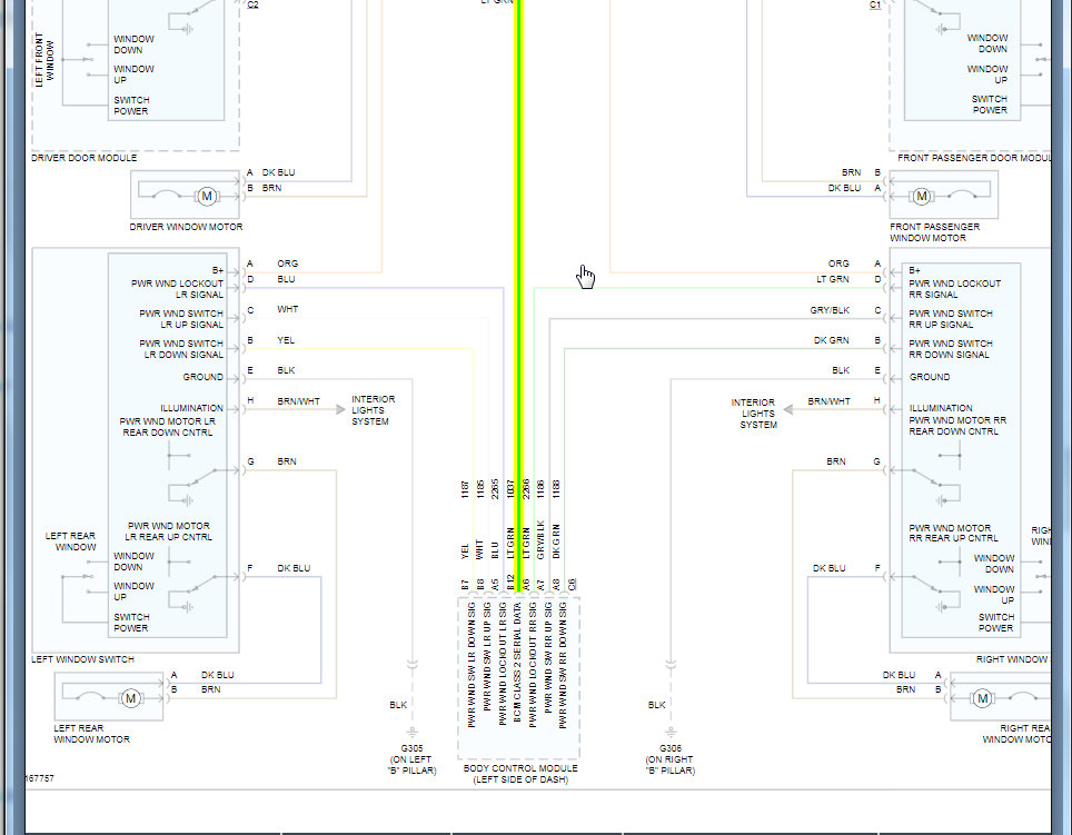

I would suggest focusing on one of the two operations. I would use the door locks and test the voltage at the motor when operating the locks.

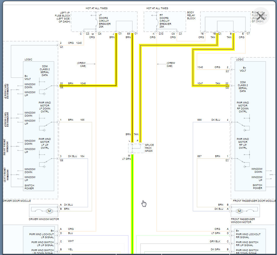

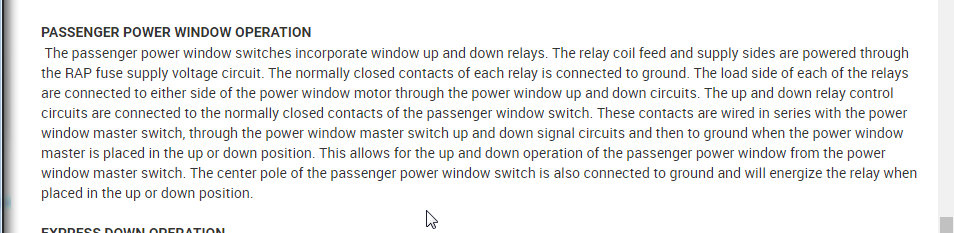

Take a look at the info below. I am wondering if we have two issues.
The locks operating directly from each module for each door. The windows are run through the master switch/DDM.
So if you have a window motor issue that would explain why neither of the switches operates the window but the locks run through the master window switch.
I would suggest checking the voltage at the motor and then go from there.
Let me know if you have questions. Thanks

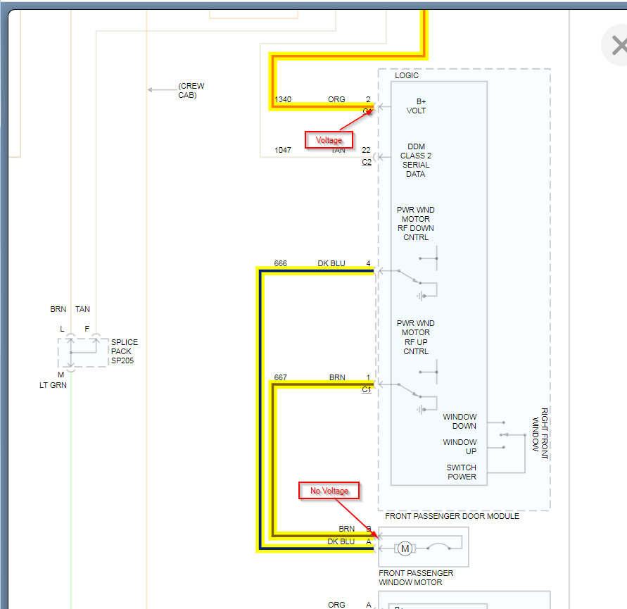

I have checked for power at the window motor, each leg to ground with the switch in the up and down position and I do not have voltage at the window motor. I have applied 12v to the motor to test it and it is good.

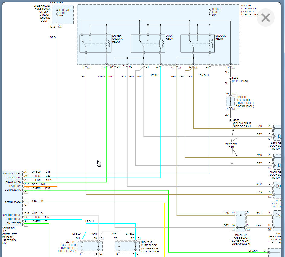

I also tested 12v at the door locks and I do not have 12v at the door locks in either lock or unlock position from the PDM.

I just want to confirm you have voltage in the passenger door module B+ circuit and no voltage at the window motor. See below.
If that is the case, where you did you get the PDM from? If it was a new PDM then the only thing I can think is you either have a faulty module or the driver master module has failed and is corrupting the passenger side.
However, this is possible for the windows but the locks are driven from that door module. So if they are not working either then it looks like the PDM is the issue.

On the incoming black plug I have 12v coming into the plug on the orange wire to ground.
I bought a ac delco switch online
Then after it didn't work I questioned it, checked all the wiring for breaks and when that was good I bought a local Dorman PDM to confirm and it didn't work either. So possibly the driver door module?
If the door locks are separate that's a little odd. The only power I have in the passenger door that works is the incoming orange wire in the black plug and the door speaker works but it splits off prior to the PDM.

The only thing that is throwing me off is the idea that the power locks are not working either.
The locks are different the windows. The window control from the switches are wired in series so if the master switch fails it can cause the passenger to not work as well.
If it were me, I would replace the drivers side and go from there.
