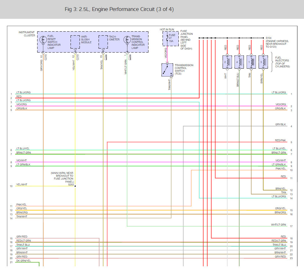

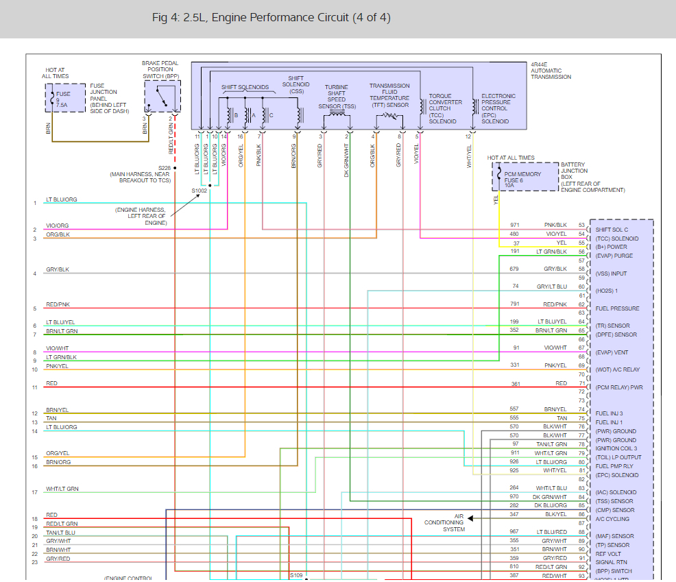

In the morning the truck does not start. After it starts it will run good all day but in the morning will not start. I have a new fuel pump new filter, new relay, box coils. It is like over night the gas goes back down the fuel hose away from the fuel injectors. It will drain the battery trying to start it. Spray starting fluid it will start then stalls. I will give up go away come back in an hour and it will start wright up. Everything is new, I do not know what it could be.

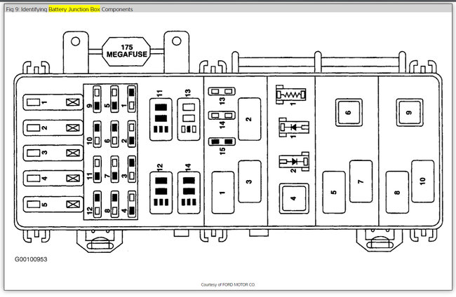

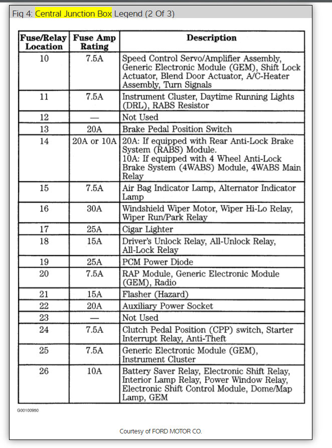

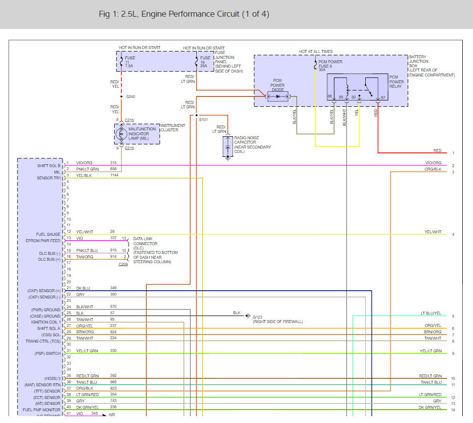

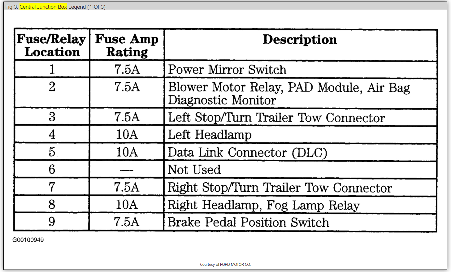

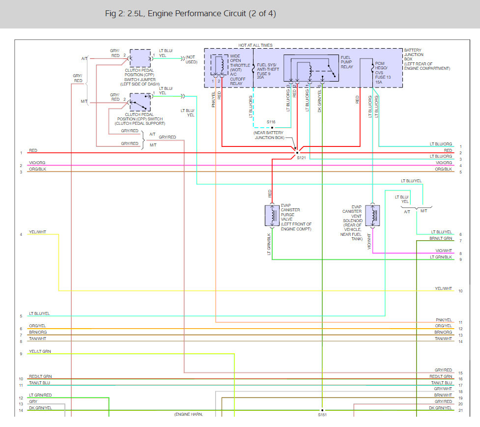

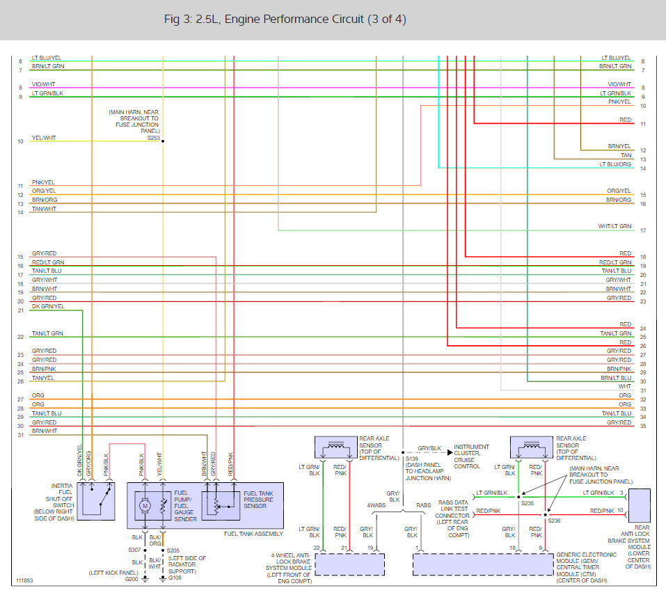

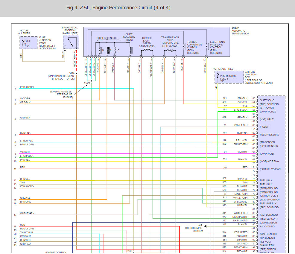

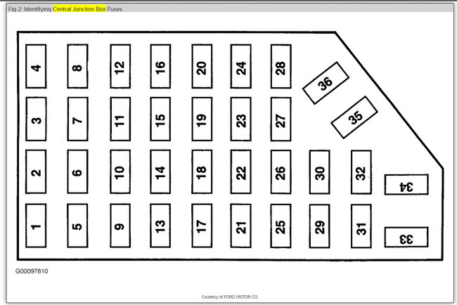

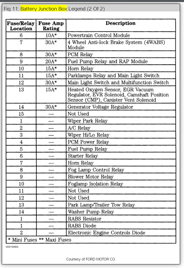

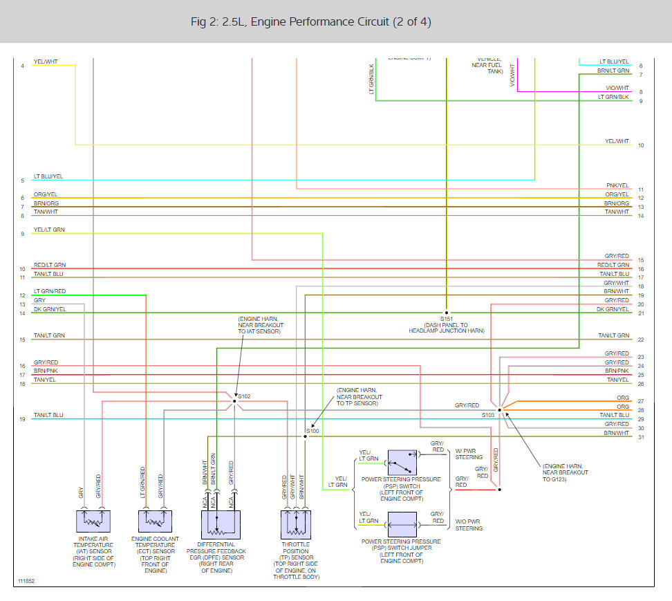

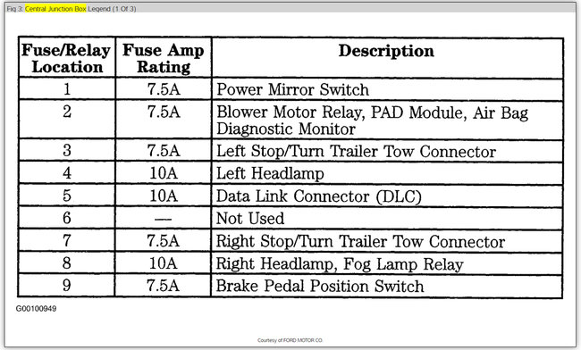

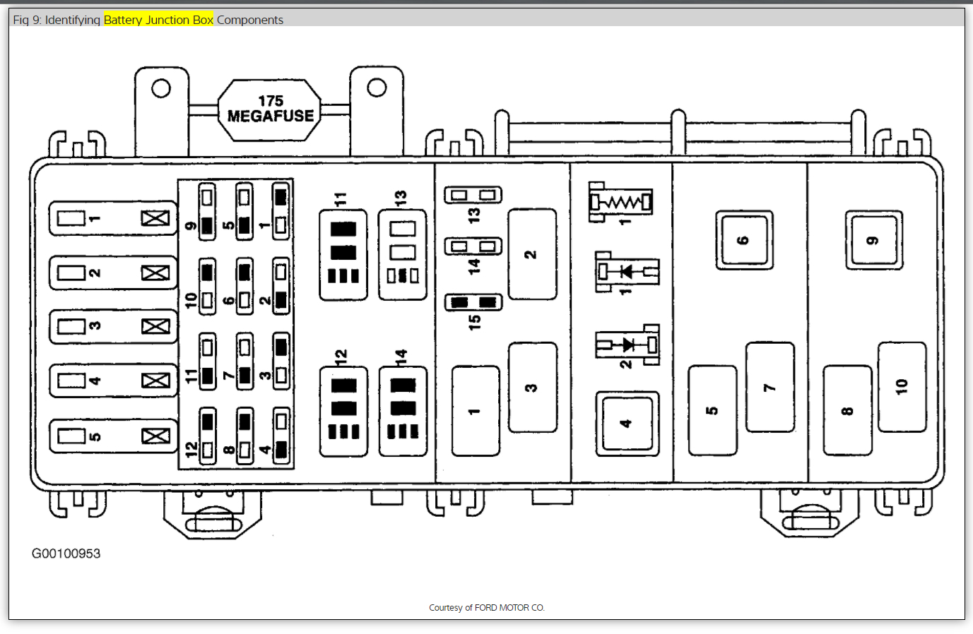

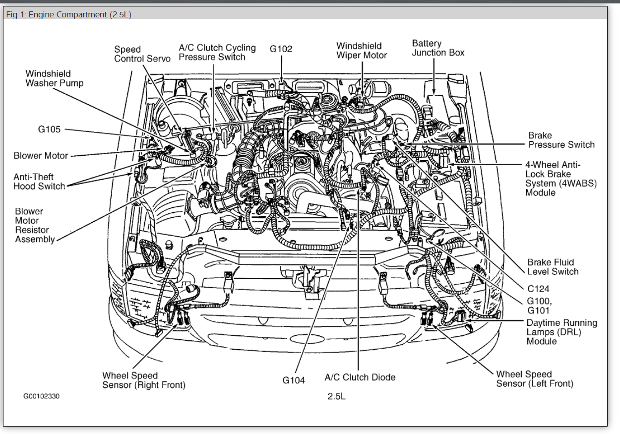

It sounds like it could be a PCM relay or ECM that is going out. Here are some wiring diagrams and guides so you can test to make sure the computer is getting power.
and
Please let us know what happens so it will help others.

Ok It was one of the coolent sensor, It was telling the computer that the engine was 500 degrees, 210 being the highest. When he changes the sensor it started and the car was reading 77 degress. This was a tuff one.
