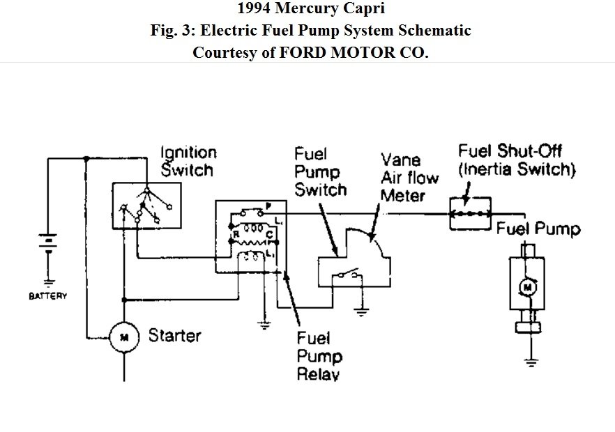

No voltage to fuel pump checked fuse its good checked relay its good checked inertia switch its good don't know what else to check no broke wires ether

When you first turn on the key, no crank, can you hear the fuel pump run?

No car does not run unless u add carb cleaner to throttle body pump not working no voltage to pump

Did you check for voltage on both side of inertia switch? That voltage comes from fuel pump relay. Note the diagram.

Just to add, the capri I looked at was mercury capri, 1.6L, non turbo.
