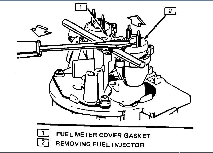

REMOVAL:
1. Disconnect electrical connectors to fuel injectors. (Squeeze plastic tabs and pull straight up.)
2. Remove fuel meter cover assembly, refer to FUEL METER COVER ASSEMBLY.
3. With fuel meter cover gasket in place to prevent damage to casting, use a screwdriver and fulcrum to carefully lift out each injector.
4. Remove lower (small) O-rings from nozzle of injectors and discard.
5. Remove fuel meter cover gasket and discard.
6. Remove upper (large) O-rings and steel backup washers from top of fuel injector cavity and discard.

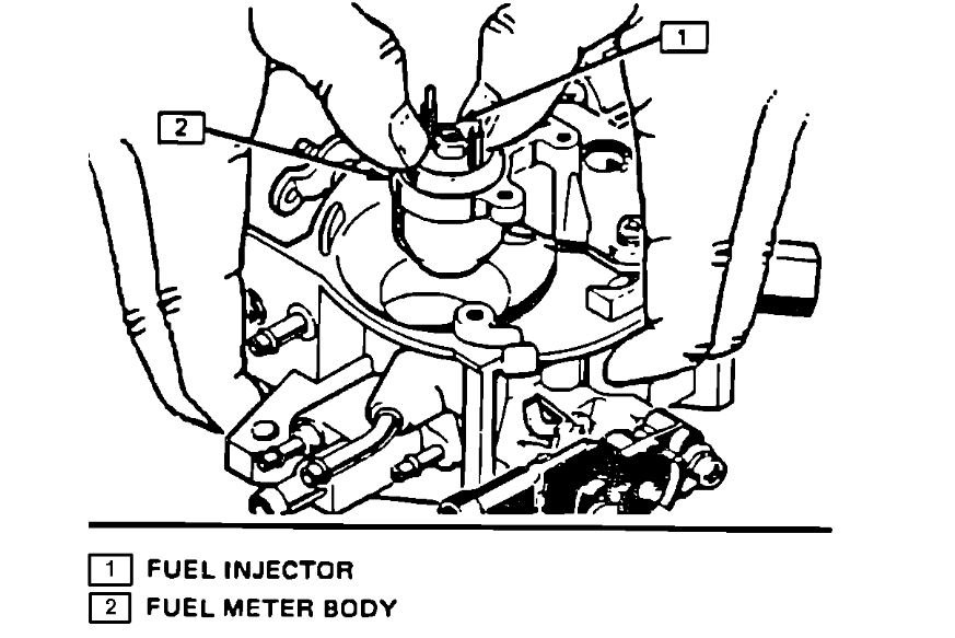

INSPECTION:
Fuel injector filter for evidence of dirt and contamination. If present, check for presence of dirt in fuel lines and fuel tank. If dirt is present refer to MAINTENANCE PROCEDURES/FUEL SYSTEM CLEANING.
Fuel Injector Part Number Location
Be sure to replace the injector with an identical part. Different injectors with different flow rates will fit this unit, but are calibrated for different flow rates.
Fuel Injector Installation
INSTALLATION:
1. Lubricate new lower (small) O-rings with automatic transmission fluid and push on nozzle end of injector until it presses against injector fuel filter.
2. Install steel injector back up washer in counterbore of fuel meter body.
3. Lubricate new upper (large) O-rings with automatic transmission fluid and install directly over the back up washer. Be sure the O-ring is seated properly and is flush with top of fuel meter body surface.
NOTE: Backup washers and O-rings must be installed before injectors, or improper seating of large O-rings could cause fuel to leak.
4. Install injector, aligning raised lug on each injector base with notch in fuel meter body cavity. Push down on injector until it is fully seated in the fuel meter body. (Electrical terminals of the injector should be parallel with throttle shaft).
