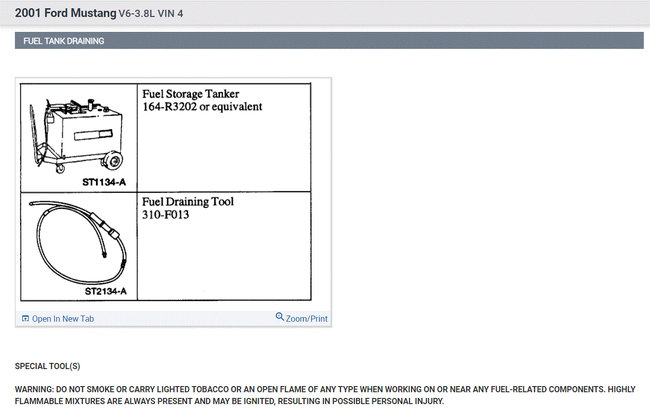

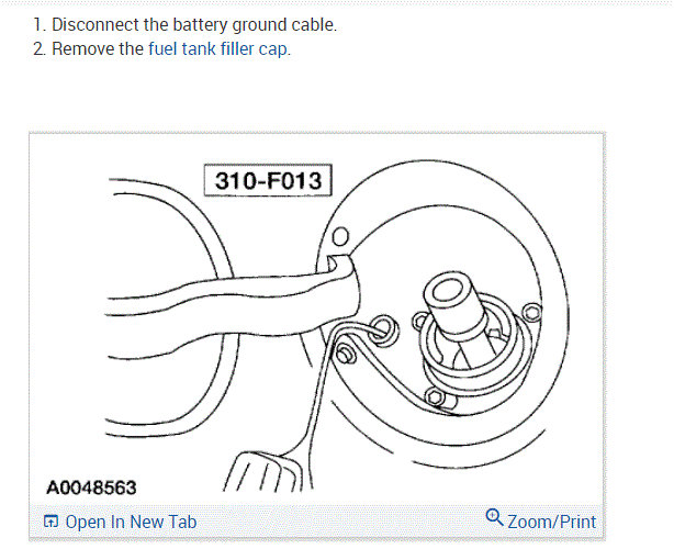

I need to replace the fuel pump but the tank is filled. I can't get a tube down into the tank so as to siphon the fuel out. Any ideas on how i could remove the fuel before i drop the tank?
May 2, 2021 at 8:37 AM
  • 110,251 POSTS

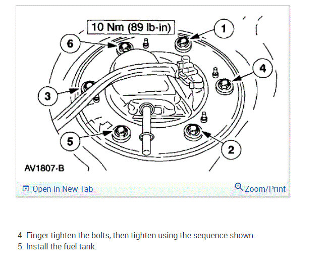

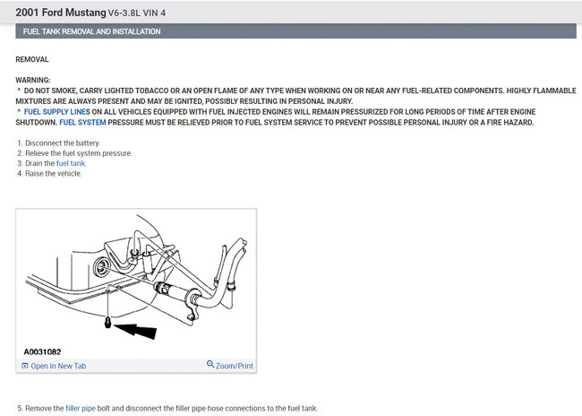

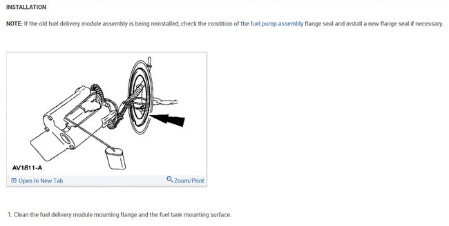

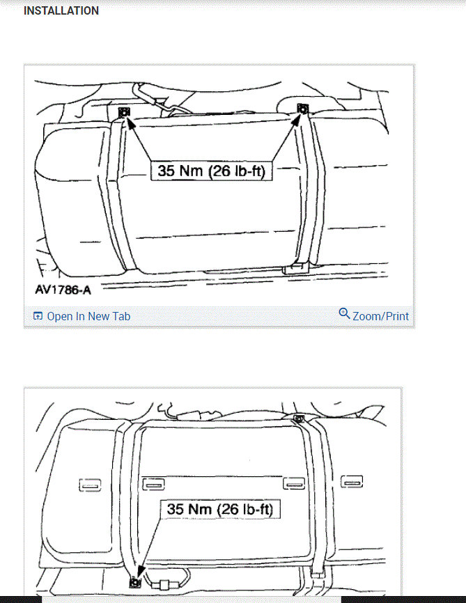

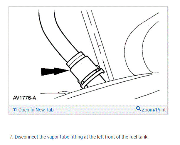

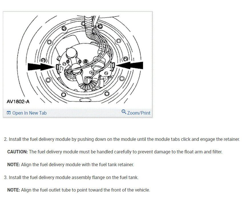

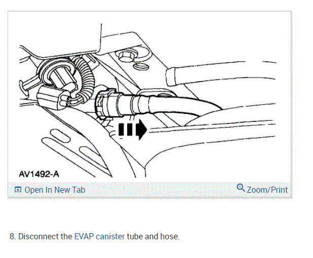

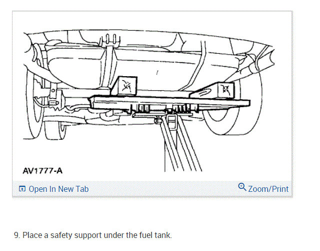

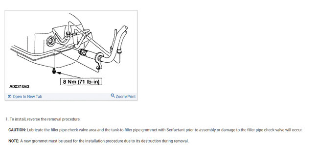

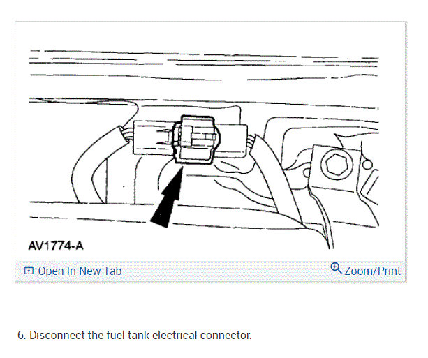

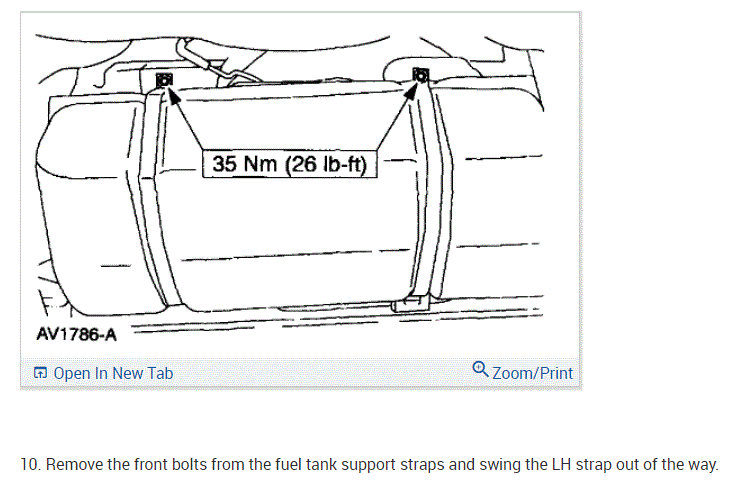

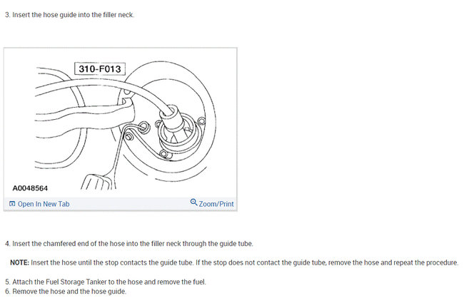

There is a guide tube that is inserted into the filler tube before running the hose in to remove the fuel. You are doing it the right way, but chances are, you aren't getting in far enough.

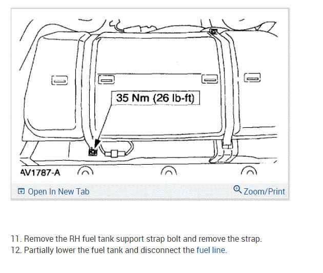

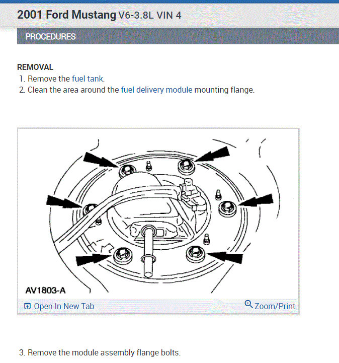

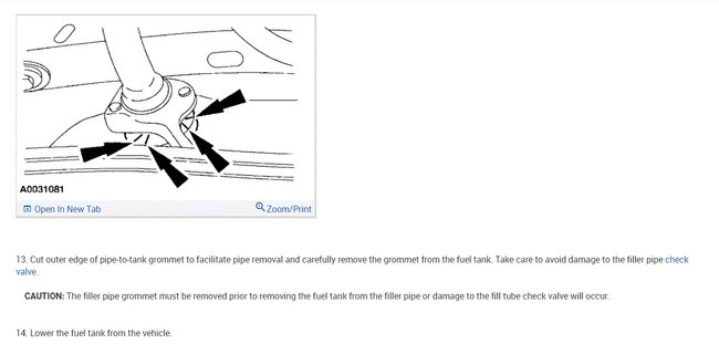

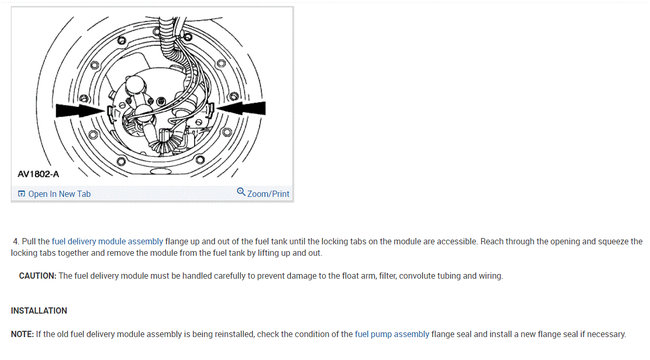

If you look at the first three pics below, they are the directions for draining the fuel tank. I don't know if you need them, but the rest of the pics are tank removal and replacement and fuel pump module removal and replacement.

If there is less than 3/4 tank, when you remove the filler tube hose from it, you will then easily be able to reach the fuel.
If you can, let me know if this helps and how things turn out for you.

Chances are it will leak. Since it is full, I'm really surprised you can't reach it. In the filler pipe, there is a check valve that should only allow fuel to enter. But once it is removed, it will leak.
If I recall, there should be a breather hose on the filler tube as well. See if you can get in through that hose.
