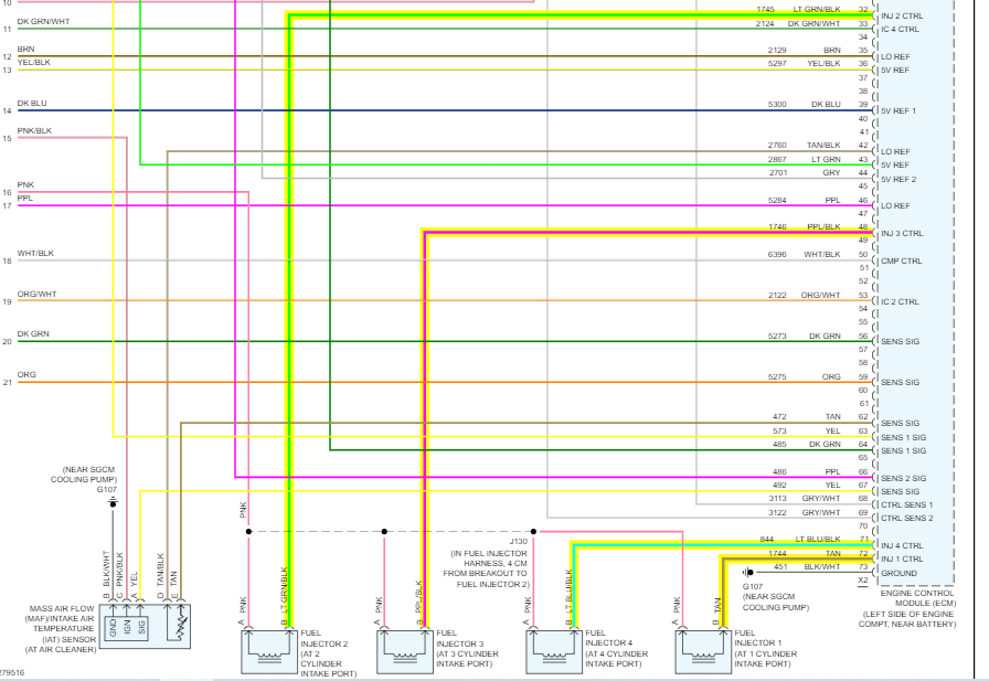

I have power for 2 injectors, but I have no ground. I checked all wires, all fuses, I even replaced the ECM but still no ground. I hooked up Noid light nothing the light don't even come on at I hooked it up to all 4 injectors connector nothing from any. I used a test light to check power side all 4 have power but no ground at all. I'm stuck please help. Thank you, what else am I missing?

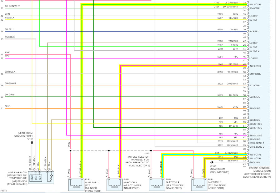

The ground path for each injector is provided by the powertrain module. If lost all grounds, there is a chance the PCM has failed or the PCM has lost ground.
Do this and let me know what happens. Connect the alligator clip side of a test light to the battery positive. Disconnect an injector and probe the ground wire with the test light. Have a helper crank the engine. The light should strobe. See if that happens.
If it doesn't, then check the PCM ground (G107). See pics below.
joe

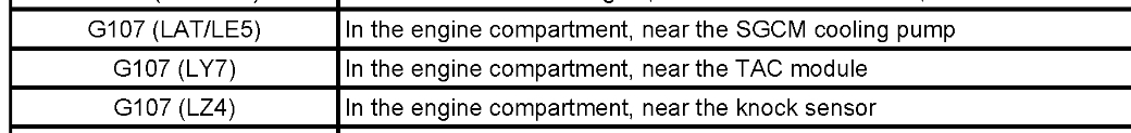

See pics below. I highlighted the ground wires for the injectors. Also, the PCM ground can be in one of three locations based on the vehicle's RPO. I attached locations below.

My apologies for late response, but I did do the light test and it didn't light up or strobe at all I found the ground location it by the knock sensor and that fine but I cleaned it and reattach it back and still nothing my I add this is a new PCM just got it in on Friday but both of them (PCM) display the same problem could it be anything to do with my pass lock anti-theft module or ignition switch just and thought. thanks again for the help.
