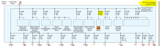

I disconnected both lines from hpfp and turned the ignition on, but nothing came out. Is there a fuse or relay for the pump?
May 9, 2023 at 2:22 AM
  • 110,240 POSTS

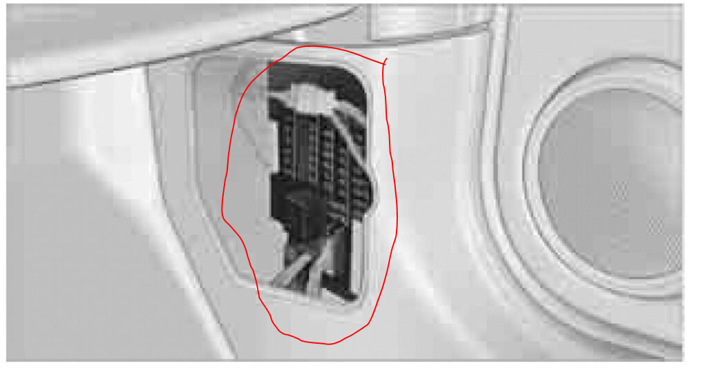

There is a fuel pump relay and fuse that need to be checked first. Both are located in the fuse box behind the right kick panel. See pic below
First, make sure the fuse is good. In addition, confirm there is power to and from the fuse when checking.
The relay is located in the same fuse box.
Here is a link that explains how to test a relay:
Let me know what you find.

I only found one fuse, #46 for the fuel, 20 amp, good on both sides. Checked rear fuel tank pump on rear passenger side under the seat. No power, only 2 grounds with ignition on, and a 3rd that gives me beeps and .2 oe .3 without stating what it is, and sometimes i touch it and it gives me nothing, maybe this is the signal wire, the 4th gives neither power nor ground. Could not see a relay, diagram in back of cover shows pictures of fuses ok ly, there is only one relay on bottom part of fuse box. Can you find out where the relay is? Has to be a relay or a fuse box issue since am not letting power. No fuel comes out of front, no sound from pump, switched it with my friend's pump and same results.

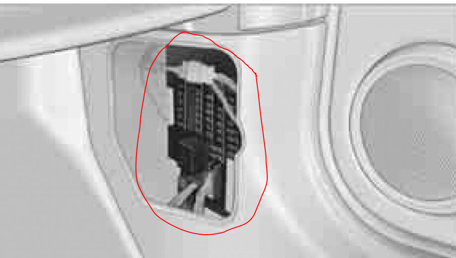

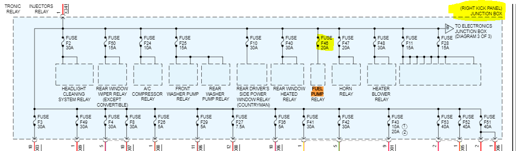

According to my manuals, but are located in the fuse box on the left side of the vehicle behind the kick panel. See pic below
Let me know if this helps.

Yes, these are built in and soldiered. I'll remove it and send it for repair.
