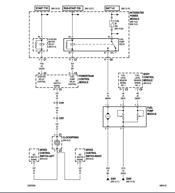

Replaced fuel pumps twice, runs two or three day then wont start and no fuel. sounds like fuel pumps running when key is on.

This could be a problem with fuse 38[20A] in the Integrated Power Module in the engine compartment of your vehicle. Here is a link describing how to check a fuse below, if needed:
In the diagrams down below I have included a wiring diagram of your vehicle's fuel pump circuit for reference as well. Please get back to us with what you find out and we can go from there.

If there was a problem with the fuse, the fuel pump would not prime. Bossman54 clearly says that he can hear the fuel pumps "running" when he turns the key. I have this exact issue and this answer was not helpful.

There's a number of problems here. First, you had better not hear the fuel pump running with the ignition switch on. To do so would create a serious fire hazard if a fuel line got ruptured in a crash. Instead, the pump will indeed run when you turn the ignition switch on, but only for one second. That is not meant for priming the pump. That's done in case fuel pressure dropped off over days or weeks. The fuel pump will not turn back on until the Engine Computer sees engine rotation, (cranking or running).
