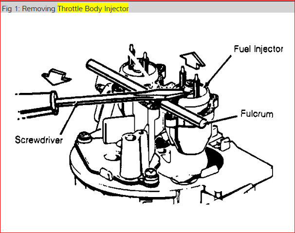

Truck running starting fine, shut it off tried to start cranks but does not start. Replaced fuel pump, fuel pump relay and fuse is good. I can prime with fuel truck starts until out of fuel again. It runs as long as I keep fuel supplied.

Just a quick question first. Have you checked the throttle body injectors for operation? The are mounted on top of the throttle body. With air cleaner assembly off you can check for their operation? With engine cranking or running you should see a small stream of gas going into the throttle body. I have attached a picture of the location. Hope this helps and feel free to ask any questions if needed. Thanks for using 2CarPros.
