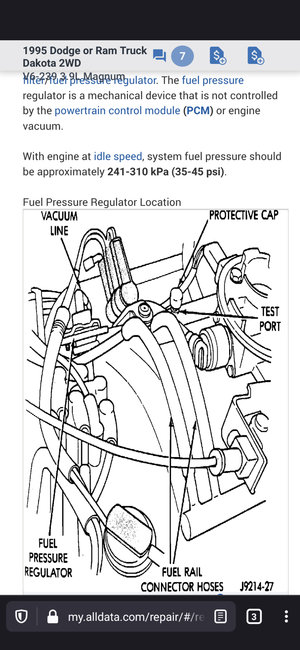

Recently replaced my fuel pump and ran great for about a month and a half shut off on me today and won't start. Will try with starting fluid and I hear pump come on as soon as I turn on key. Help please!!

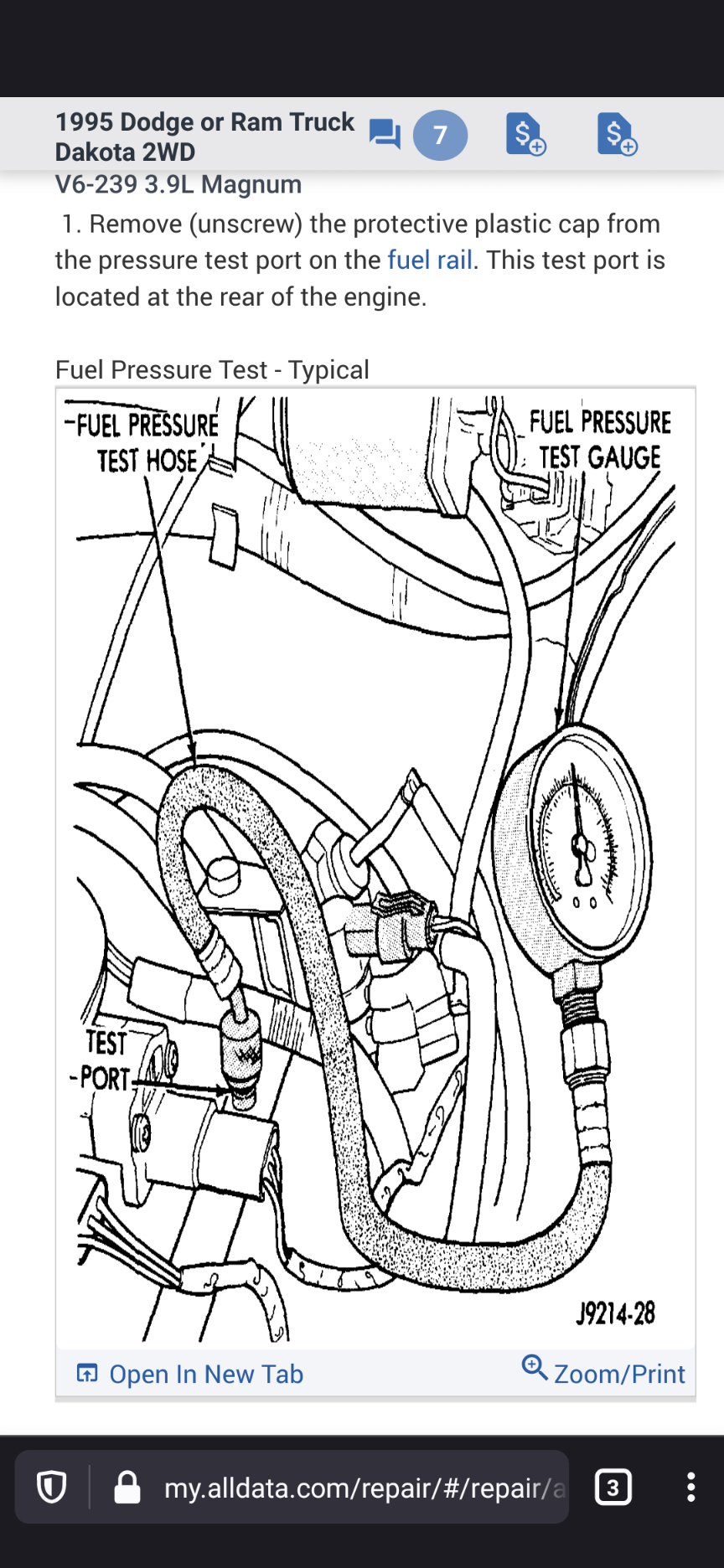

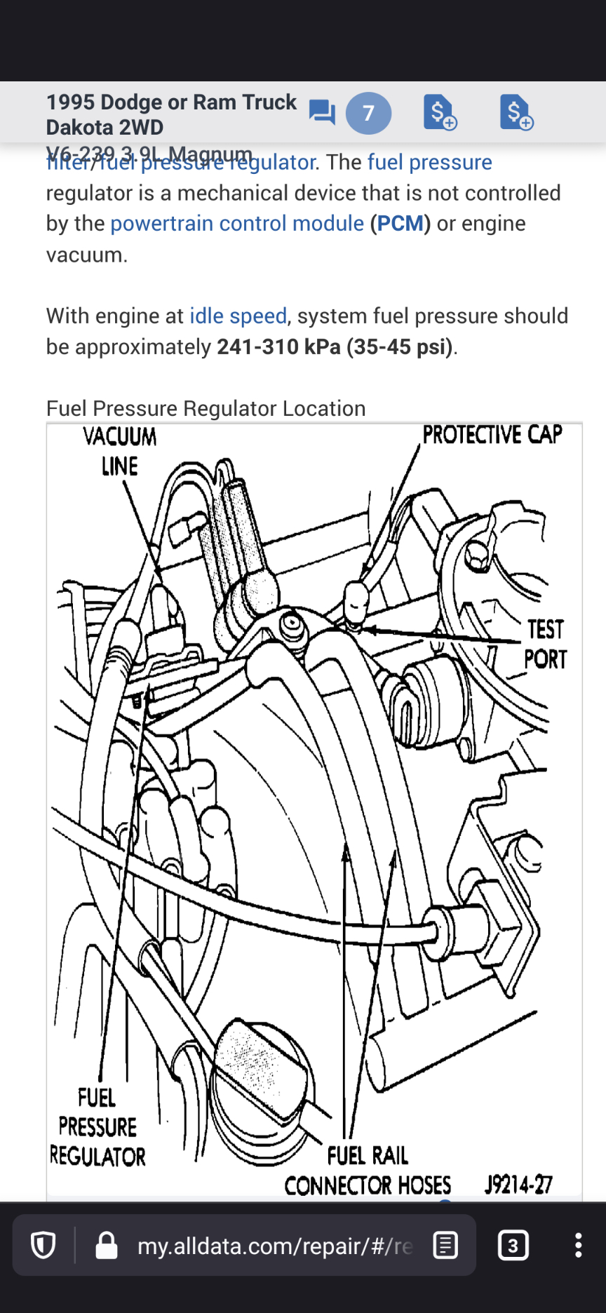

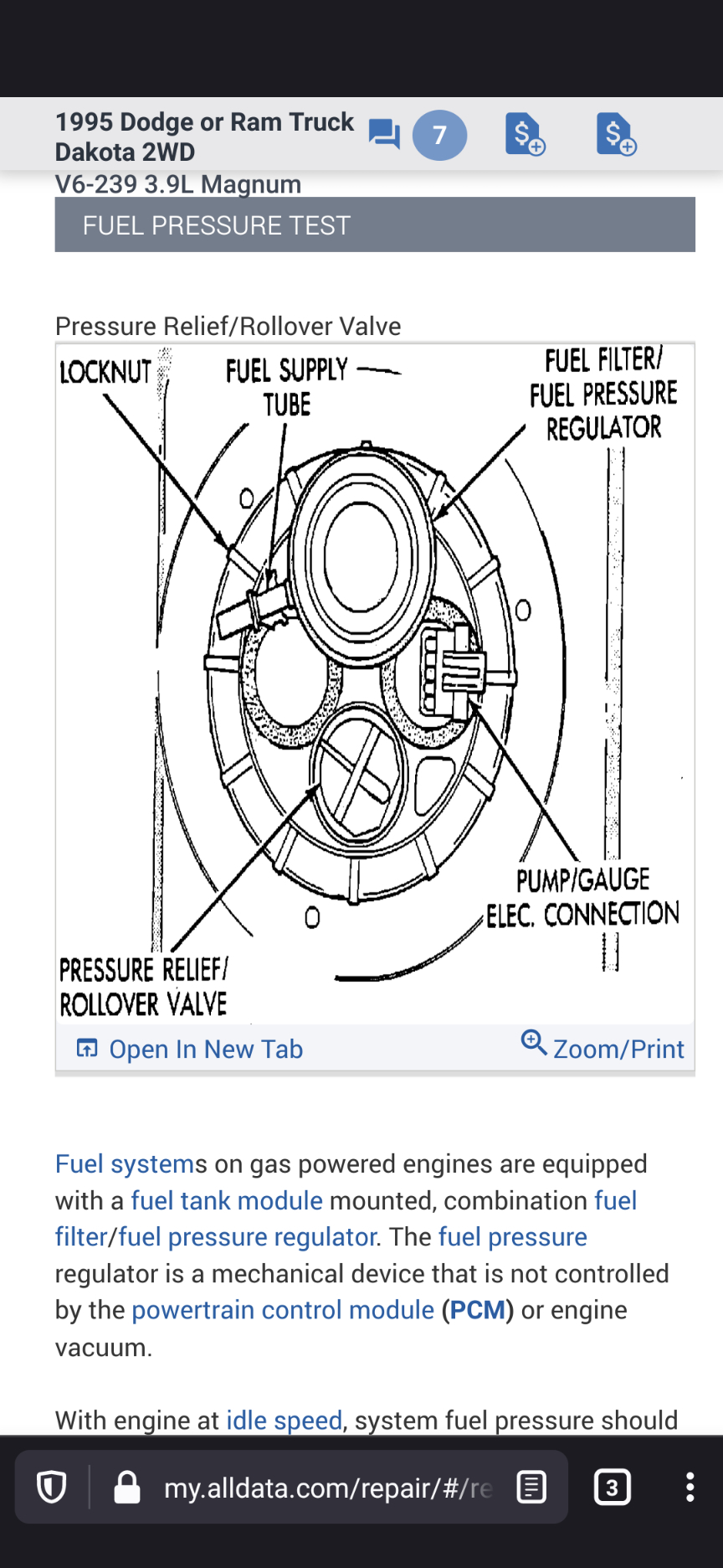

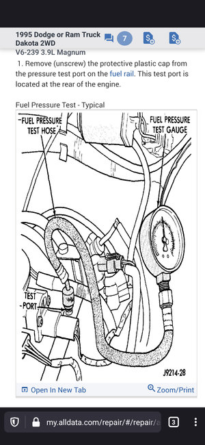

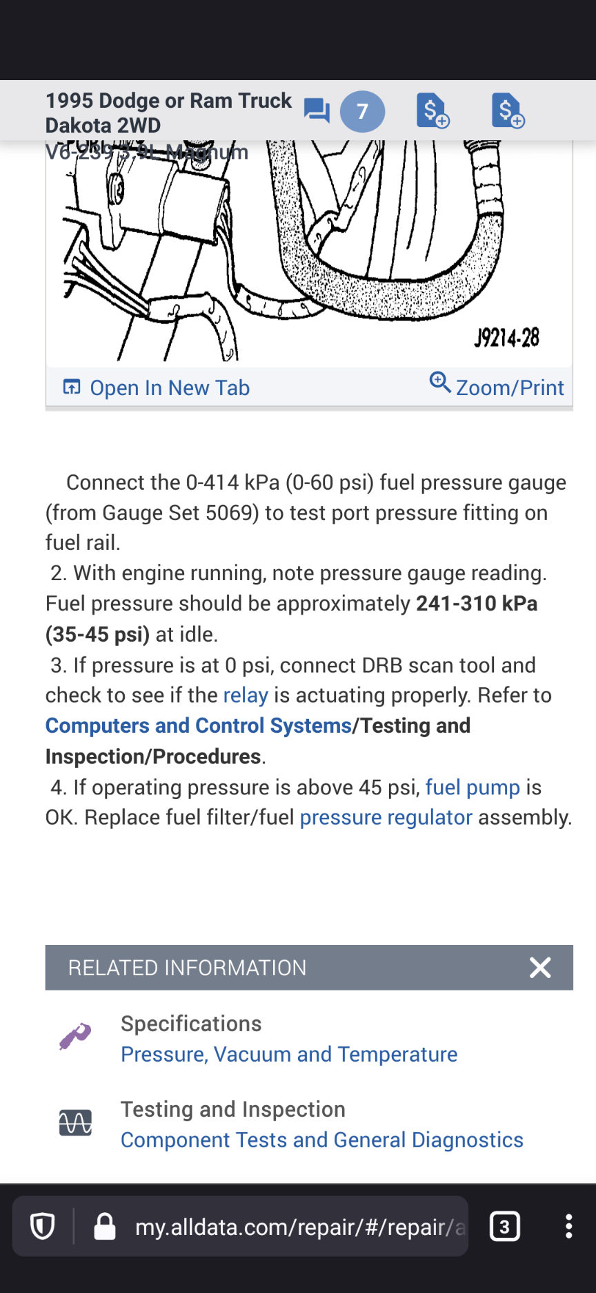

Hello. Having had bad experiences with aftermarket fuel pumps, I will say that the first thing to do would be to borrow a fuel pressure tester from the parts store and check the pressure. You'll hook that pressure gauge up to the schrader valve on the fuel rail. Turn the key on and see what pressure you get. Alldata days that you should get from 35-45 PSI with the engine running. So, you should get more than 45 PSI with the key on, engine off. If not, replace the pump again.
Here's how to do the test, generally: https://www.2carpros.com/articles/how-to-check-fuel-system-pressure-and-regulator
Also, I'm attaching screenshots of Alldatas limited information on checking the fuel pressure for this truck.
Start there and let us know what happens.
