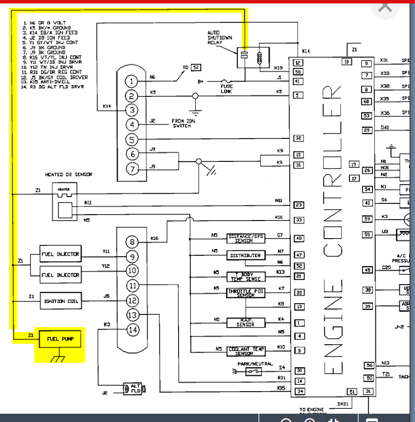

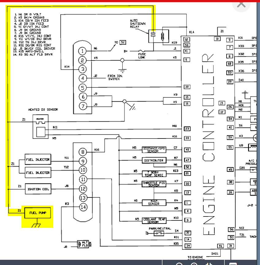

No start had fire no fuel checked fuses relays pump has been replaced no power getting to pump

This could be a couple things. First, check the ASD relay and make sure that is ok. If that is not the issue then you either have a wiring issue or an engine controller issue. Clearly follow the wiring diagram and make sure you have power coming into the ASD from the ECM. If you have it coming from the ECM and ASD then you have a wiring issue. If nothing coming out then it is the ECM.
Let me know if you have questions. Thanks
