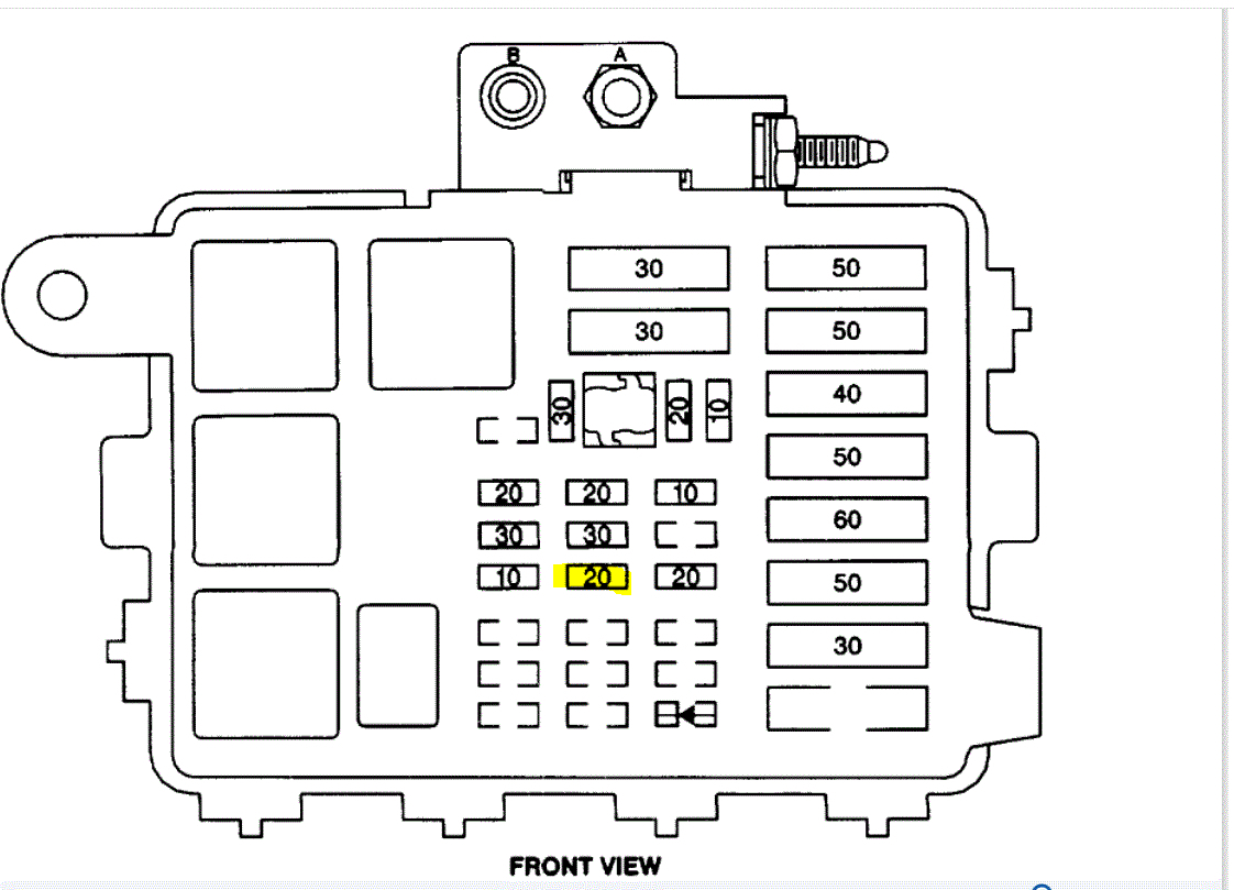

Replaced fuel pump and fuel pump relay; check all the fuses, checked grounds, and still not getting power to fuel pump. even on relay still not getting power for prime from prong 85 on the relay but when I add direct power to the pump from 87 to 30 the pump powers and sends fuel, I can hear it upper the hood but still nothing when fuse in in truck with key on.
Nov 28, 2021 at 10:14 AM
  • 110,248 POSTS

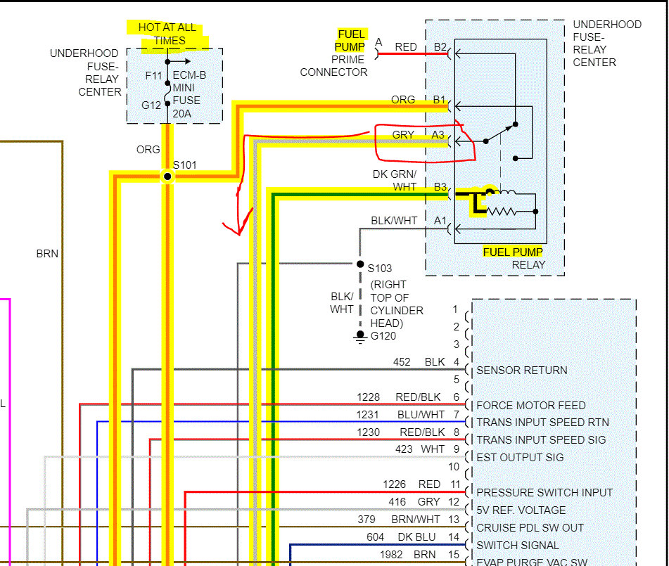

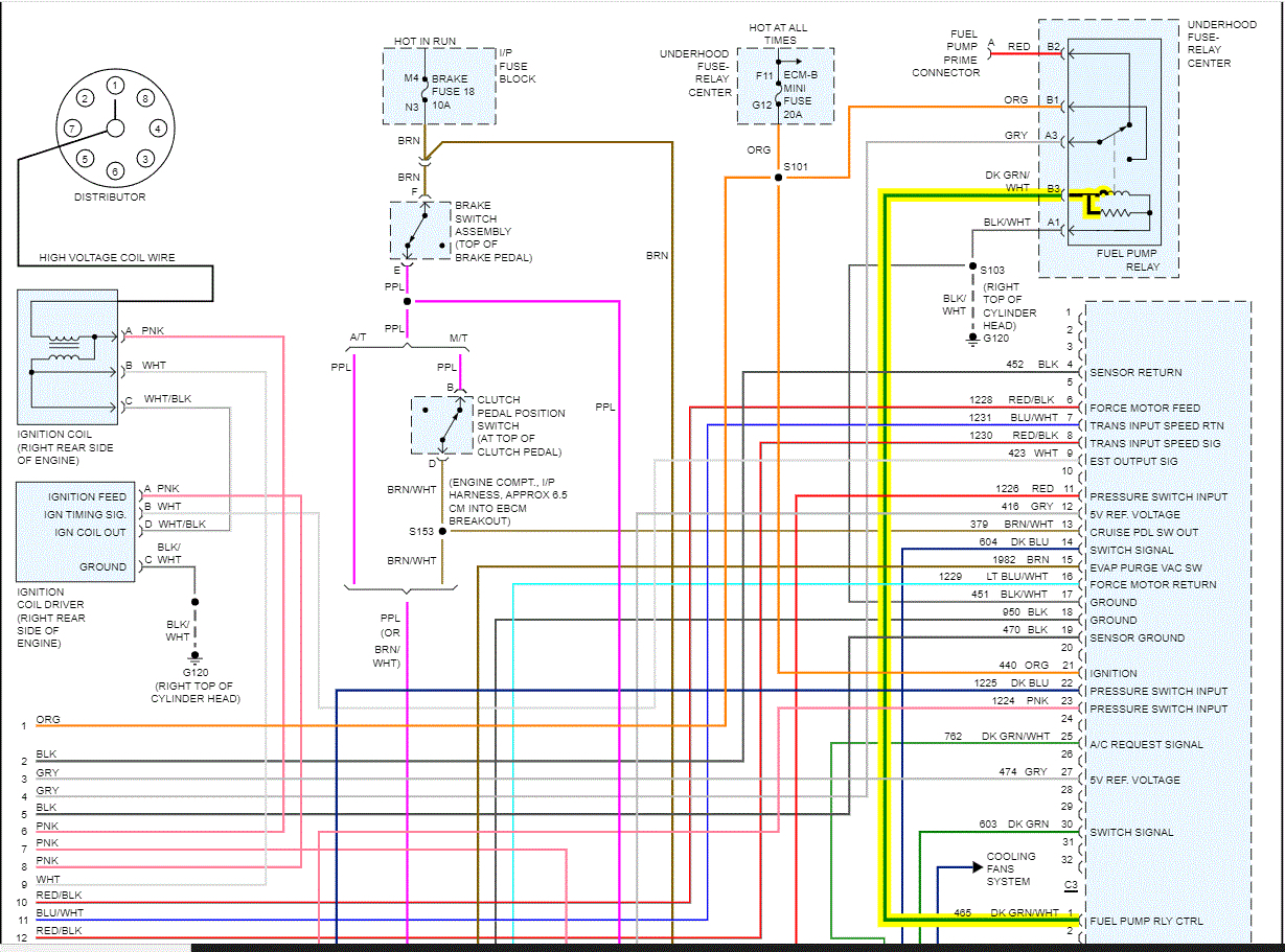

I attached a pic below showing the relay and fuse for the pump. Can you tell me which wire you are not getting power to? Is the ECM B fuse in the under-hood fuse box good and does it have power to and from it?
Let me know. Also, take a look at the attached pic and let me know what is happening there. Also, let me know if you checked for continuity to ground at the relay box.
Take care and I'll watch for your reply.

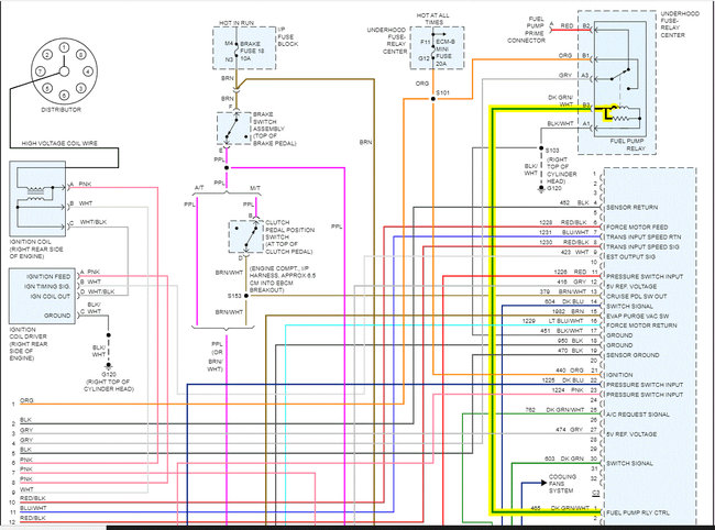

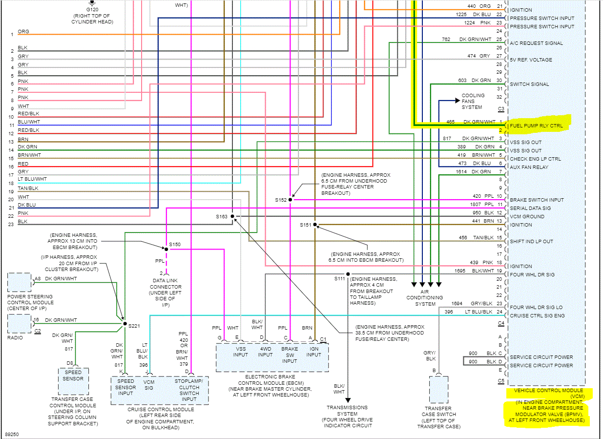

It the bottom right wire dark green with white strip prong 85 on the fuel relay switch that not getting power. I changed the ECM B fuse and still not getting power unless I put direct power from prong 30 on the relay switch to 87 and it power the fuel pump that when I hear the fuel under the hood.
Nov 29, 2021 at 3:46 AM
  • 110,248 POSTS

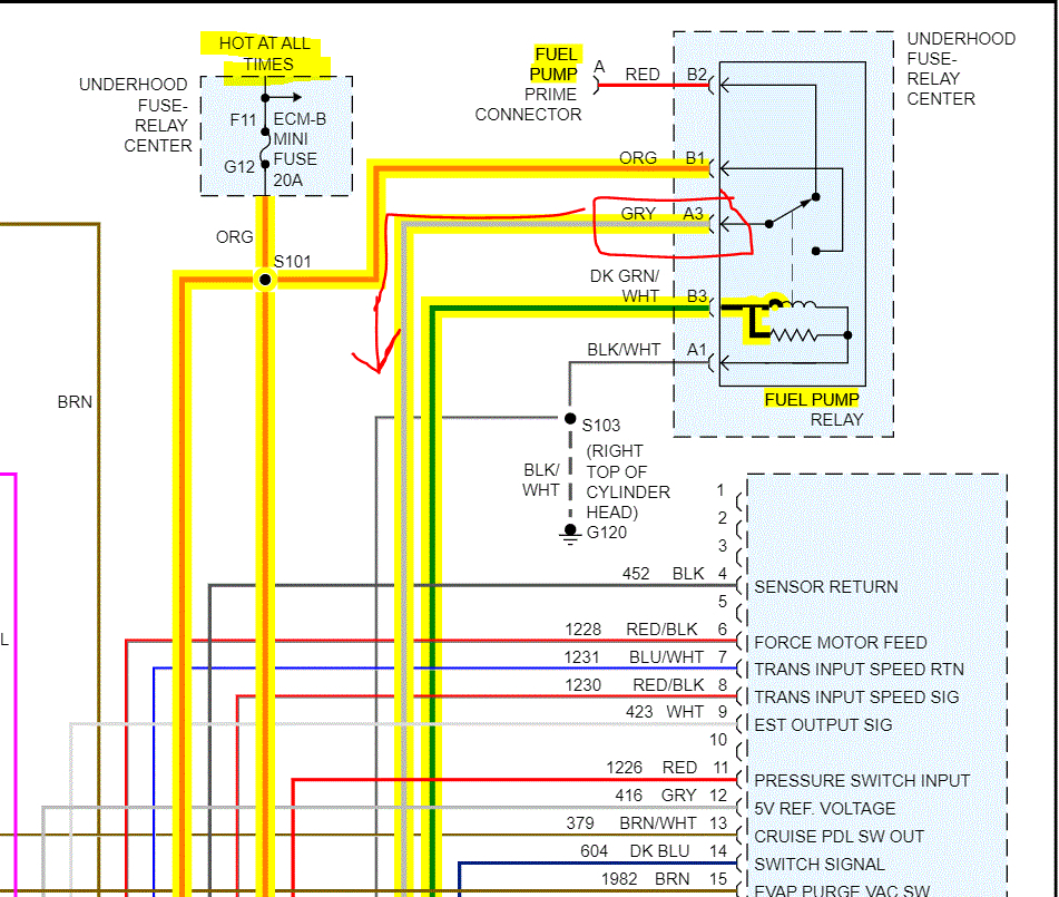

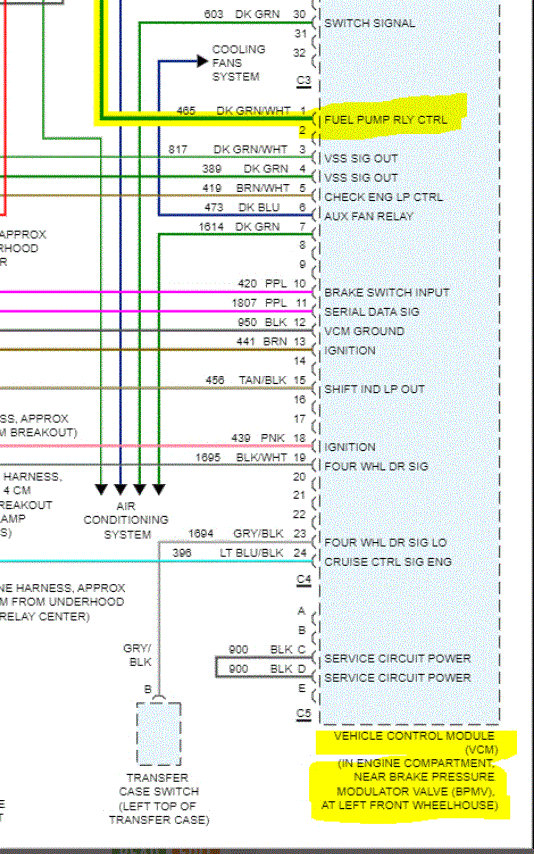

I attached the rest of the schematic. That wire comes from the VCM. Go to the VCM, disconnect the connector and inspect the pins for damage or corrosion. Also, if you don't see any problems, check for power at that pin right at the VCM. If it has power, then the green/white wire is open (broken) at some point.

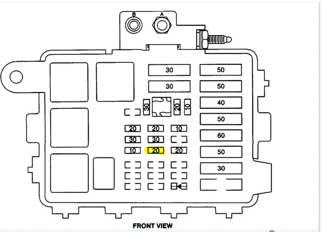

Also, check the ECM1 fuse in the under-hood fuse box. Without power to the green/white wire, the relay won't actuate.
Let me know what you find,
See pics below. Also, pic 3 shows the ECM1 fuse location in the under-hood fuse box.
Nov 29, 2021 at 9:13 AM
CHEVYFAB
  • 6 POSTS
After looking and testing and following the wire back to the ECM there no problem whatsoever with the wire or the connector to the ECM. so far, the truck only firing off when I spray starting fluid but still not starting, I check all my grounds and tested they are good. still not understanding what going on.

Are the fuses I mentioned good?
Dec 4, 2021 at 11:39 AM
CHEVYFAB
  • 6 POSTS
Yes all of them.

If you disconnect the connector at the VCM, can you check for power at the pin to the dark green/white wire? If there is nothing from the VCM, we may have an internal problem at that point.
Dec 4, 2021 at 1:24 PM
CHEVYFAB
  • 6 POSTS
I did check but what would be the best way to check that one so I know for sure?
Dec 4, 2021 at 1:26 PM
  • 110,248 POSTS
If there is no power at the VCM, it's most likely bad. There really is no specific test at this point other than taking it apart and inspecting the circuit boards.
