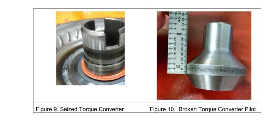

Drove vehicle stopped at a stop light when i wanted to drive again no forward or reverse gears. Had to tow it in.

Yes, checked fluid level and fluid nice and clean no smell to it .Checked connections to motors (I think it is motors) nice and clean.

Sorry guys it's a diesel tiptronic?

A common issue with these that I have found is the torque converter hub. The torque converter seizes and breaks the hub. That will give you no forward or reverse.

Thank you makes sense. can hear something engage when i put it in gear. I appreciate your help.Will pull gearbox and let you guys know what i found.
