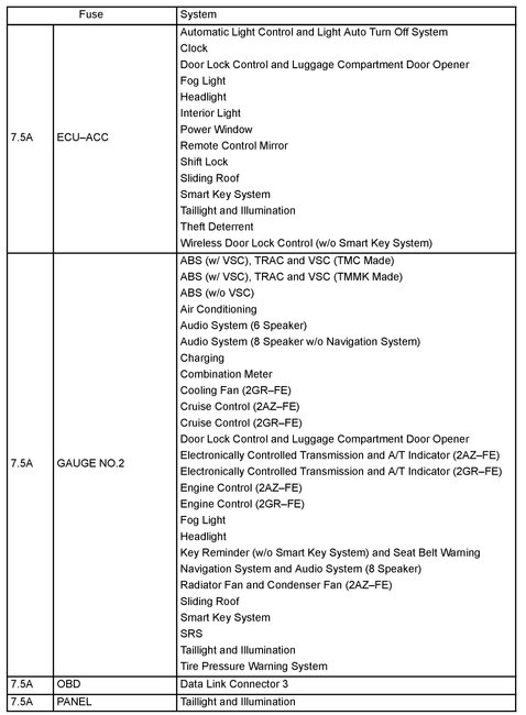

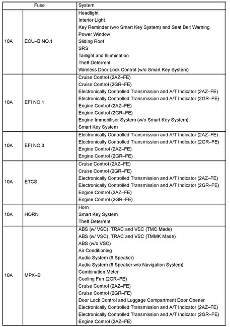

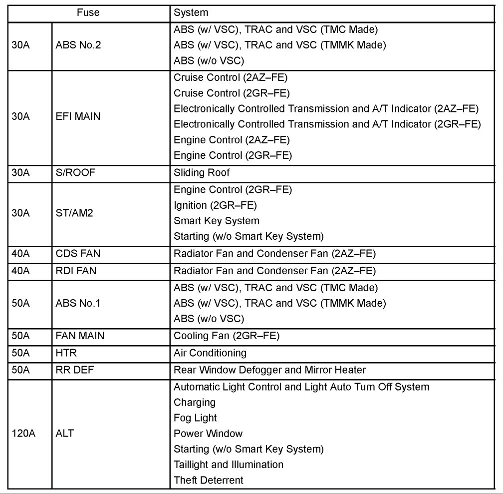

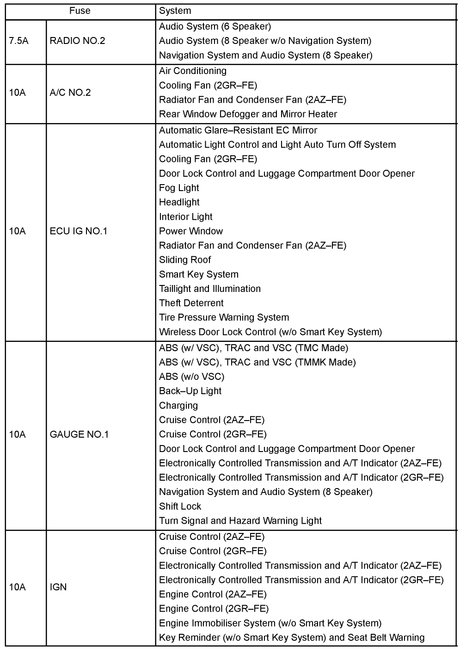

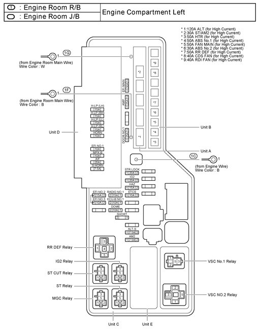

do this car just have only one fuse box it don't have one inside the car do a fuse work the fuel pump or do it show a fuel pump fuel?
Oct 19, 2016 at 4:45 AM
JIS001
  • 3,412 POSTS

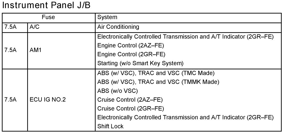

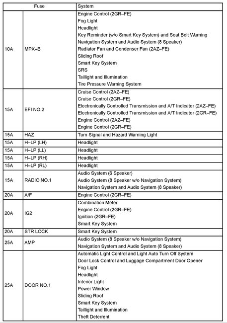

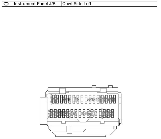

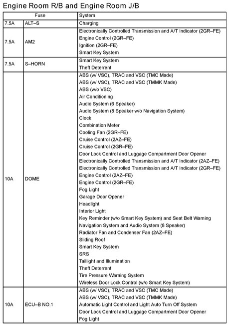

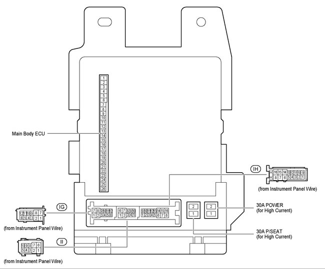

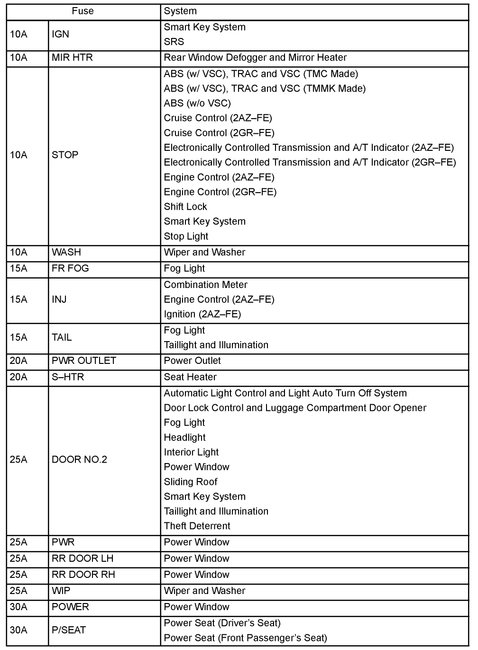

Anything with ignition or fuel will be in the engine compartment. Fuses inside the vehicle will be for body like illumination, radio, sunroof, etc... But here are some images.
Oct 19, 2016 at 4:59 AM
JIS001
  • 3,412 POSTS
Pay close attention to the EFI main fuse. That is what powers up the computer.
