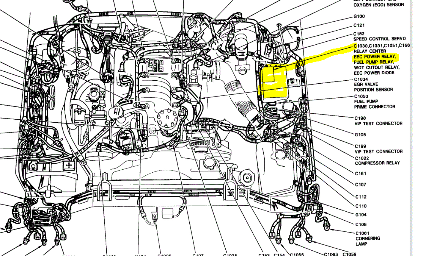

No fire to the spark plugs?
150,000 MILES • 3.0L • V8 • TURBO • 2WD • AUTOMATIC
JESSE ME
Turns over good, not getting any fire to the spark plugs. Fuses are good.
Dec 21, 2021 at 12:21 PM
  • 110,248 POSTS
By chance, do you notice if the fuel pump turns on for a couple of seconds? If it doesn't, I need you to inspect the EEC relay in the under-hood fuse box. See pic 1 for box location.
If there is a relay having the same part number, switch them to see if it starts. If there isn't, here is a link that shows how to test one.

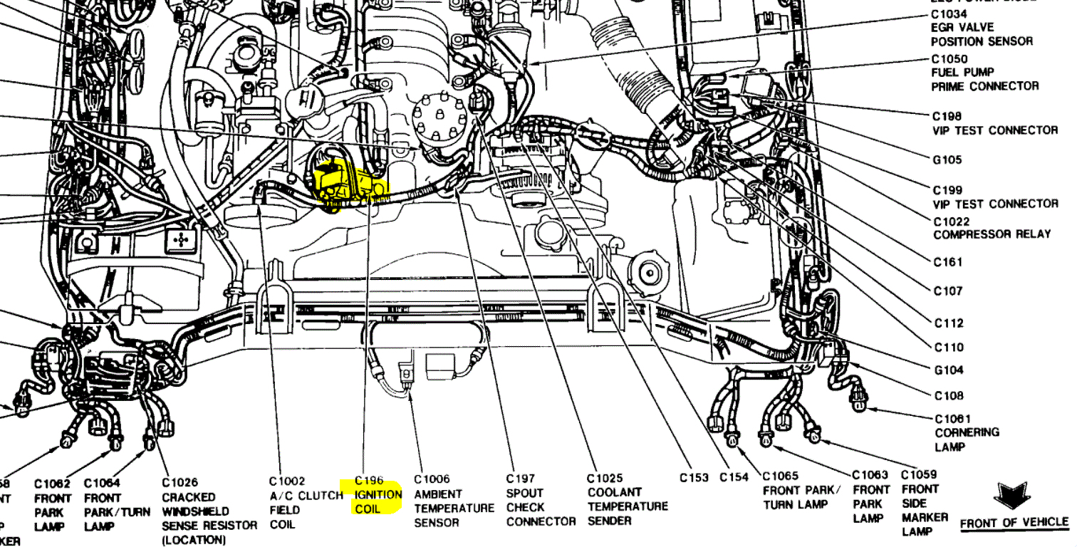

If that is good, locate the ignition coil (see pic) and there will be two wires going to it. One should have power when the key is in the on or start position. The other will be ground. Check to see if there is power present.
If that isn't a problem, then we need to check for diagnostic trouble codes. This vehicle has an obd1 system which doesn't require a scanner to retrieve codes. You will need a test light. Follow the directions in this link:
https://www.2carpros.com/articles/ford-lincoln-mercury-obd1-1995-and-earlier-diagnostic-trouble-code-definition-and-retrieval
