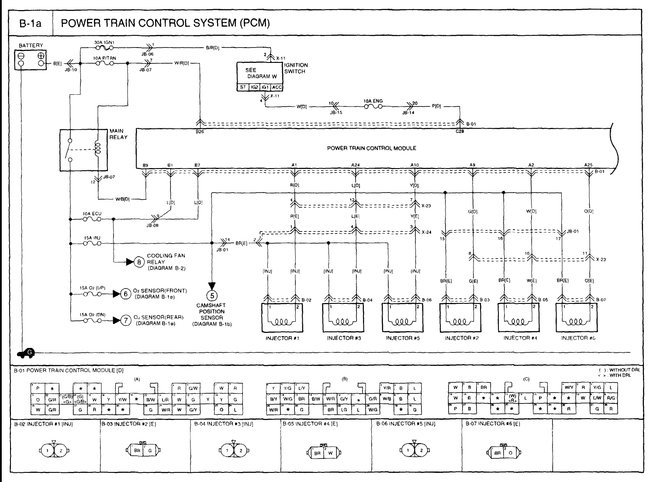

My car cut off on me while I was driving it and would not start backup. The code came up to be a crankshaft position sensor so I changed that an the camshaft sensor too. It turns over but wont start the timing is good, but I am not getting fire to the spark plugs. Got another reading code p0343 charge up battery still no fire to the spark plugs. change computer with the same numbers still getting same reading p0343 true, but wont start. I am not getting power from somewhere. can someone help me with this?

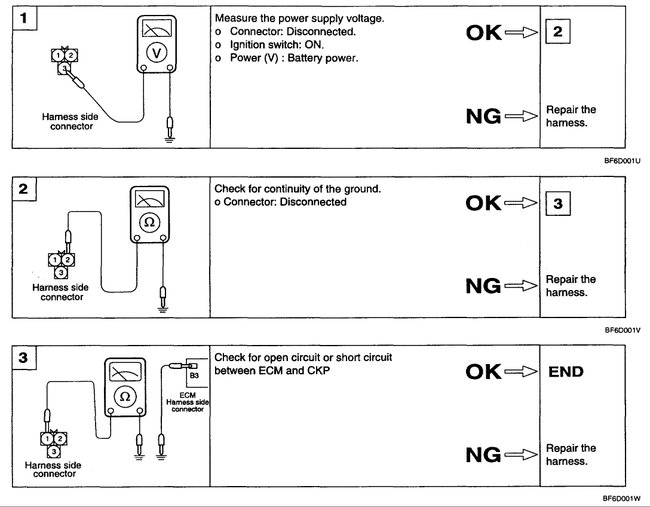

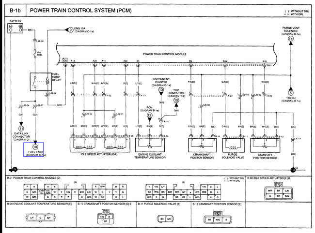

Attached the wiring diagram. Verify you have battery power to pin #3 Brown wire of your crank sensor with key on. If no power then check all your fuses. The 15A fuse with designation INJ is what feeds the power. If ok check wire at pin#1 Yellow with green stripe to the computer connector B pin#5 diagram shows what it looks like. Measure resistance. Should be just under 1 ohm. If no resistance then you need to trace for an open circuit. Also check that wire for a short to ground and power by back probing pin #1 on crank sensor connector and other lead touching the battery ground and battery positive terminals. Make sure ECM connector is unplugged while doing this. Then check pin #2 which is black. Chcek it to the negative terminal on battery or chassis ground. If just under 1 ohm your good. No resistance then look for an open in the wire.
If all your checks are good then I would recommend you replace the crank sensor with a better quality sensor. It is possible to remove without removing the belt. Loosen the tensioner and pivot the roller away from the sensor to access the bolt. Let us know how the checks go.
Oct 31, 2016 at 11:01 AM
JIS001
  • 3,412 POSTS
Forgot to mention when doing the check to battery terminals there should be no reading. If there is then you have a short somewhere in that circuit.
