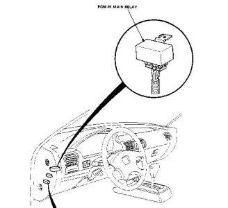

Could be a bad PGM-FI relay (main relay). This is pretty common issue. Its located behind the dash and tucked high up. You can access it by just unbolting the computer you see underneath and moving it to the side. I will attach an image.
