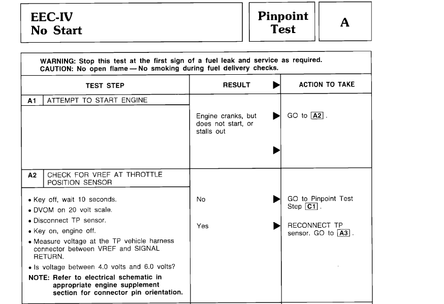

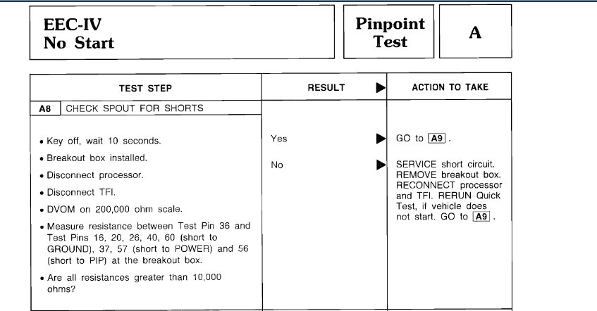

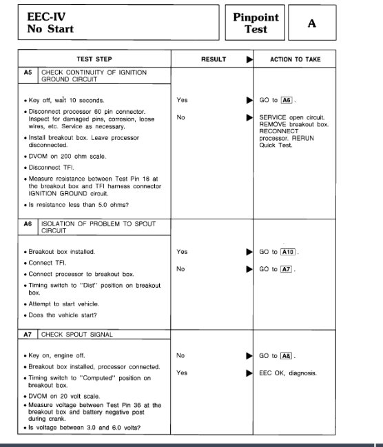

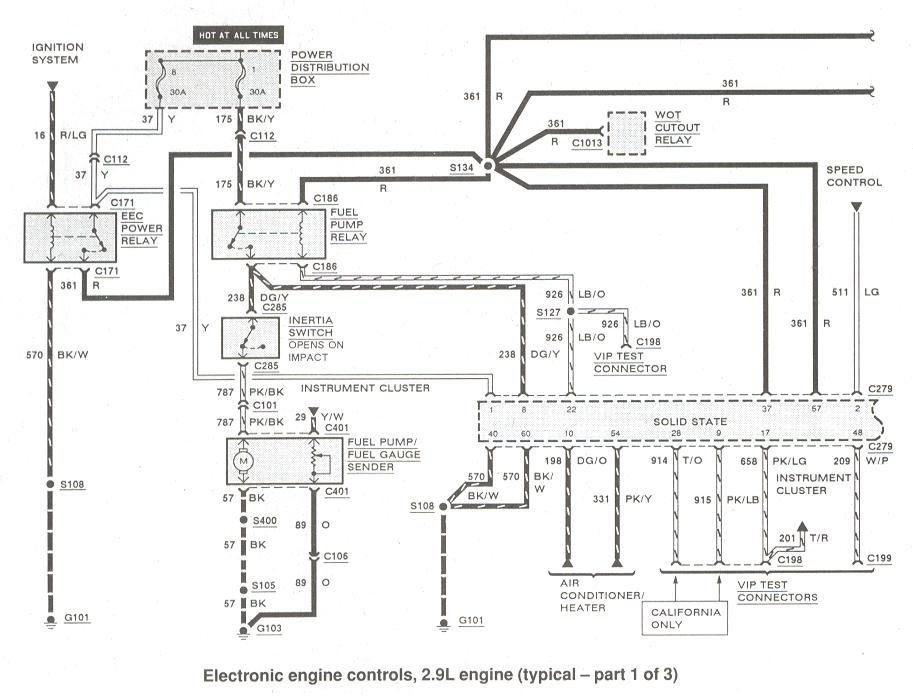

I changed coil cap and rotor ignition mod on back of distributor, now not getting power to fuel pumps and computer. please help.
Oct 14, 2019 at 12:06 PM
SCGRANTURISMO
  • 4,897 POSTS

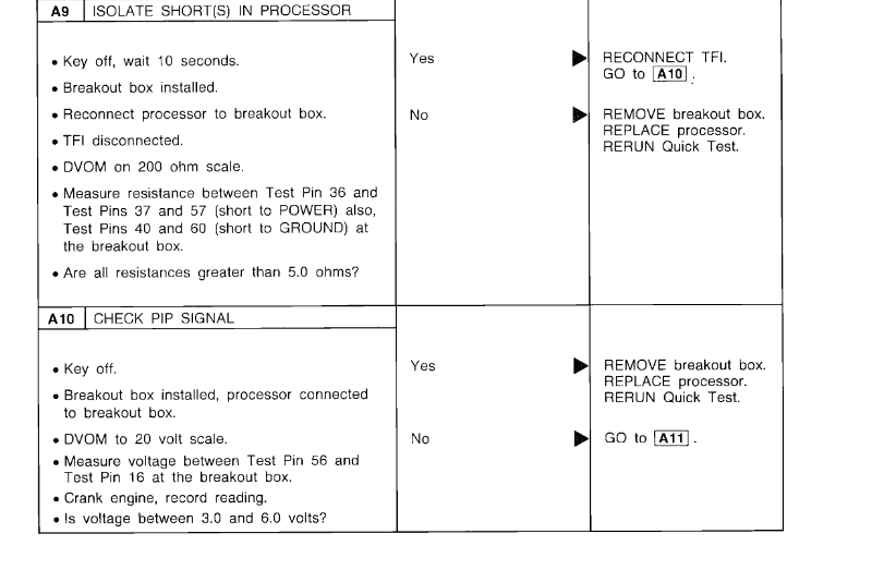

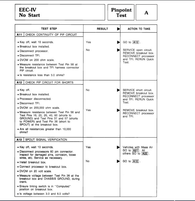

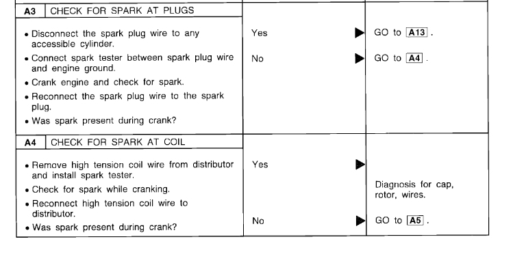

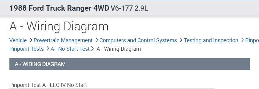

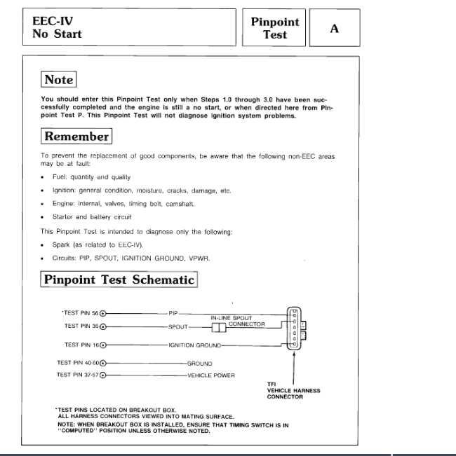

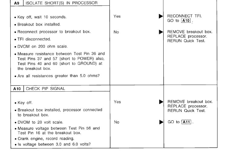

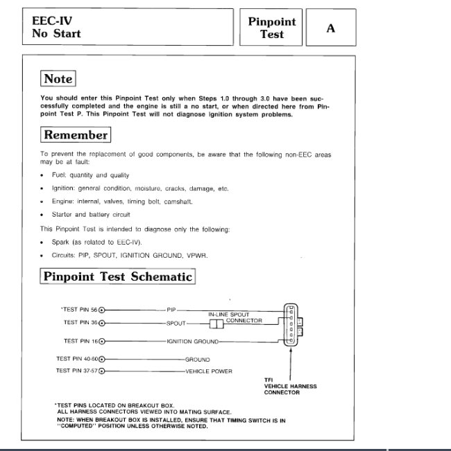

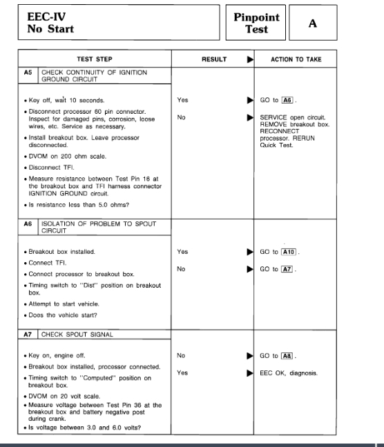

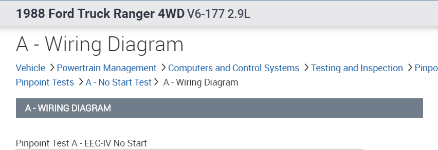

In the diagrams down below I have included the No Start Pinpoint est for your vehicle. It calls for the use of a breakout box which goes in line in between the Power-train Control Module [PCM] and the PCM connector and should be available for purchase on eBay and Amazon. Please go through these guides and get back to us with what you are able to find out.
Thanks,
Alex
2CarPros
Oct 14, 2019 at 7:02 PM

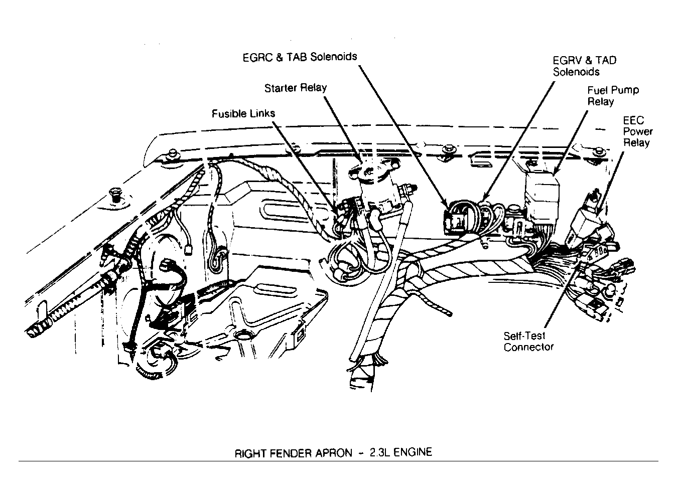

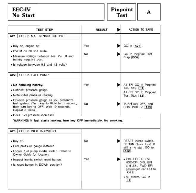

Hello just to add, the EEC relay feeds power to the fuel pump relay and many other components. Check these relays for power.
