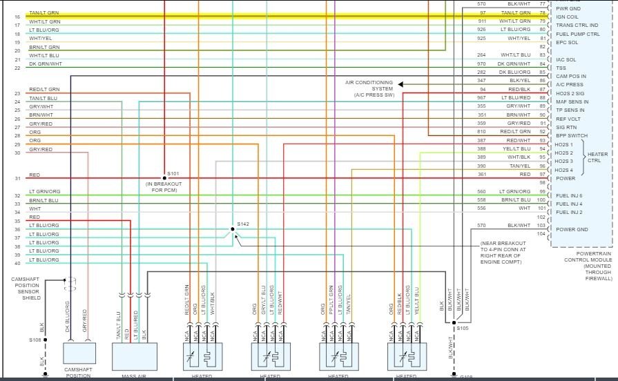

Good evening,

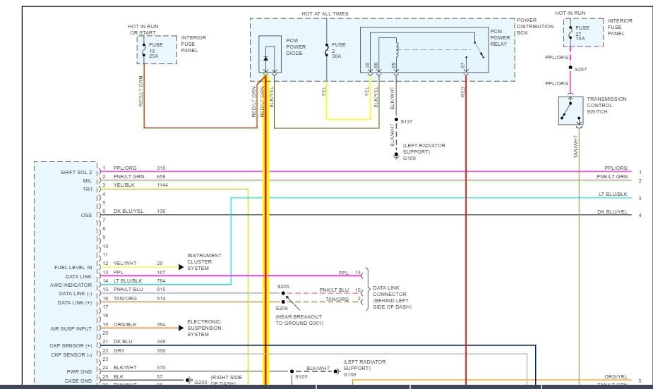

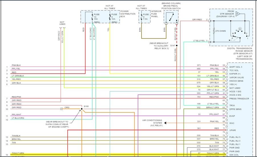

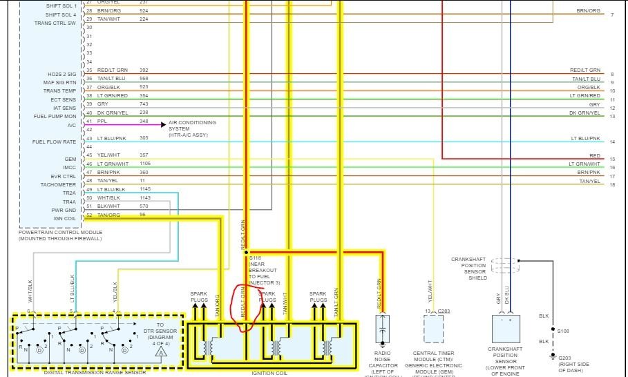

I attached a wiring diagram for you to view. Check the wire I circled for power with the key on for the coil. There fuse in the first picture is what controls the power.
Check for power to the coil at the wire I circled.
Let me know the results and we can continue.
