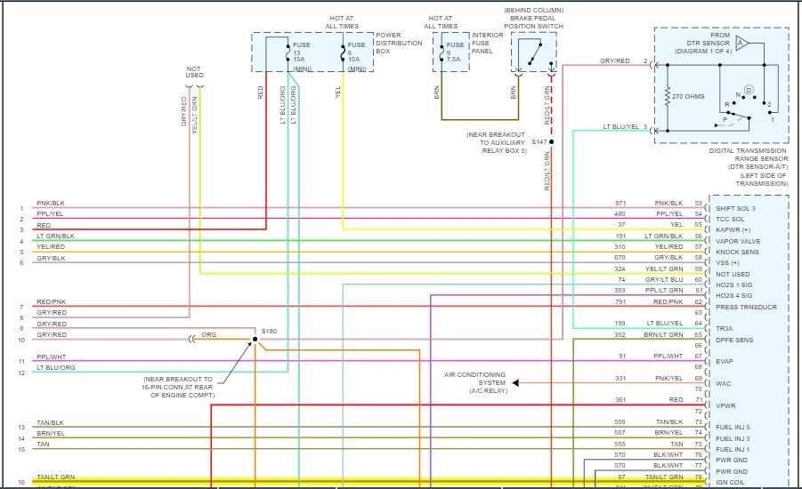

No fire to spark plugs
1998 FORD EXPLORER SPORT TRAC
167,000 MILES • 4.0L • 6 CYL • 4WD • AUTOMATIC
BIGED2021
  • 22 POSTS
Coils are good.
Battery is good.
Fuel pressure is good.
Why am I not getting fire to the plugs?
Oct 20, 2021 at 2:30 AM
Good evening,

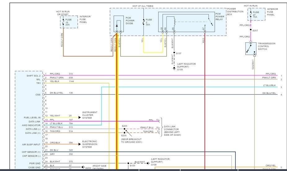

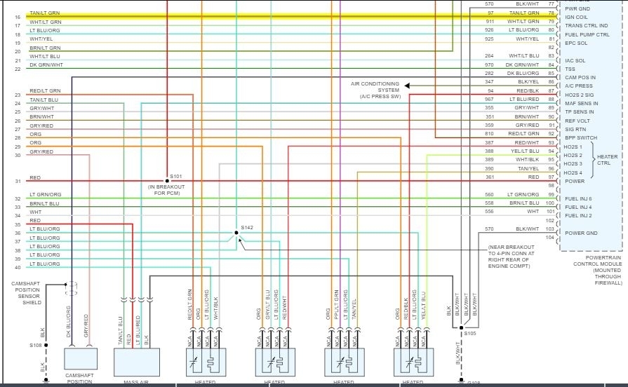

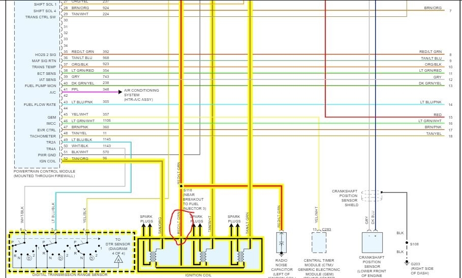

I attached a wiring diagram for you to view. Check the wire I circled for power with the key on for the coil. There fuse in the first picture is what controls the power.
Check for power to the coil at the wire I circled.
Let me know the results and we can continue.
