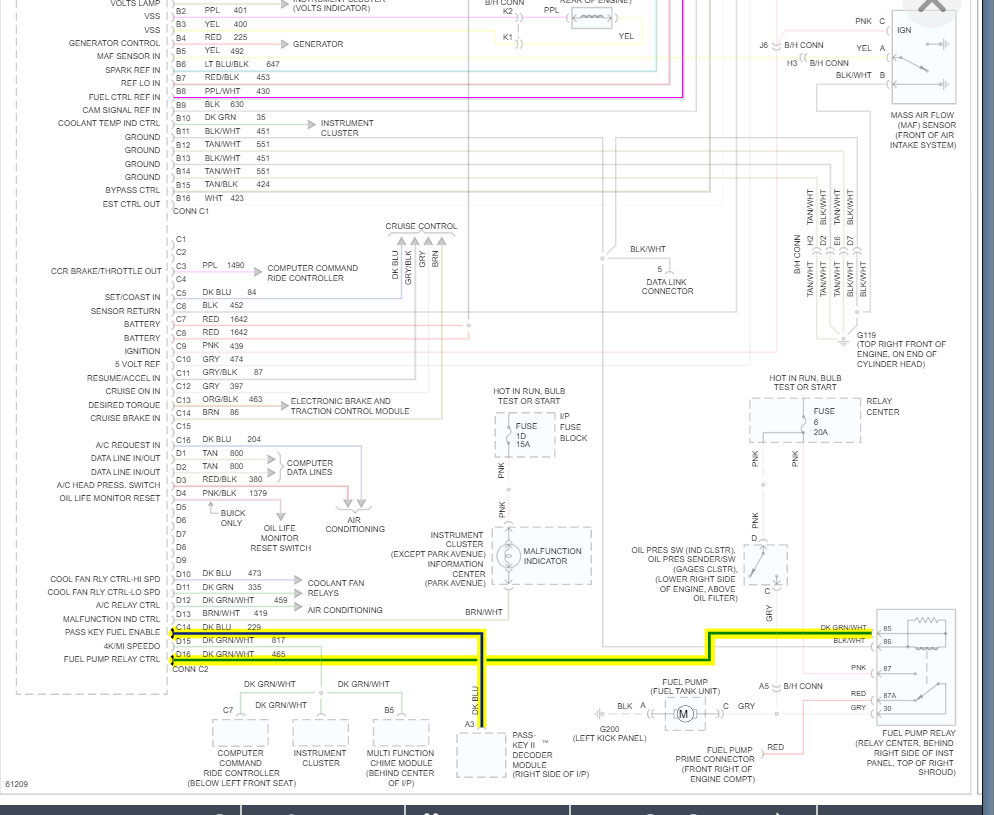

The car was running after replacing the fuel pump. It is not getting any gas to the engine and has no fire.
Mar 14, 2022 at 11:52 AM
What we have to start with is finding out if we are getting power to the fuel pump relay.
Basically, we need to check the voltage on the highlighted wire to the relay and find out if the relay is being turned on.
If not, then we could have a pass key issue if you have no spark or fuel.
So, we need to start with this info and that will help determine what the next steps are.
Please see the wiring diagram below and let us know what happens with this info.
