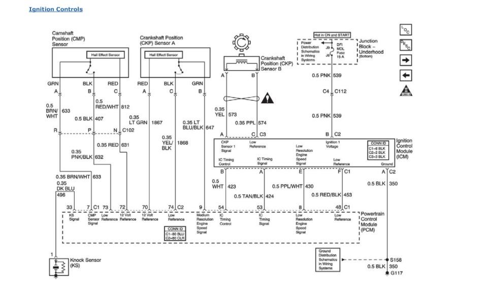

Working on 1994 Impala. I replaced crank sensor behind the harmonic balancer, replaced camshaft sensor, ignition module is good, still no fire.

You first say 1994 and then the post says 2004? Please verify.
When you crank the engine, does the tachometer move up a small amount while cranking?
Below is a description of the system operation. My first thought is a possible ignition module failure which is very common. You can remove it and have it tested at a parts store for free.
I attached a wire diagram as well. Check the fuse listed for power on both sides with the key in the on position.
ELECTRONIC IGNITION (EI) SYSTEM DESCRIPTION
The electronic ignition (EI) system produces controls a high energy secondary spark. This spark is used to ignite the compressed air/fuel mixture at precisely the correct time. This provides optimal performance, fuel economy, and control of exhaust emissions. This ignition system uses one coil for each pair of cylinders. Companion cylinders are a pair of cylinders that are at top dead center (TDC) at the same time. The cylinder that is at TDC of the compression stroke is called the event cylinder. The cylinder that is at TDC of the cylinder exhaust stroke is called the waste cylinder. When the coil is triggered both companion cylinder spark plugs fire at the same time, completing a series circuit. Because the lower pressure inside the waste cylinder offers very little resistance, the event cylinder uses most of the available voltage to produce a very high energy spark. This is known as waste spark ignition.

Okay, it is a 2004 Impala with the 3.4 in it. Ignition module test good I replaced the cam sensor and the crank sensor still no fire. Any help would be greatly appreciated. Thanks
