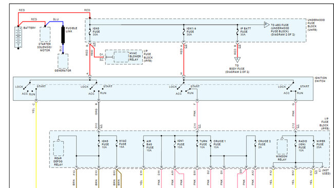

I have wires hanging from ignition just need to no pin locations for all of them 6 wires 2 reds orange brown pink yellow

Sure, here is the wiring diagrams for the ignition switch. Check out the images (below). Let us know if you need anything else.
Image (Click to enlarge)
