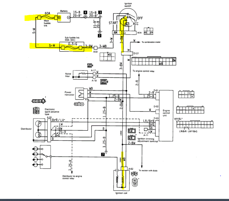

I have another problem with this little truck. I tried to start the engine and it would not start. I checked for fire at the plugs and wasn't getting any. I checked for fire at the high tension from coil and wasn't getting any, I then checked for voltage to the coil and wasn't reading any. I had my son to turn starter over and checked for voltage, none. This truck listed above is a Power Ram 50, four cylinder 4G64 Mitsubishi engine. I recently rebuilt engine. Can you help with this problem? Thanks, Donn1

Take a look at the wiring schematic I attached. I'm seeing a black/white wire going to the coil. That should have power with the key on or in the start position. Is that the one you don't get power from? I also highlighted two fusible links, but don't feel they are an issue if it is cranking.
If you have no power to the black/white wire, you need to check for power out at the switch itself. If there is power, then we have an open circuit between the two. If there is no power, chances are the switch has failed.
Check these things and let me know what you find.
Dec 12, 2020 at 1:38 PM
DONN-1
  • 24 POSTS
Hi, I tested the black/white wire, it read 12.7 volts, with switch turned on. I then had my son turn over the engine while I held the high tension wire from the coil to close to ground, no fire. What should I try now?, thanks, Donn1

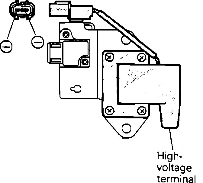

If there is power to the coil, we need to check the coil itself.
Here are the directions to test it. The attached pic correlates with the directions.
_______
1991 Dodge or Ram Truck D50/Ram 50 L4-2350cc 2.4L SOHC
Test 8 - Ignition Coil Testing
Vehicle Powertrain Management Computers and Control Systems Testing and Inspection Symptom Related Diagnostic Procedures No Start Test Ignition Tests Test 8 - Ignition Coil Testing
TEST 8 - IGNITION COIL TESTING
Ignition Coil
See pic 1
TESTING OF IGNITION COIL
1. Measure the resistance between the positive terminal and negative terminal of the ignition coil.
Standard value: 0.72 - 0.88 ohm
2. Measure the resistance between the ignition coil's positive terminal and the high-voltage terminal.
Standard value: 10.3 - 13.9 k-ohm
3.If either primary or secondary resistance is out of specification replace coil and retest.
4.If all test are within specifications, check power transistor.
__________________________
Let me know what you find.

hello, I'm sorry for not responding sooner. the weather here has not been good. I took the coil off the truck and tried to measure the primary coil resistance, the cheap ohm meter I used wasn't stable. I had better luck measuring the high voltage resistance, it was between 10.3 - 13.9K. But without the former resistance measurement, I don't trust the coil. The power transistor is what triggers the firing of the coil doesn't it? If I unplug the plug from the power transistor and jump 1.5vdc plus to #1 and jump wire #2 and #3 to coil + and negative shouldn't the coil fire? I'm thinking #1 and 2 pins of the transistor activates the transistor switching. Pin #2 and #3 provide the ground to fire the coil. Or hook positive to coil and momentary touch to ground, won't this cause coil to fire? Power transistor un-plugged. What do you think? Thanks, Donn1
Dec 15, 2020 at 10:07 AM
  • 110,240 POSTS
Make sure the transistor is disconnected and see if it works.
Dec 16, 2020 at 5:43 AM

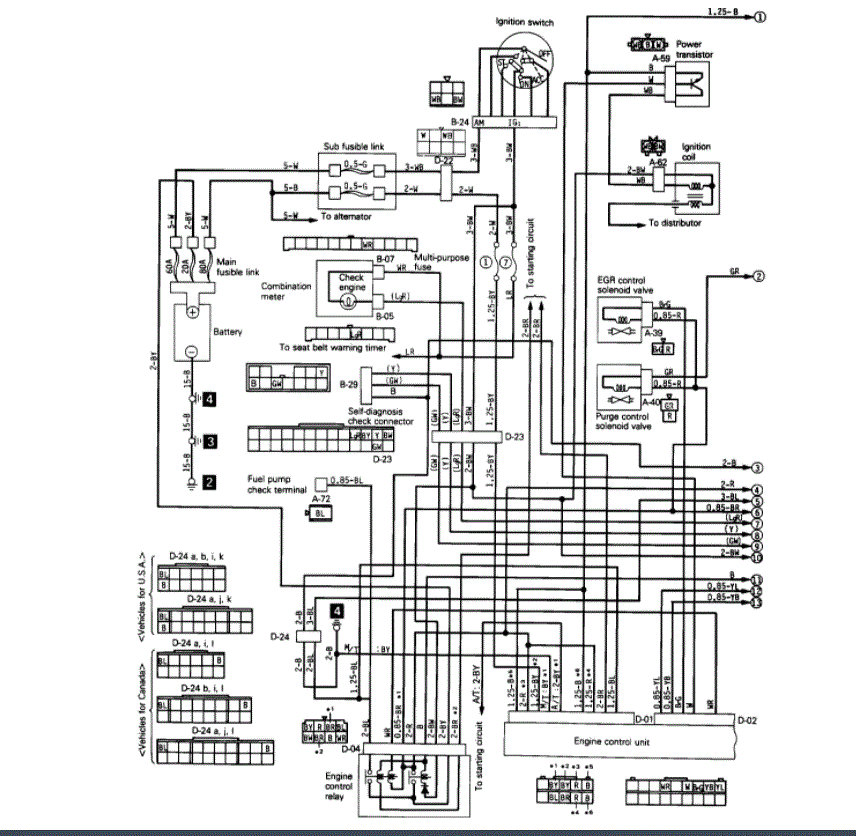

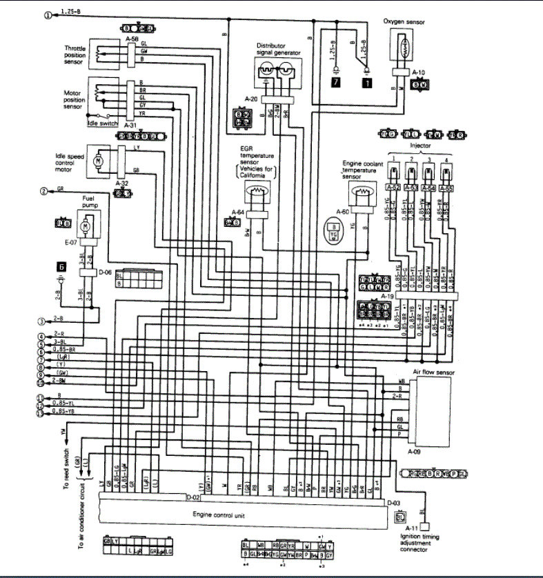

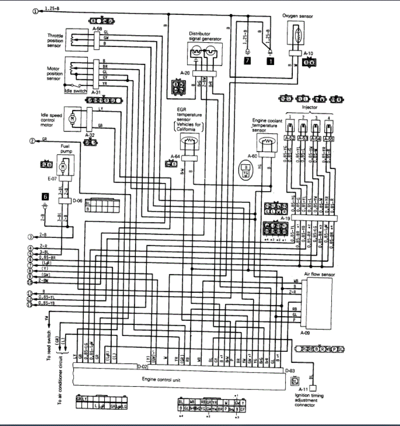

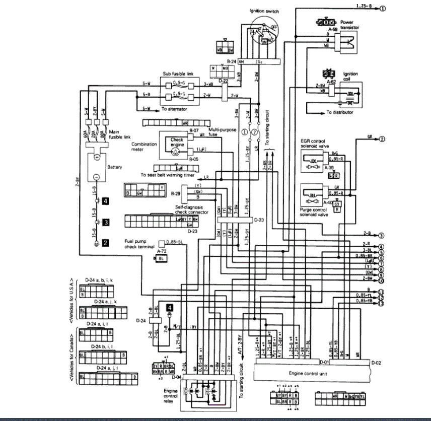

Hi, I got the new coil in for the Dodge power ram 50 4.2 truck, it didn't help though. Do you know which wire goes where, in the distribuitor? there are 4 wires, red,black,yellow, white. thanks
Jan 19, 2021 at 10:15 AM
  • 110,240 POSTS
I attached what I have as far as powertrain management schematics. Take a look and let me know if they help.
