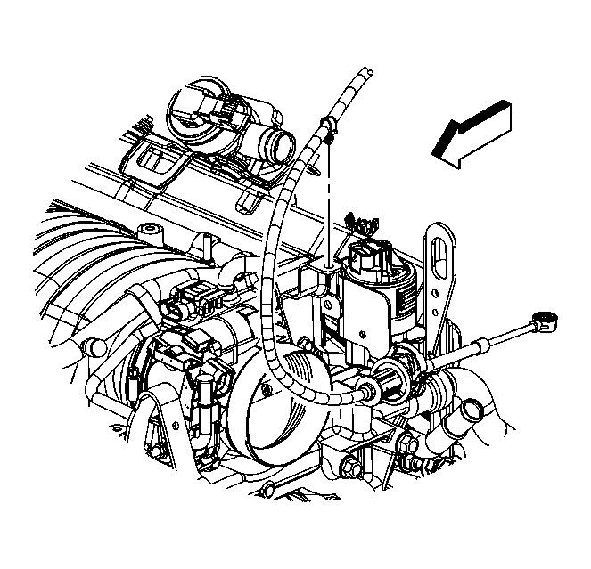

I can smell gas after a couple times cranking. I do not know where the throttle body is but have 55 psi on fuel rail.
Jan 21, 2018 at 2:37 AM
PATENTED_REPAIR_PRO
  • 1,853 POSTS
It is at the front of the intake manifold, shown in this diagram with a large round opening. You may have to remove the air cleaner in order to spray starting fluid into it, but if you do smell gas and it is still not starting, plus no codes meaning the ignition is working, then most likely the spark plugs are gas fouled. Remove one and smell it, if it has a strong smell of gas, they most likely they all do, so remove them all and clean them off with some carburetor cleaner or that starting fluid, allow them to dry for five minutes or so and put them all back in and try again.
Unless you want to confirm first of all that you do have spark on at least one cylinder.
