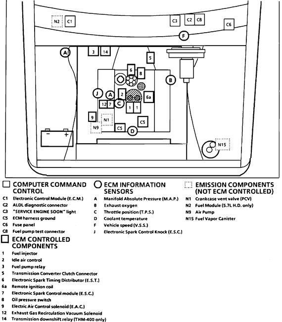

Changed module, pick up coil, distributor cap, rotor button, coil, ignition switch, computer.
Nov 20, 2018 at 7:03 AM
  • 110,248 POSTS

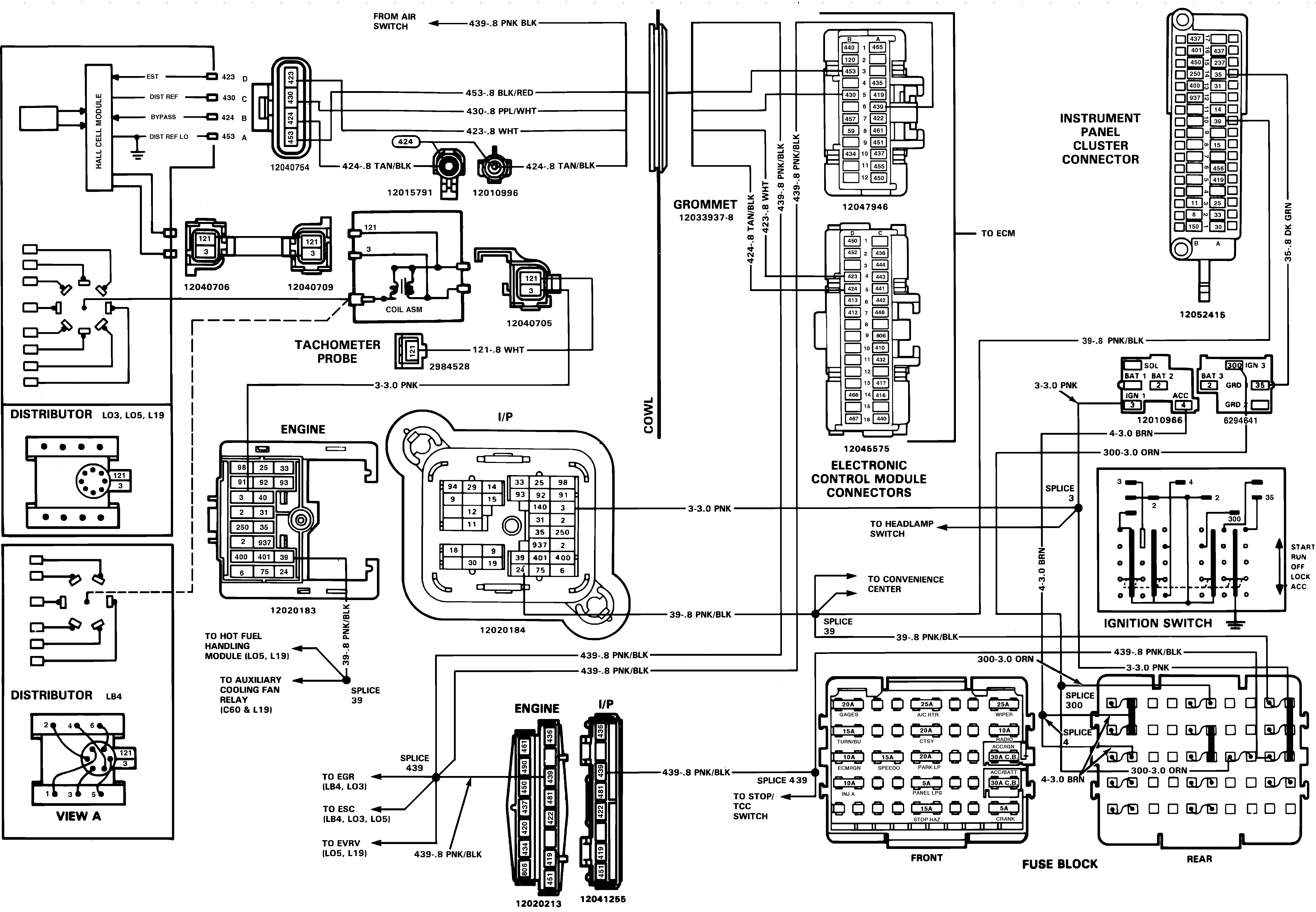

Have you checked all ignition fuses? Have you checked for diagnostic trouble codes?

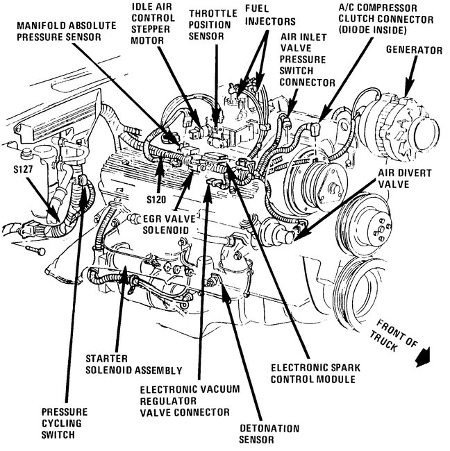

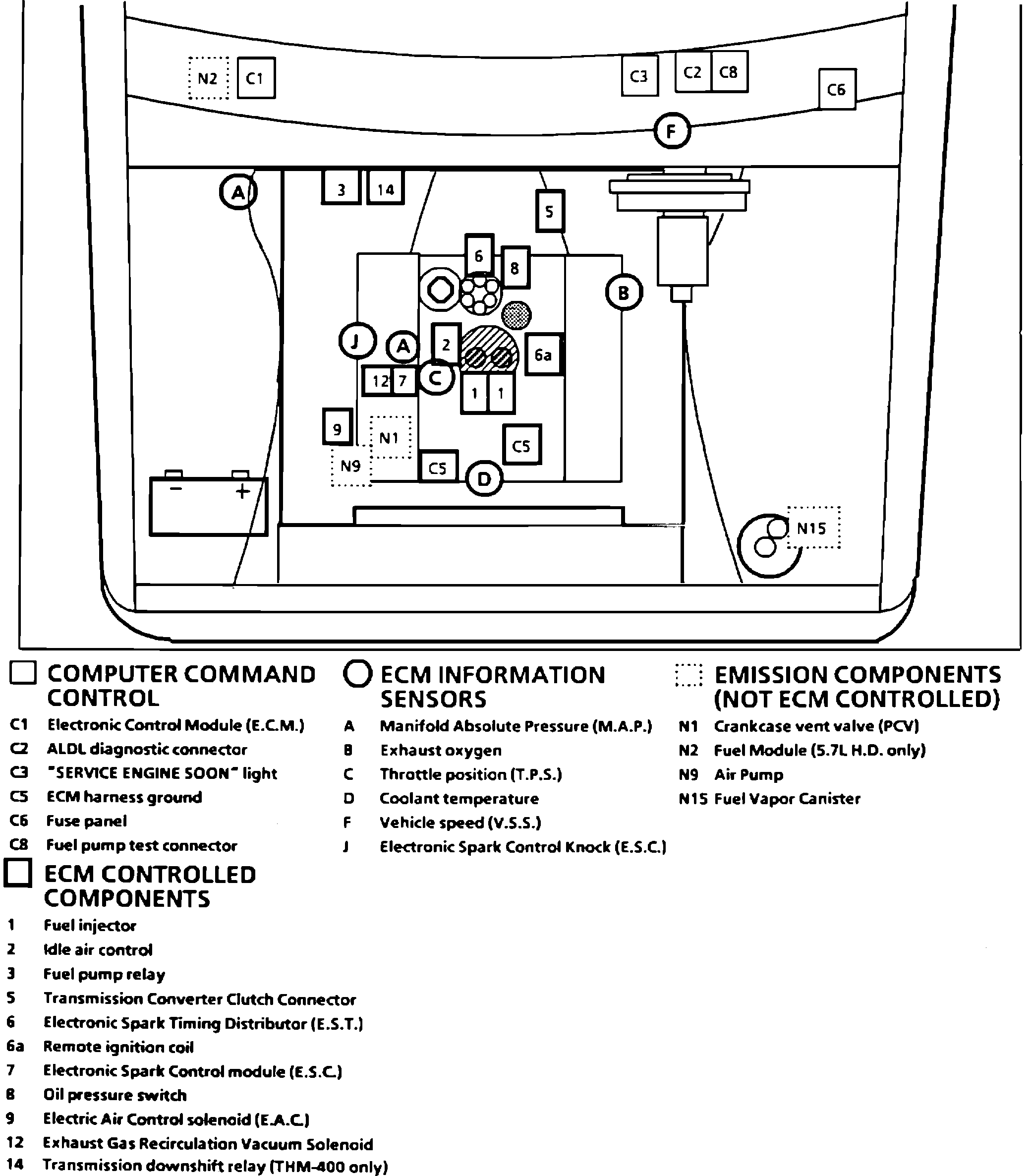

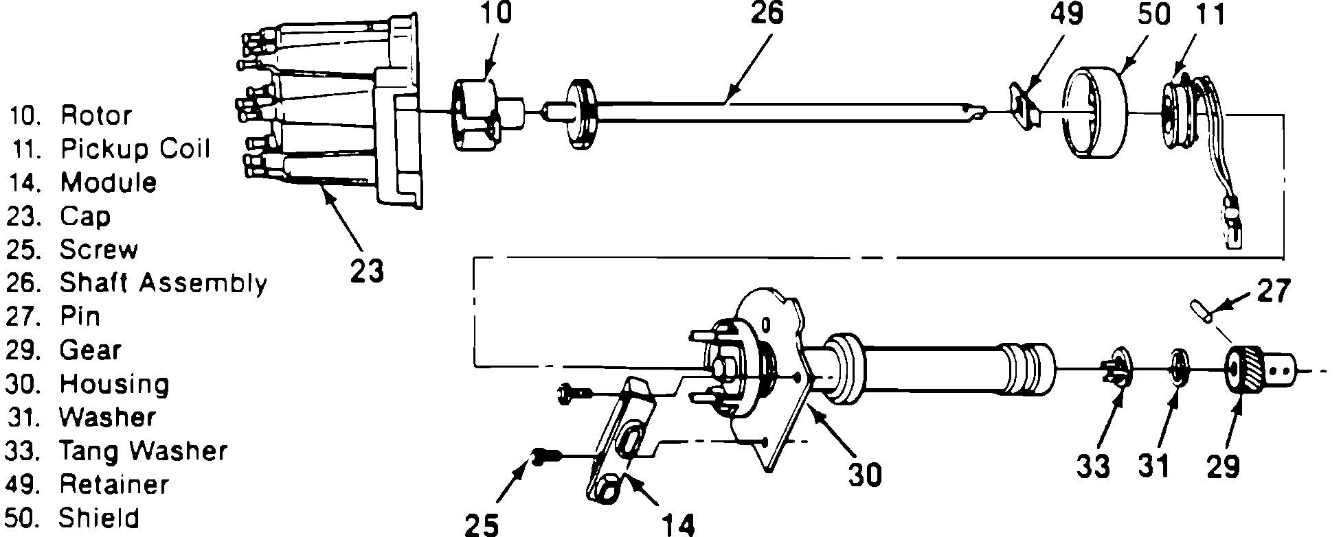

I have attached a schematic of the ignition system of your vehicle. On the schematic, it indicates fuses which correlate with the ignition system. Check them. Also, picture 3 shows the electronic spark control module. Is this the component you are referring to when you say module? I ask because there is also an ignition control module in the distributor. See picture 4.
One last thing, remove the distributor cap and make sure the rotor is turning when the engine is cranked.
