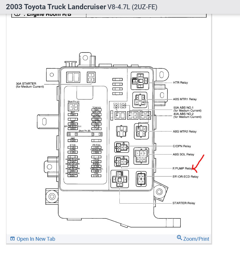

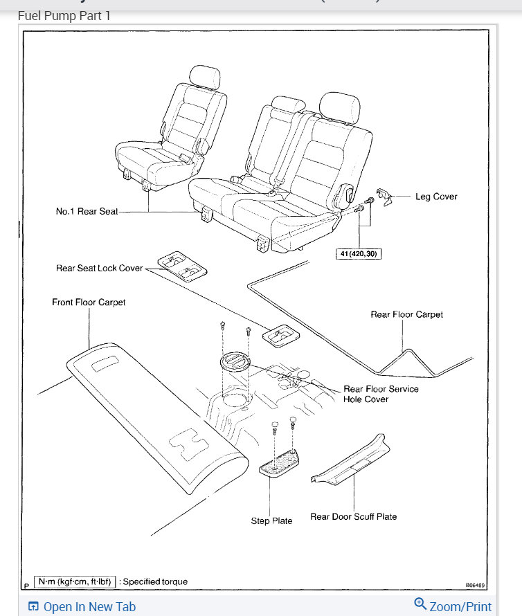

code 78, no engine start?
2003 TOYOTA LANDCRUISER
200,000 MILES • 2.5L • TURBO • 4WD • MANUAL
MBAKINKHWA

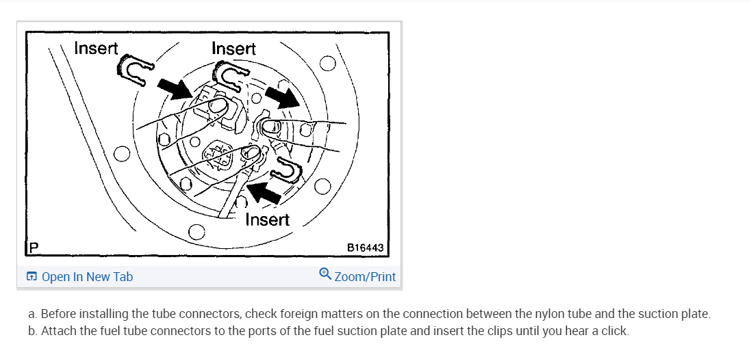

code 78 appears.
Dec 28, 2022 at 5:30 AM
  • 55,256 POSTS

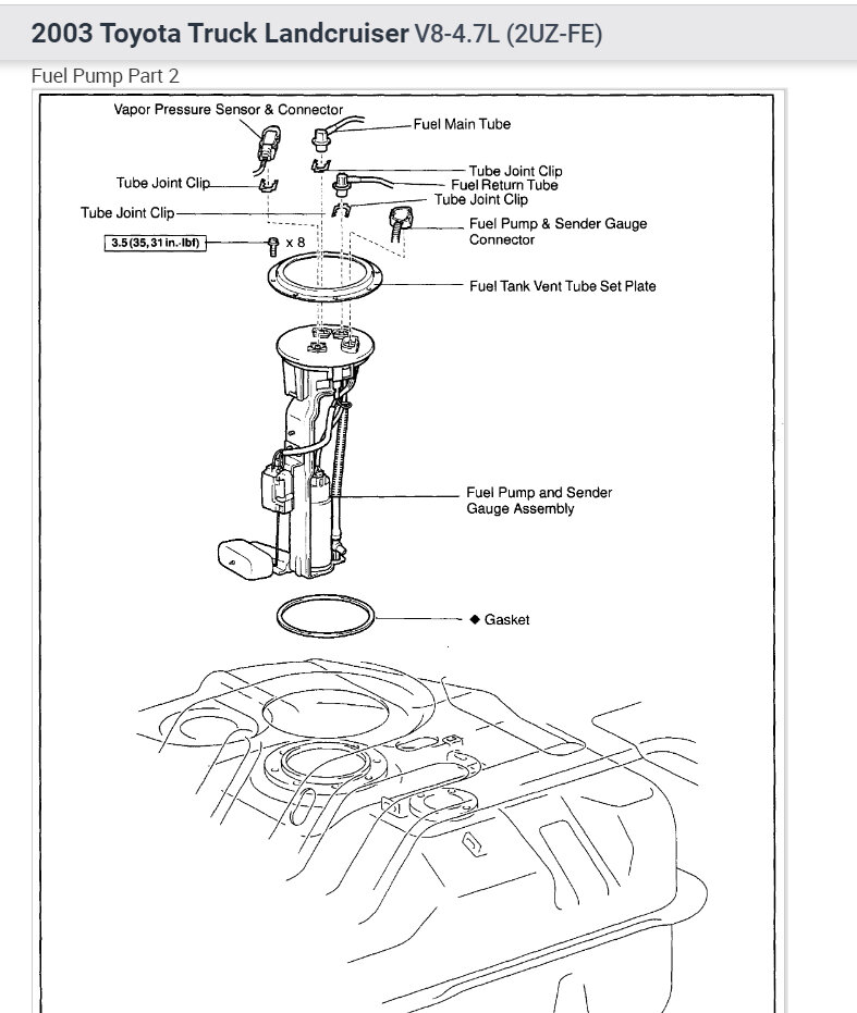

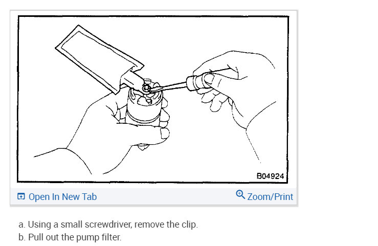

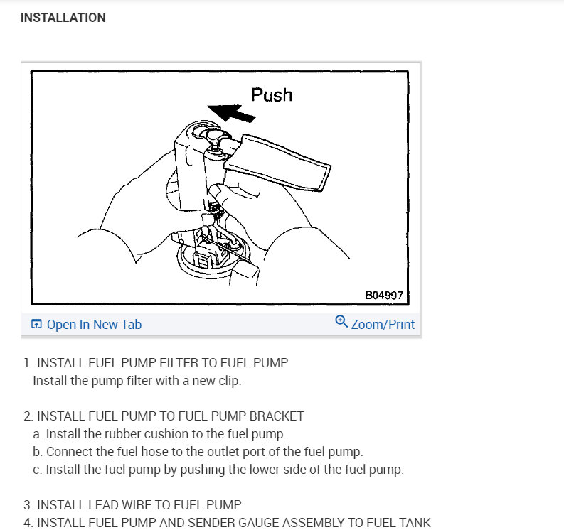

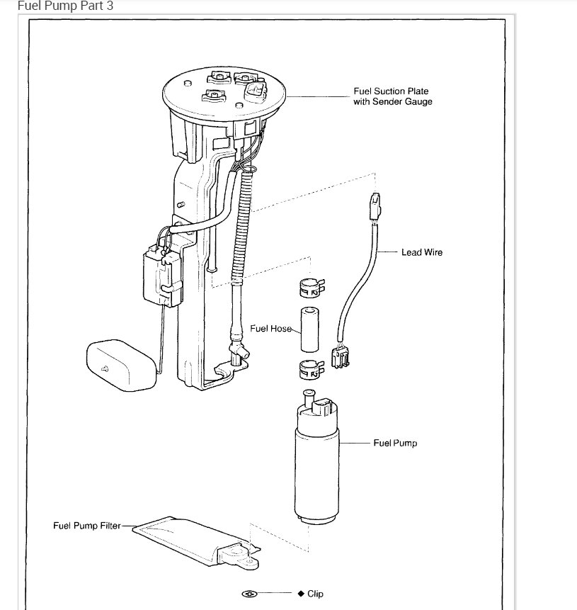

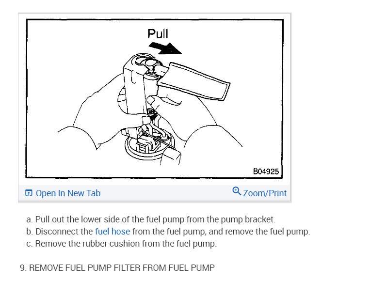

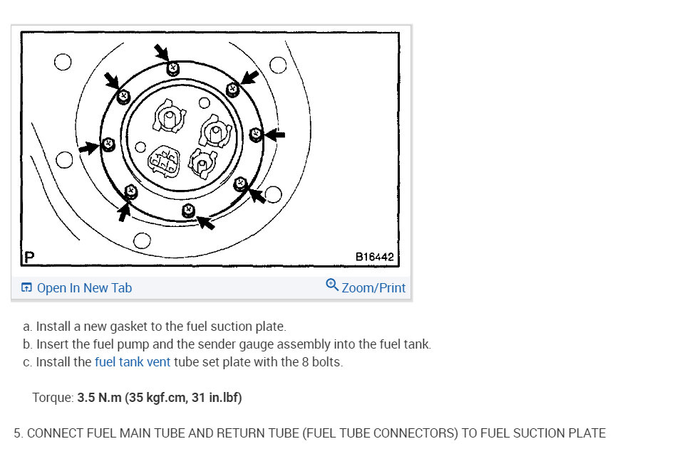

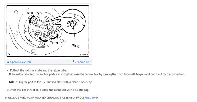

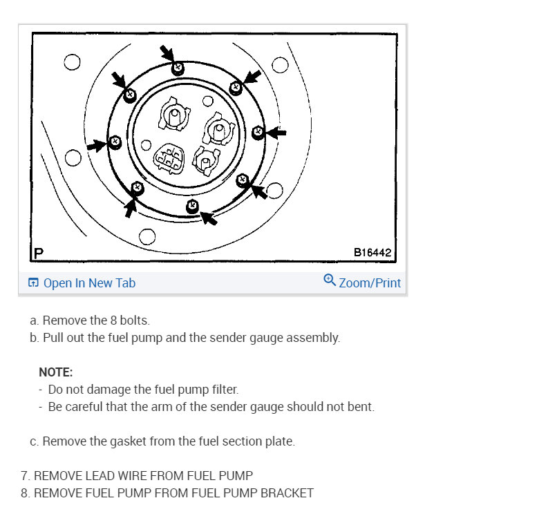

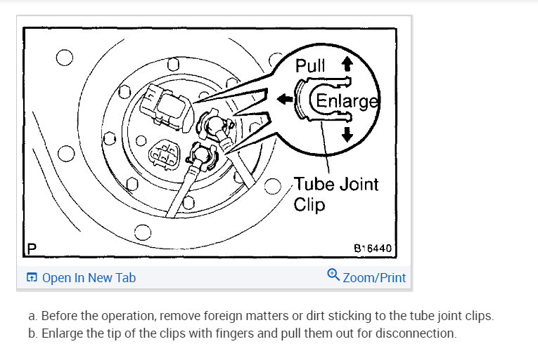

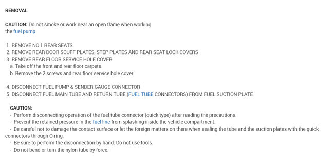

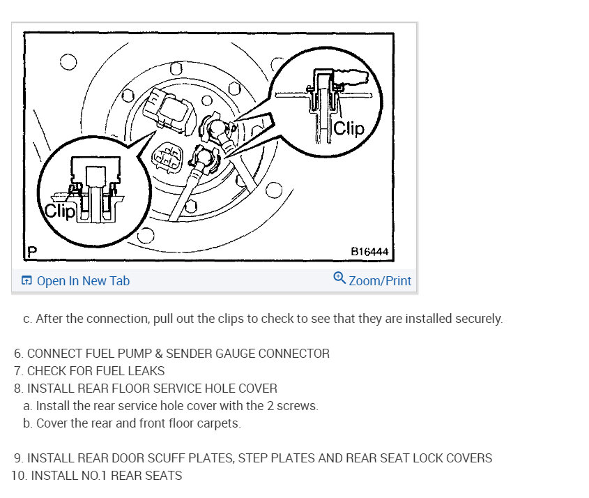

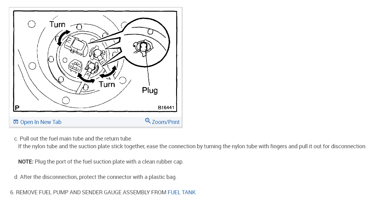

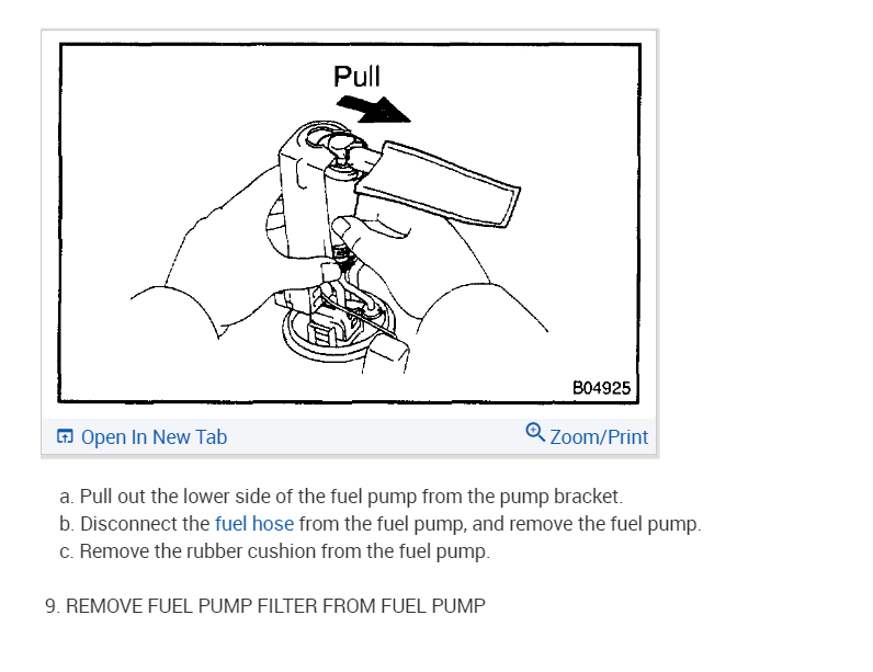

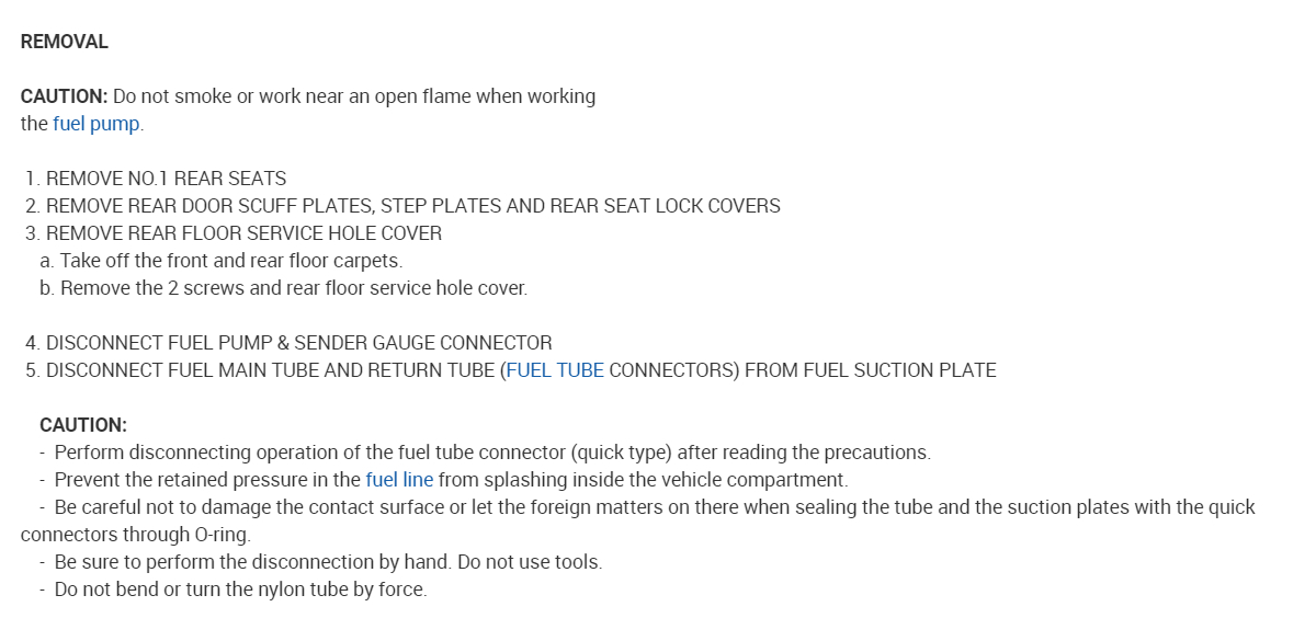

The P1229 (code 78) - Fuel pump fail code tells you the fuel pump is not working, which will be the pump or the relay. Here is the location of the relay so you can swap it out or test it. This guide can help and if that doesn't fix it, I have included how to change the fuel pump pout in the images below.
Check out the images (below). Please let us know what you find. We are interested to see what it is.
