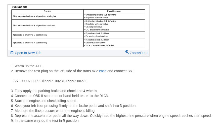

After a transmission overhaul we changed the oil pump, clutches, and some seals. We also rebuilt the primary variator, just the seal, we wrapped some cotton on the base where the seal sits as the air pressure test failed after rebuilding. The vehicle runs perfectly when cold but once the transmission gets hot no gear is engaging.

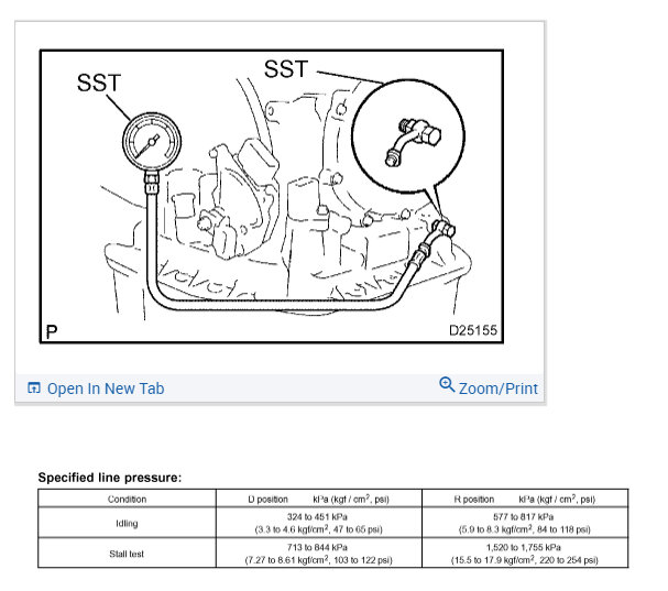

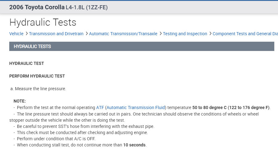

If you lose all gears, it sounds like you are losing line pressure. Have you been able to check that? Also, have you checked to make sure there aren't relevant diagnostic trouble codes related to the transmission?
I attached the directions below for testing line pressure. Let me know if this is something you are comfortable performing.

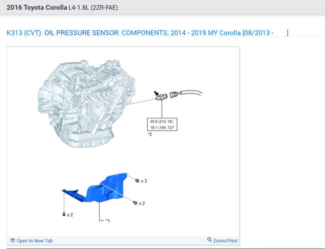

Also, it sounds like you may have a bad fluid pressure switch which I have included the location in case a code comes up for it.
