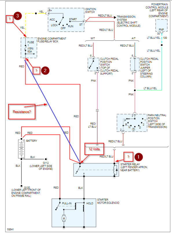

I replaced the manual transmission in my truck. After putting in the replacement, I started it up and it started just fine. I then replaced the clutch master cylinder because I saw that it was leaking. After I did that, I tried to start it up and it would turn over, but would not start. I sprayed some starter fluid into the intake, and it still didn’t start. I started to clean some grounds, including the ground attached to the engine block, and tried starting again. Absolutely nothing happened, the engine didn’t turn over, no power to the dash, no headlights and no power anywhere that I could find. It will turn over if I connect the poles on the starter relay. I don’t believe there is power getting to the interior fuse box. I have replaced the ignition switch as well. I had also replaced the brake light switch at the pedal when I was waiting for the new clutch master cylinder to come in and the brake lights worked (they hadn’t previously). I don’t think this switch is involved, but since it was done at the same time, let you know. I have also cleaned the battery posts and the connectors and the battery is reading 12.6 volts.
Mar 20, 2021 at 8:44 AM

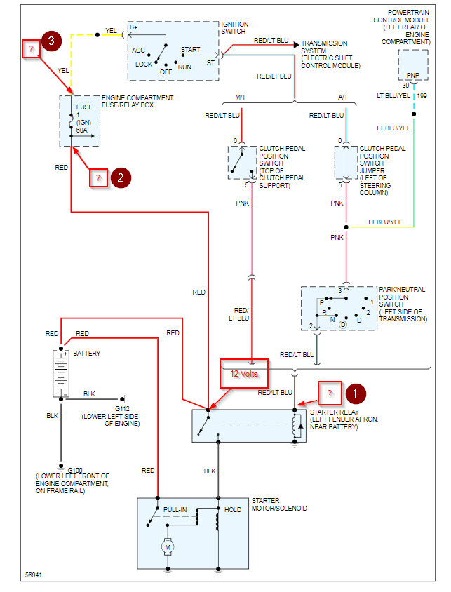

The only way to figure this out is to find power in the system and track it through the system until we find were we do not have it.
If you can jump the starter relay then that means you have power from the battery to the switch side of the relay. However, do you have power on the other terminal coming from the clutch position switch? I assume you do not have 12 volts.
Which means we need to more to the ignition fuse and check on both sides. If you have voltage on both sides of the fuse then keep moving through the system until you find the component that has voltage coming in but not out.
Let me know if you have questions on this. See the diagram below. Thanks

Thanks for the reply. There is no power to the ignition fuse in the engine compartment. I had a good ground when I did it because when I touched the red probe to the positive battery post it read”12.5 v”. Does this mean that the red wire in the above diagram is bad or not making a connection at one of the ends? FYI: I am pretty ignorant with electricity if you haven’t already caught on.

Okay. If you have no power on either side of the ignition fuse then you have a wiring issue from the battery to the starter relay or the starter relay to the fuse. However, I think you said you have 12 volts at the starter relay? If so then the issue is on the wire from the relay to the fuse shown in this diagram.
I would remove the relay, test resistance from the relay terminal to the fuse terminal and see what it is. The blue line on the diagram. Let me know if you have questions about this but it should be no more then 1 ohm.
