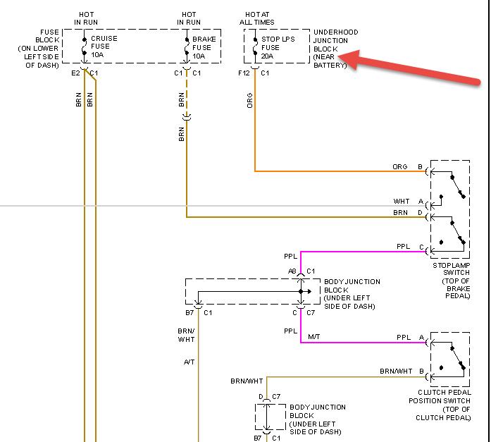

according to our diagram there are only 4 wires going to the brake light switch and that is with cruise control as the other one has only two. the diagram that I've attached. I am assuming this is a 5.3L engine and has no traction control. hopefully you have checked the fuses underhood for this. the red wire to your controller should go to the white wire so it powers when the brake is applied. However as this is an after market thing I would send you to a place that installs these andsee where they put it as it may be a wire that is supposed to be hot all the time and may be installed on the fuse box underhood. Isee no grn/wht wire on the diagram.

please note there is also a vehicle stop fuse underhood as well that is not shown. it shold be marked on underhood fuse box cover

Thanks for the diagram. The brake light switch I have definitely has six pins.
I have checked all of the fuses and they are good. There is an additional, 30A maxifuse that is in Stud #2 in the underhood fuse box. This fuse apparently goes to the controller although it isn't identified as such on the fuse box diagram. Unfortunately, the 30A maxifuse is good :( If it wasn't, it might have fixed the problem.

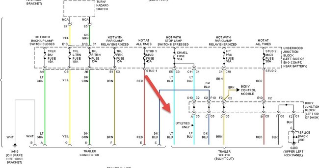

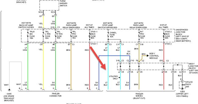

here is a trailer circuit that the lt blue wire shold be hot when brake is applied. BUT in the normal circuit the WHITE wire is hot when brake applied from switch on brake pedal. Are you sure you have checked all the fuses underhood for this? as that is where they are.. see pic. I really don't know what to tell you other than to have alocal guy look at this. as everything I've sent shold have those working.

Ahhhh. The white wire. Fixed! I tapped into it.
I had thought the white wire was always hot. I think when I tested it before, I was lying on my back and I may have been pressing against the pedal.
