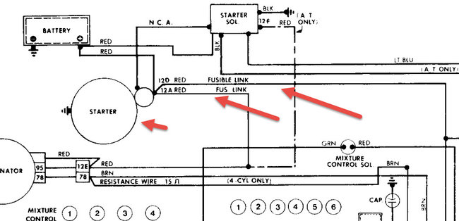

Made a u turn, everything went off,no headlights no radio nothing,checked fuses,battery good terminals tight, crossed starter silanoid will crank but no start like key off?
Jan 30, 2016 at 12:11 AM
HMAC300
  • 48,601 POSTS

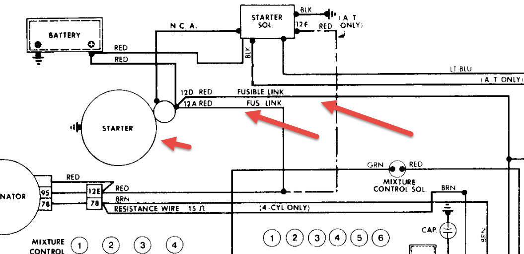

check fusible links off of starter......see pic
