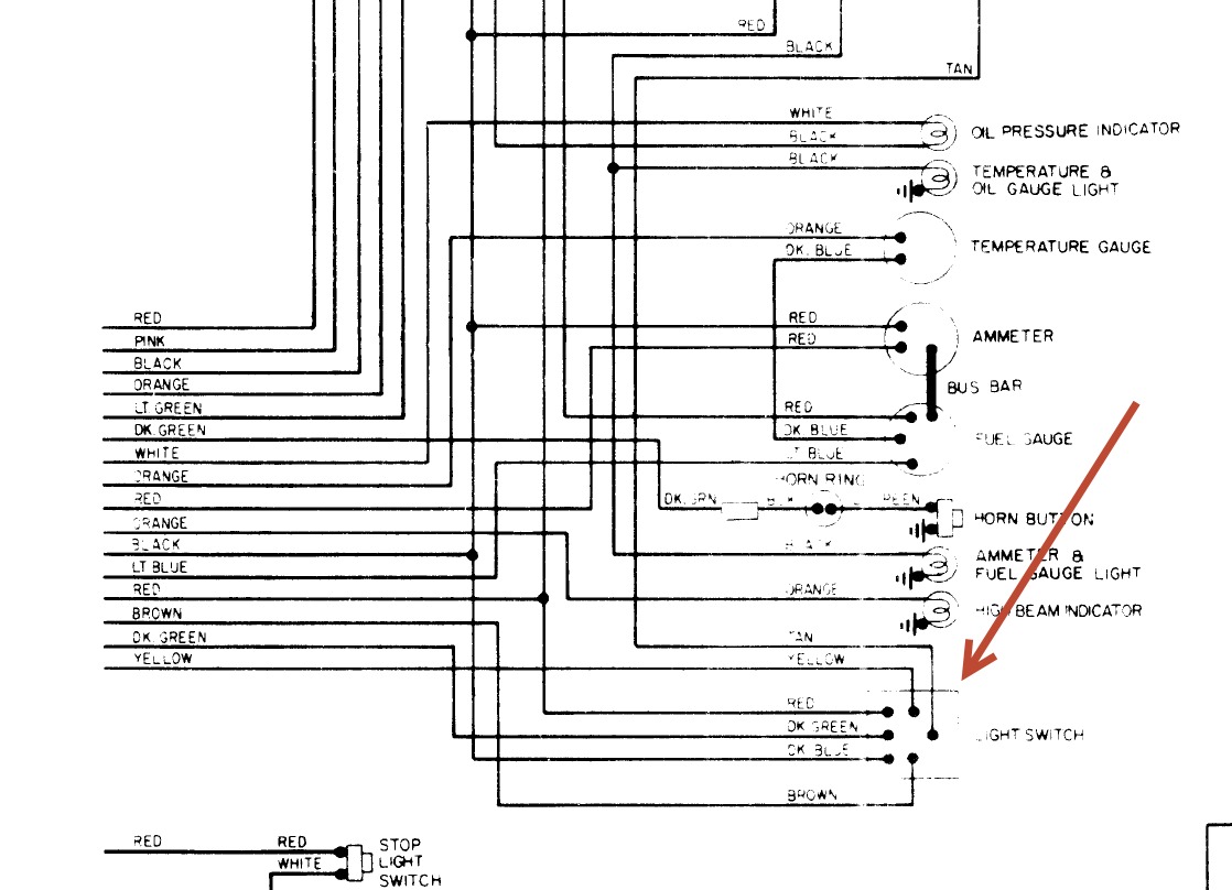

just bought a executive motorhome, have absolutely no lights... interior, or exterior....needing a wiring skematic, hopefully free...manual or diagram.. prefabably manual....as I need to do some other small things... bleeding brakes etc. am having trouble finding manuals at all..

good luck on this one. this is off a p model is which I think your chassis is. check the red wire going to light switch then the tan wire going to fuse box. then go from there. If this is a fiberglass body then check grounds as a lot of outside lights loose grounds. I might have other diagrams but not sure if for car or not. you should have three wires going to back yellow, green , brown. brown will be taillights, yellow will be for turn sig green the same but I forget which side.
