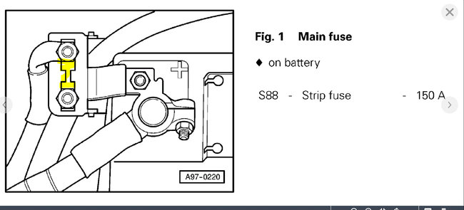

The battery completely drained after a few very cold days and a phone charger was left plugged into the cig lighter.
I went ahead and replaced the battery. Once I reconnected the battery cables there is absolutely zero power showing in the car anywhere.
My brother thought it could be jump-started but when he attached the jumper cables there was still no electricity anywhere.
Feb 19, 2022 at 4:47 AM
  • 110,251 POSTS
If there is nothing working, either the main fuse is bad, or we lost ground. Do me a favor. On the positive battery terminal cable, there is a strip fuse (150 amp). I need you to check it to make sure it hasn't failed. Additionally, make sure there is power in and out from it.
