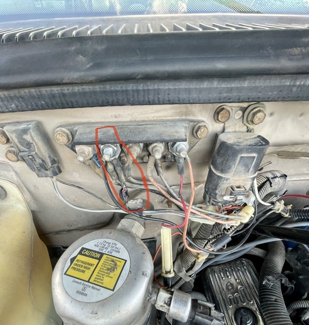

I was sitting in a parking lot with the truck engine on. It was in park. Then it just turned off. No electric, it was almost like the battery was completely drained. Lights still work but nothing else does. Removed the junction box cover and a fusible link (red) that is connected to the second screw from left had burned up.

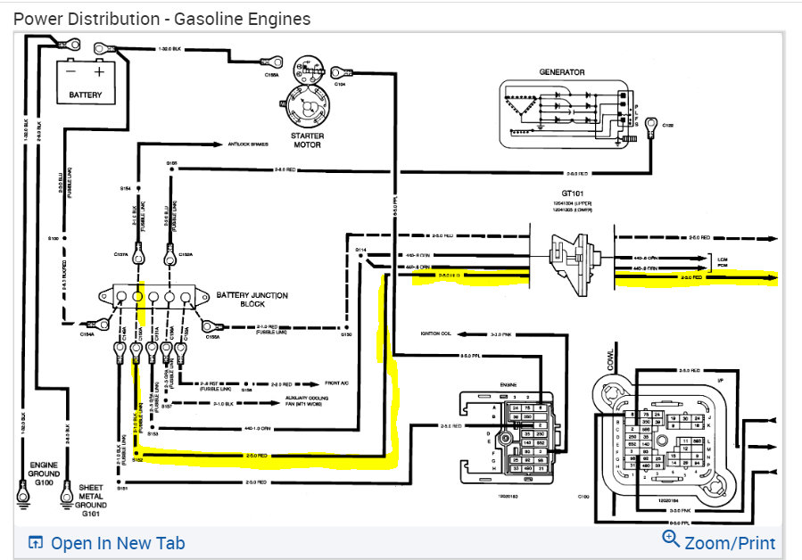

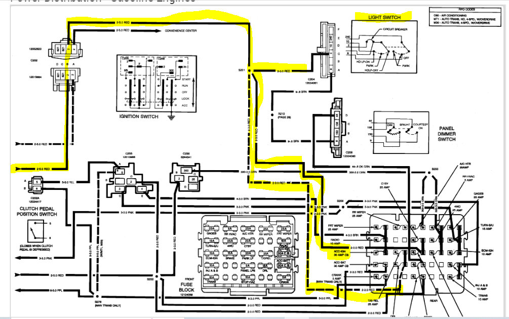

By chance, have you tried replacing it to see if it fails again? I ask because that fusible link powers several different things. I attached a wiring schematic below and highlighted the power supply and where it goes.
If you have tried replacing it and it failed again, we need to remove fuses in the vehicle related to the link. Then, one at a time replace the fuses to see which one causes it to fail again.
Take a look through the schematic. Sorry, it is in black and white, but because of the model year, the only schematic I have is the original one from the factory.
There are two pics. The first one shows the fusible link. I highlighted it until it runs off the page to the next page.
Let me know your thoughts and if you have questions.

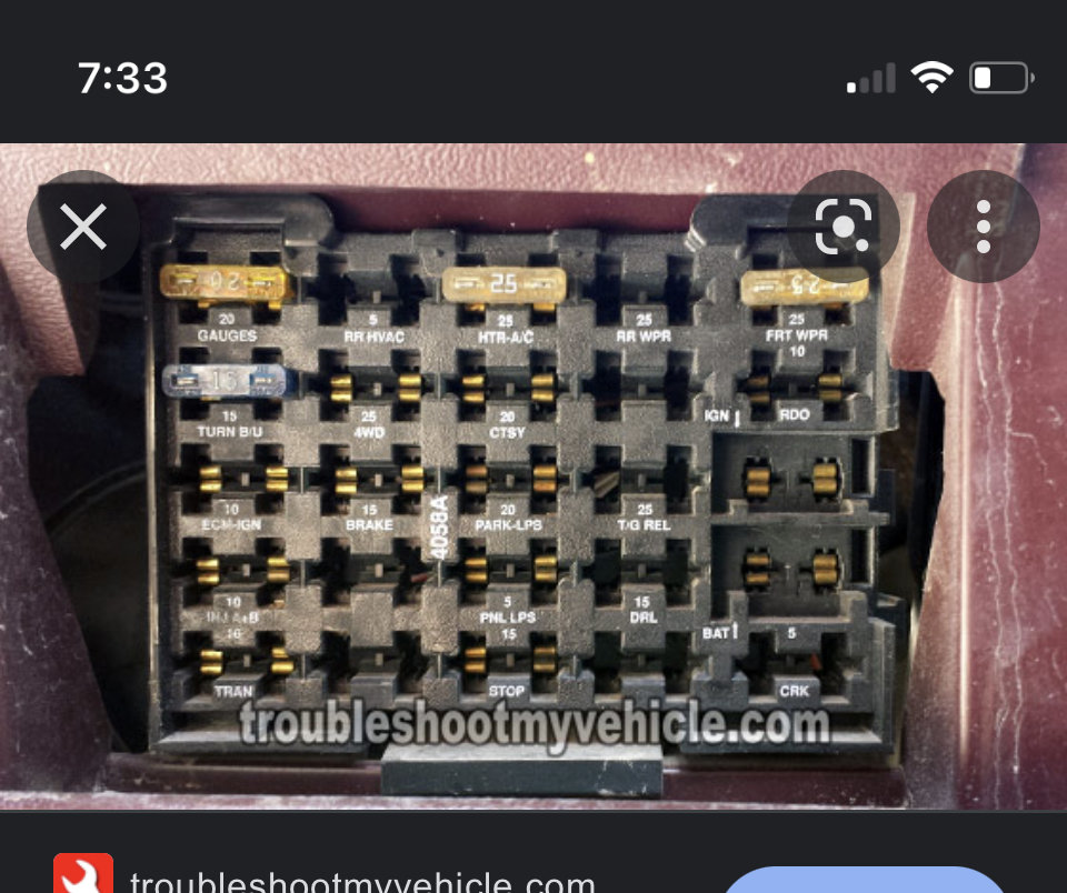

I’m not the best with electric diagrams. What fuses are linked to that fusible link? Here is a picture of my fuse box on the lower part of my dash on the driver side.

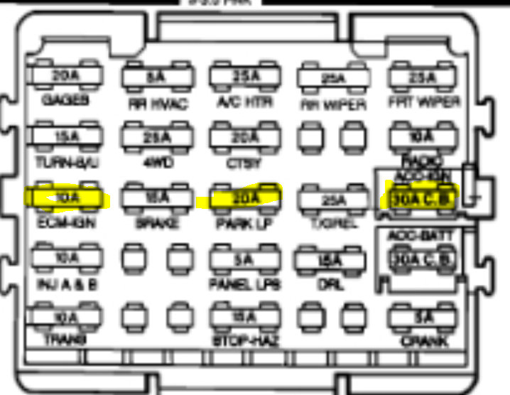

Did you remove the fuses? I attached a pic below of the box. I highlighted the fuses to remove, but they already appear removed in your pics.
Keep in mind, the fusible link may have failed due to age. So, it may be the only thing required.

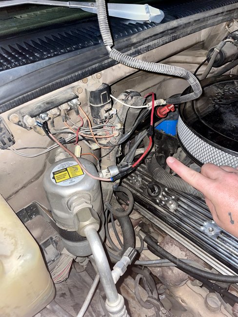

Are you able to trace the wires into the vehicle for inspection? Also, does the wire only get hot after the key is turned on or only when the starter is engaged?

I’ll trace it back when I get home tonight. What should I look for when I trace it back? The starter doesn’t attempt to turn over. When I turn the key, literally nothing happens.

Check for anything that can cause a short. Pay attention to the insulation on the wiring to make sure a mouse or something didn't damage it. Make sure none of the connectors are not melted or damaged.
