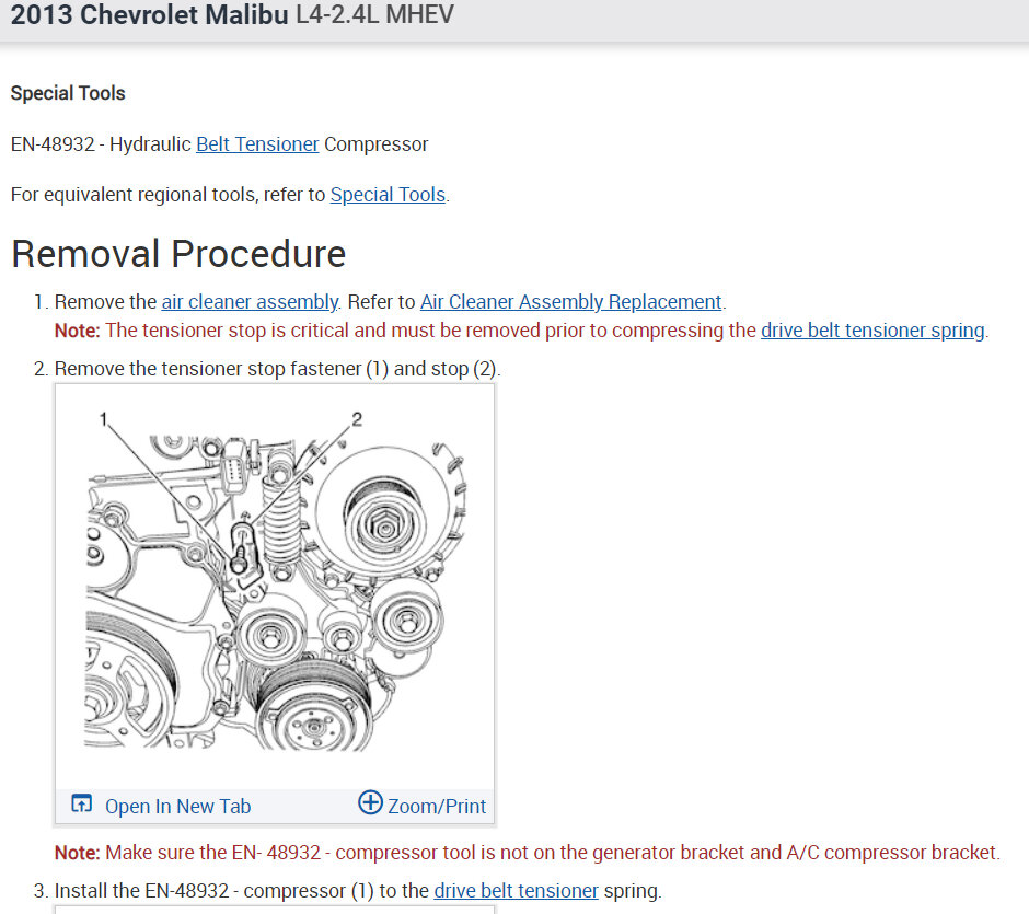

How to replace the serpentine belt, do you have any diagrams or guides?
2013 CHEVROLET MALIBU
150,000 MILES • 2.4L • 2WD • AUTOMATIC
EDWARDMOSCOSOLANO
How do I replace the belt in my car listed above eco edition? No diagram for serpentine belt.
Dec 28, 2023 at 11:31 AM
  • 55,433 POSTS

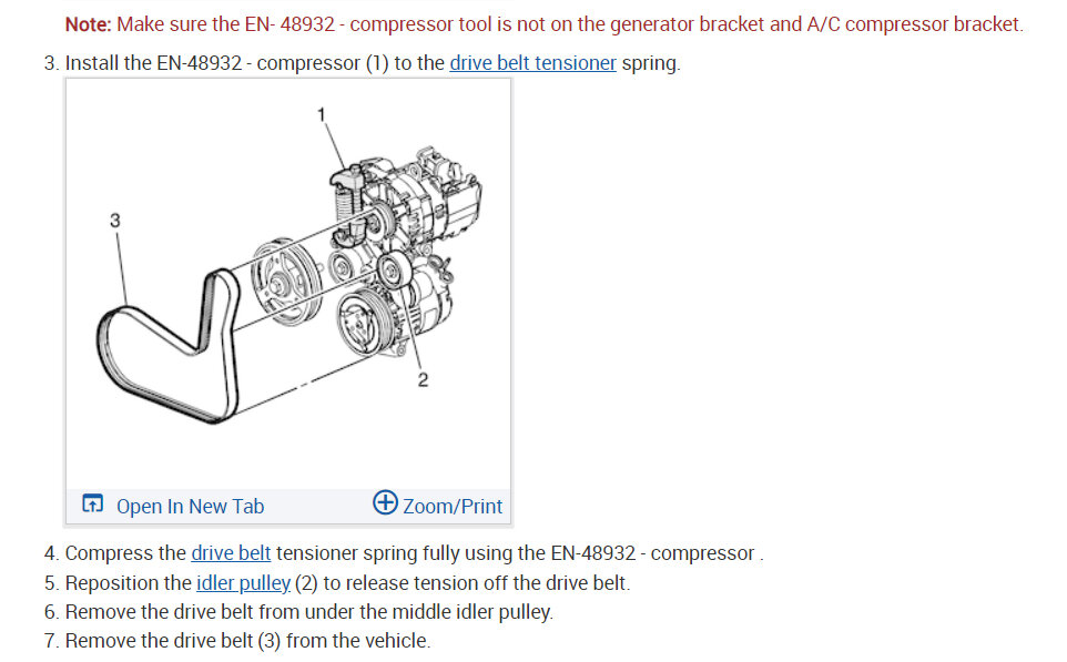

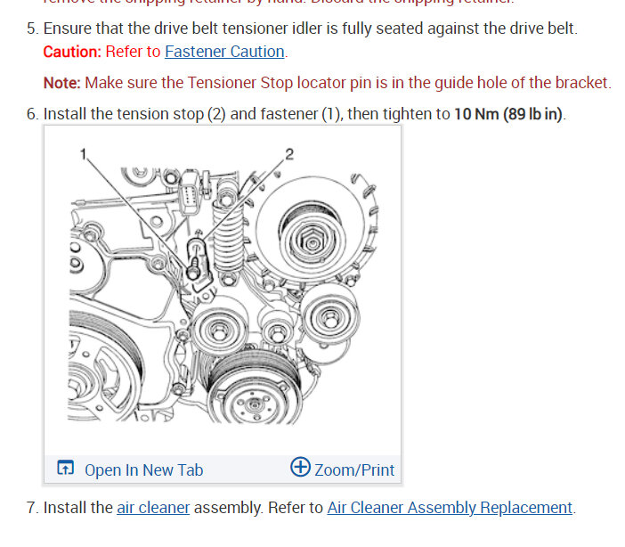

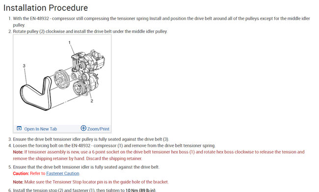

Yep, it looks like there is a spring-loaded belt tensioner that needs to be deactivated when changing the main serpentine drive belt out. Here are the instructions on how to do so. Here is the part number for the belt in case you need it:
Serpentine Belt - 12660099
Check out the images (below). Let us know if you need anything else.
