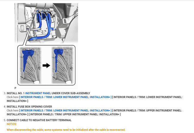

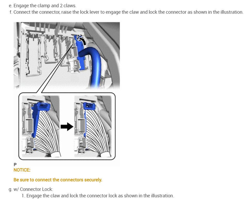

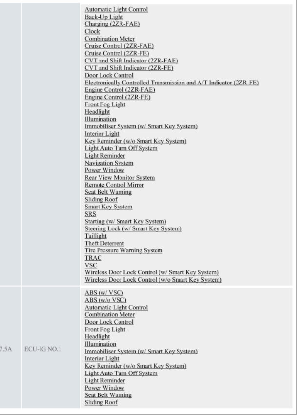

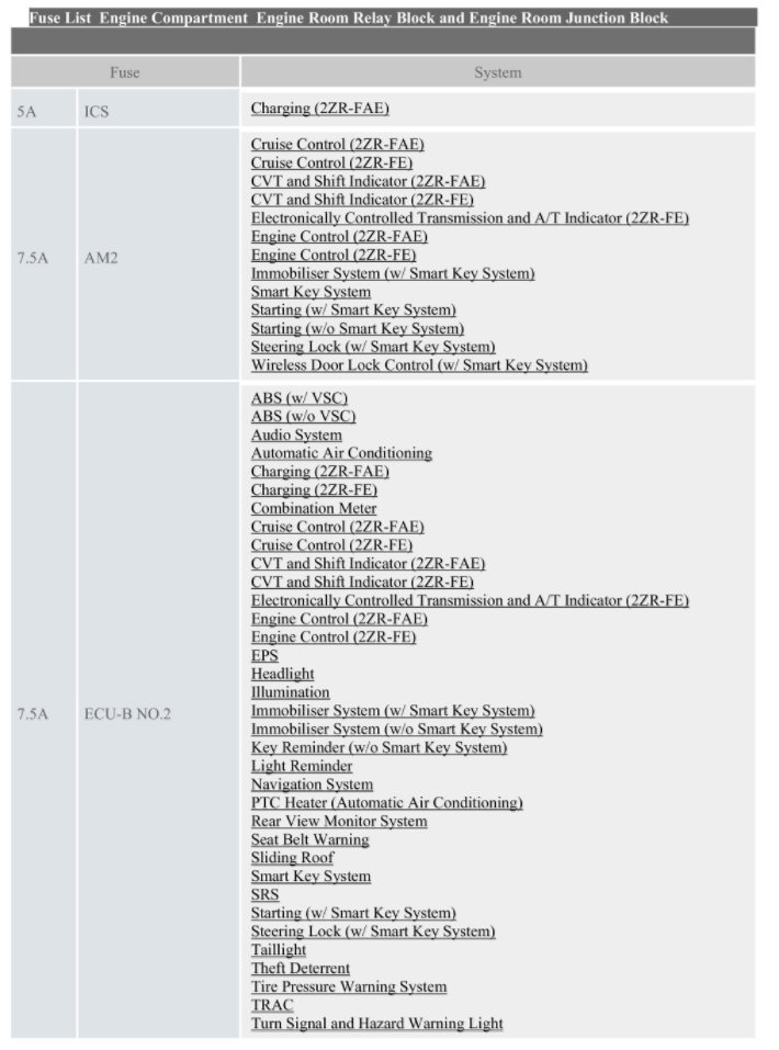

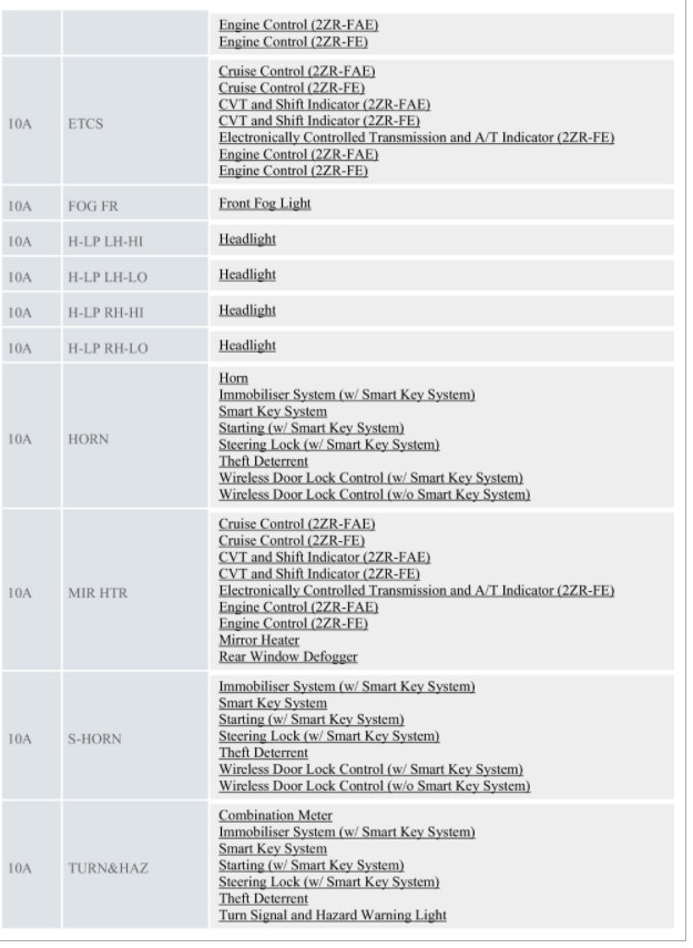

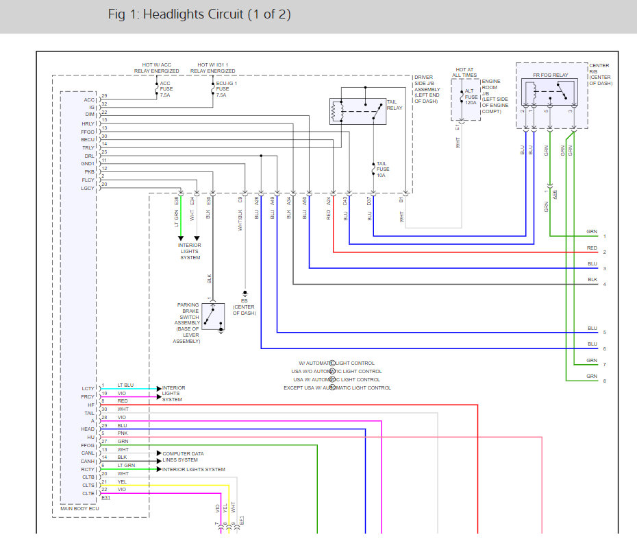

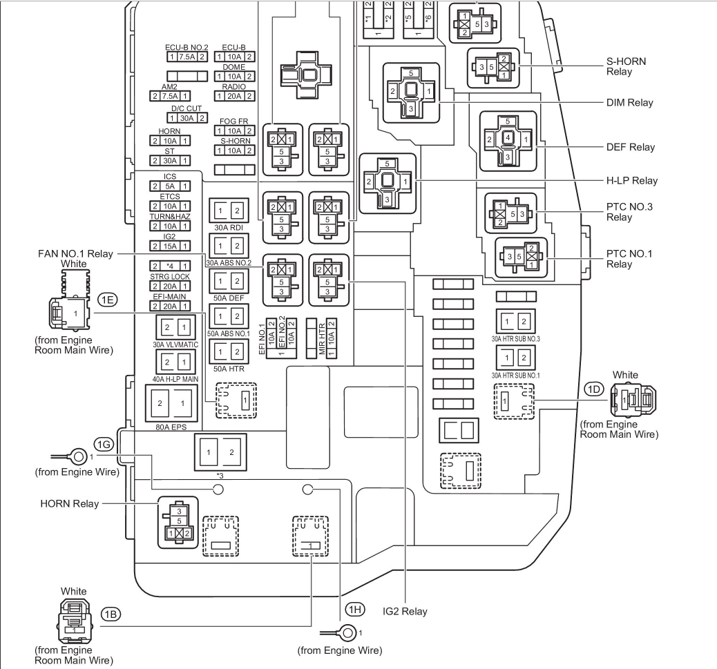

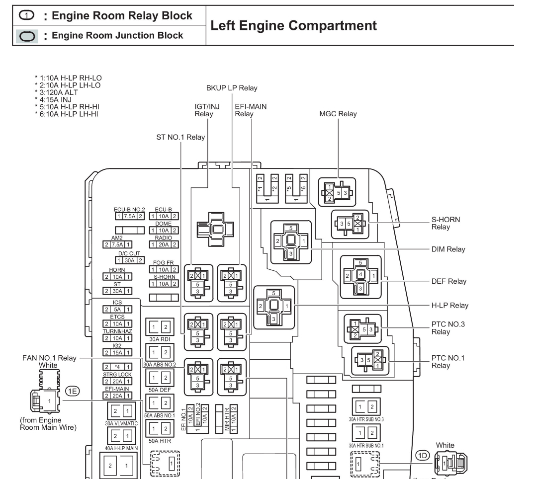

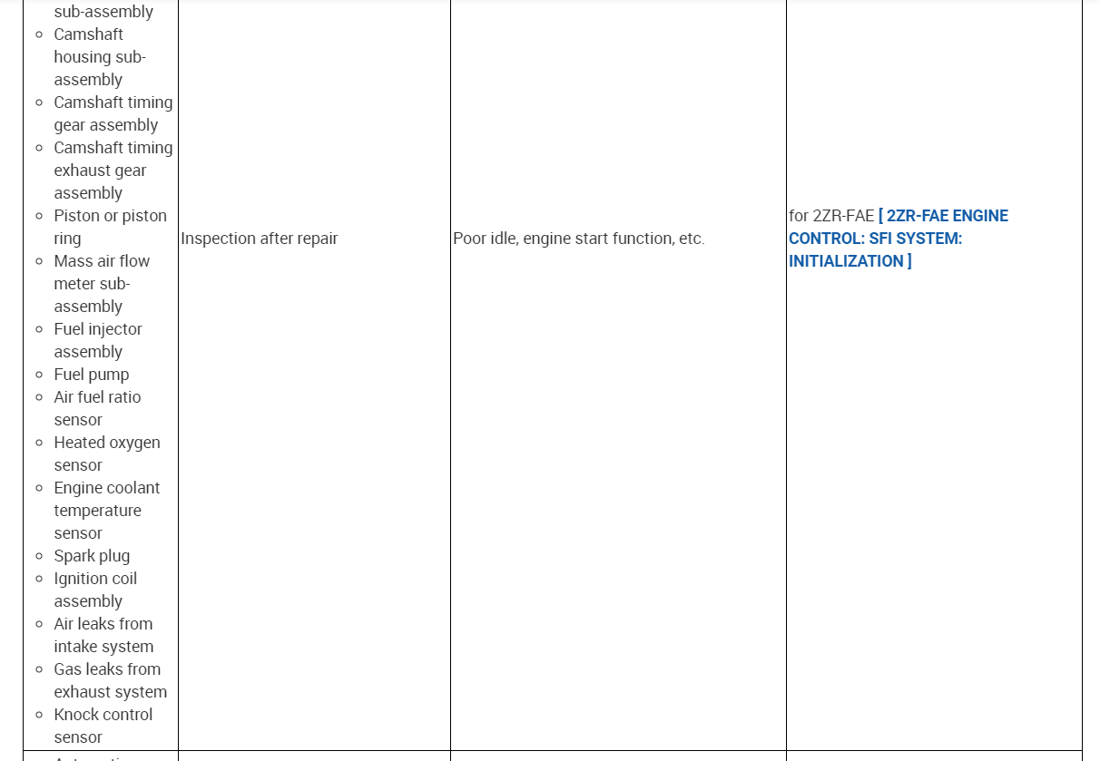

My headlights on my car stop working. I only have bright lights; no daytime running lights or low lights working. Please help!
Sep 28, 2019 at 8:29 AM
  • 55,433 POSTS

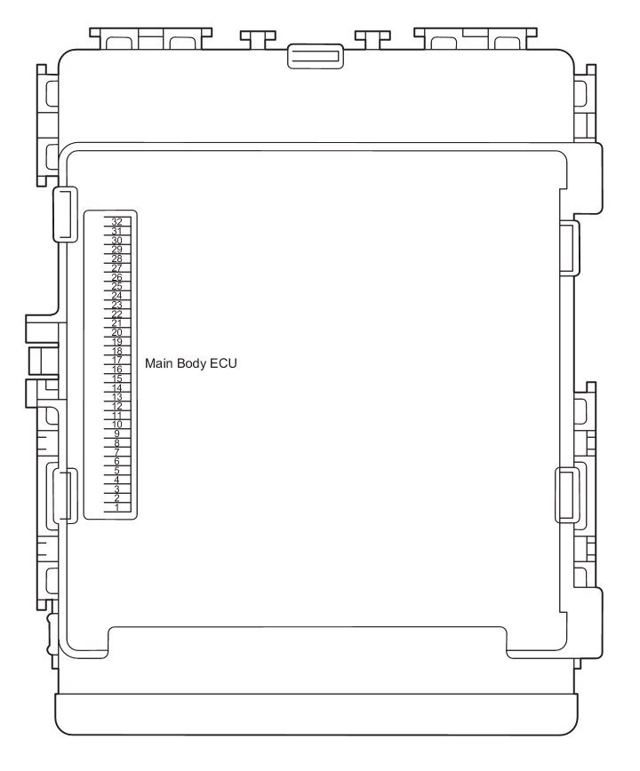

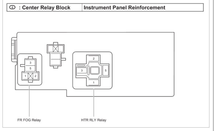

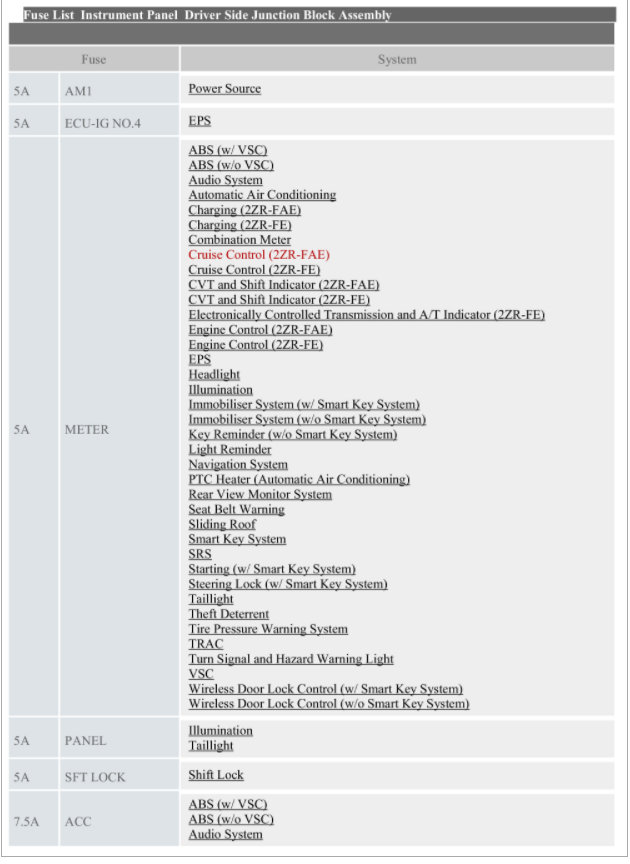

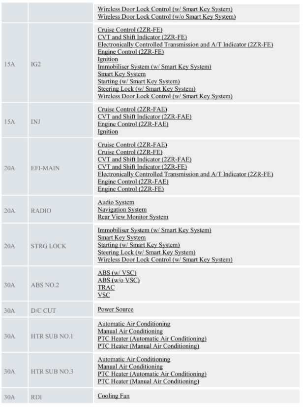

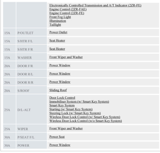

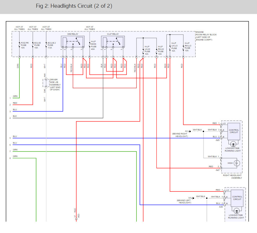

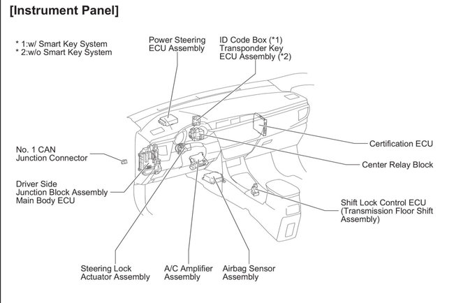

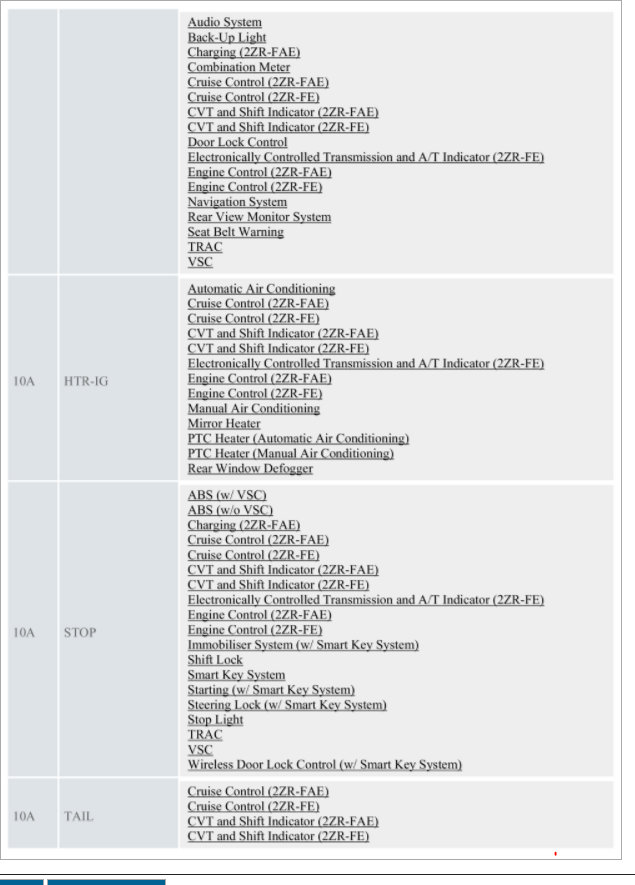

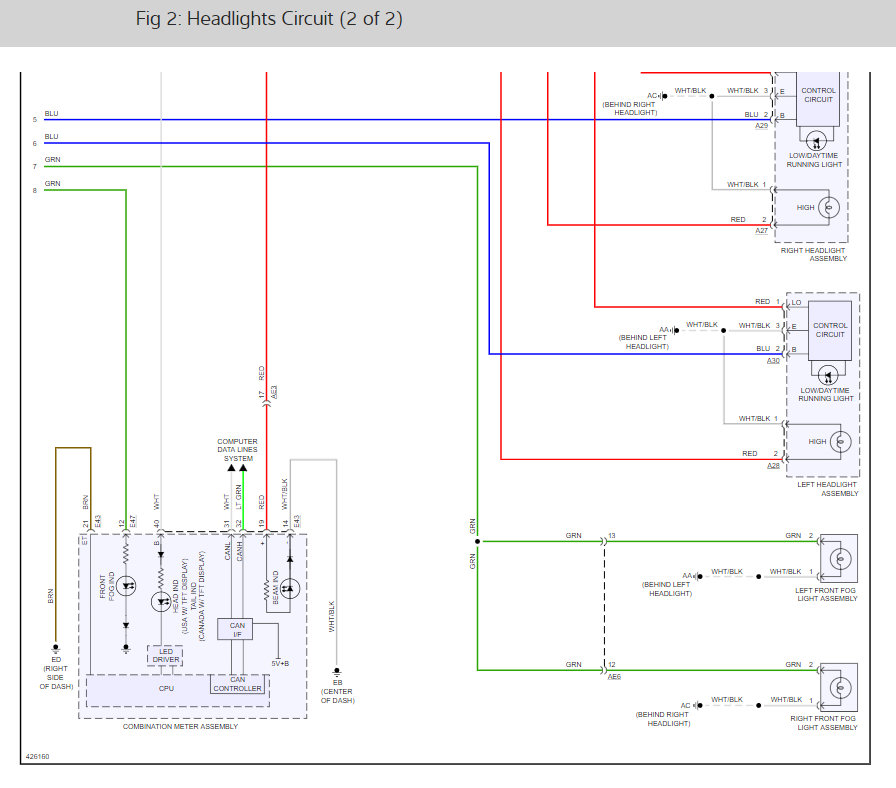

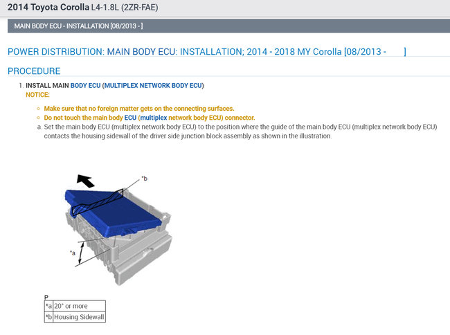

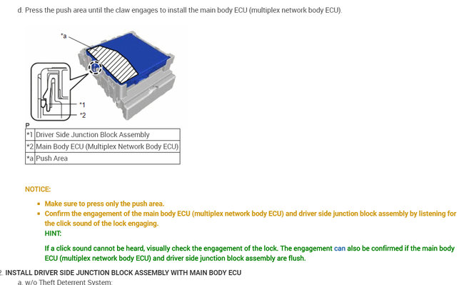

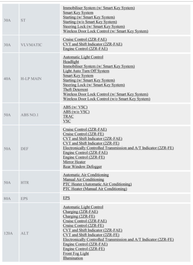

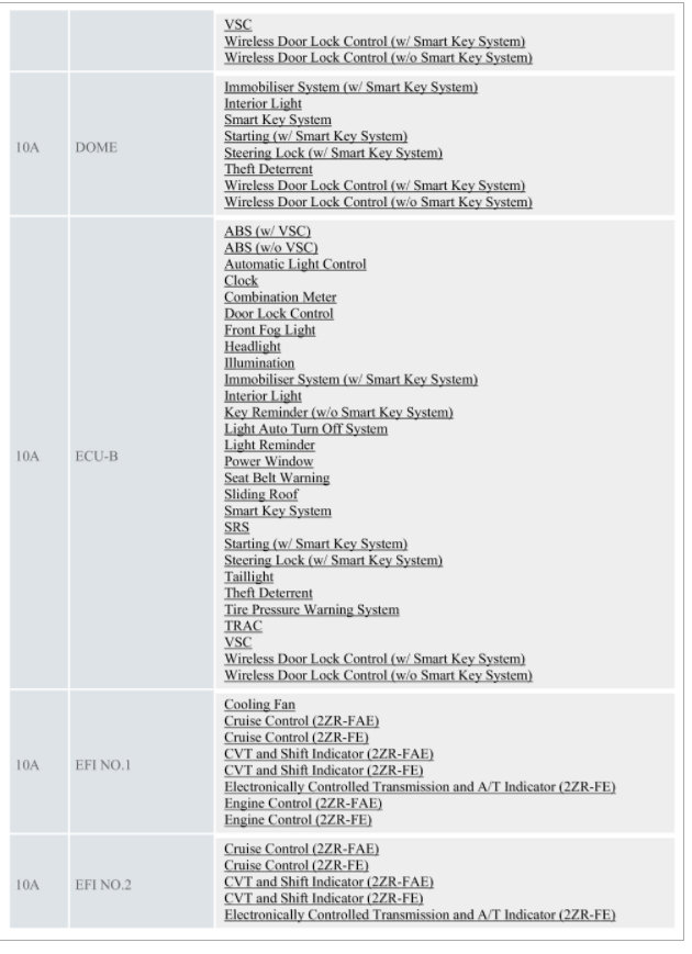

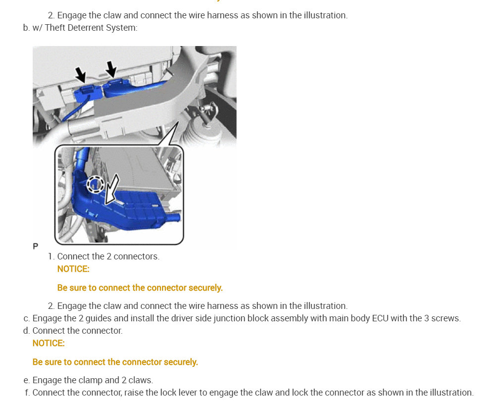

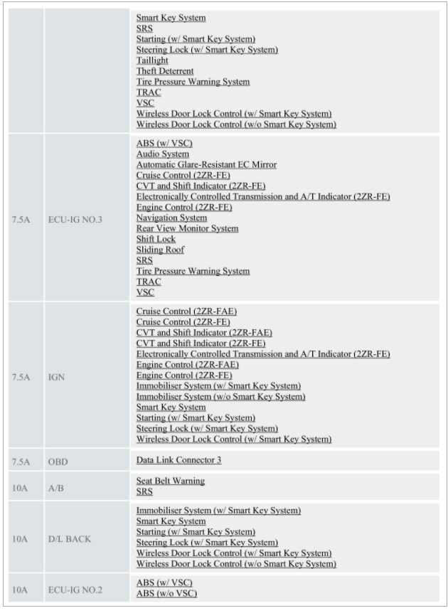

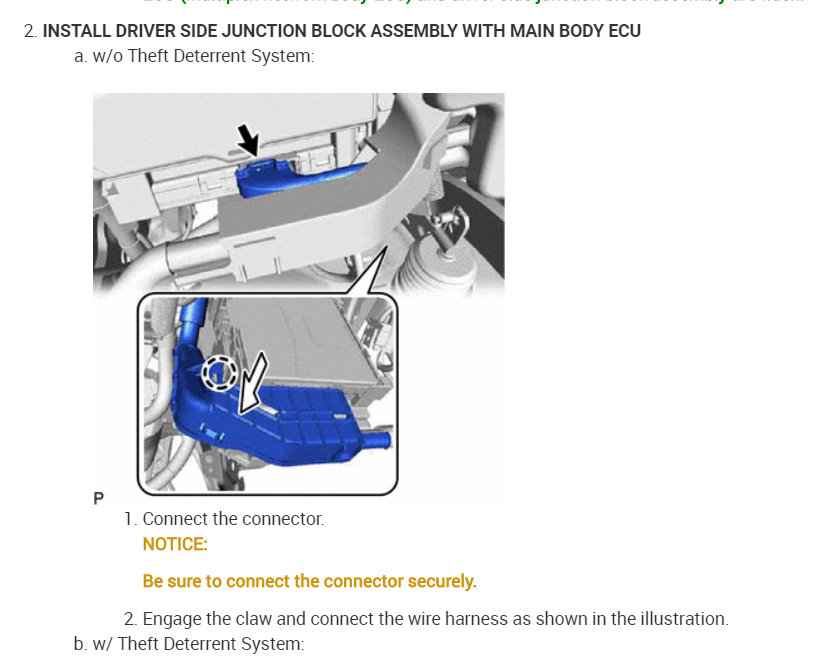

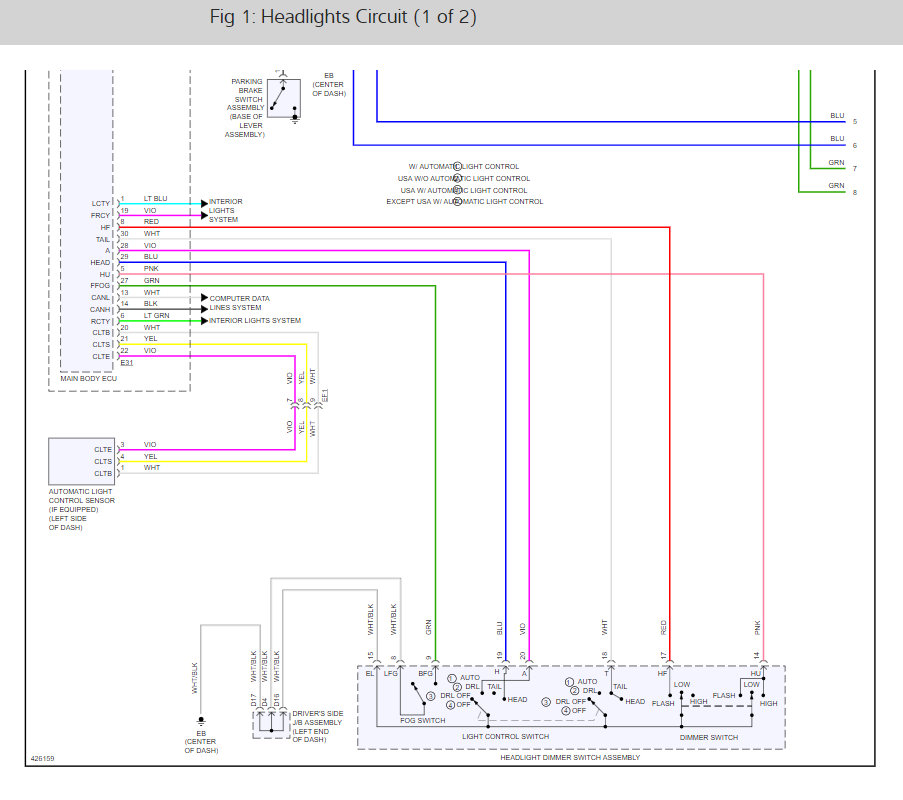

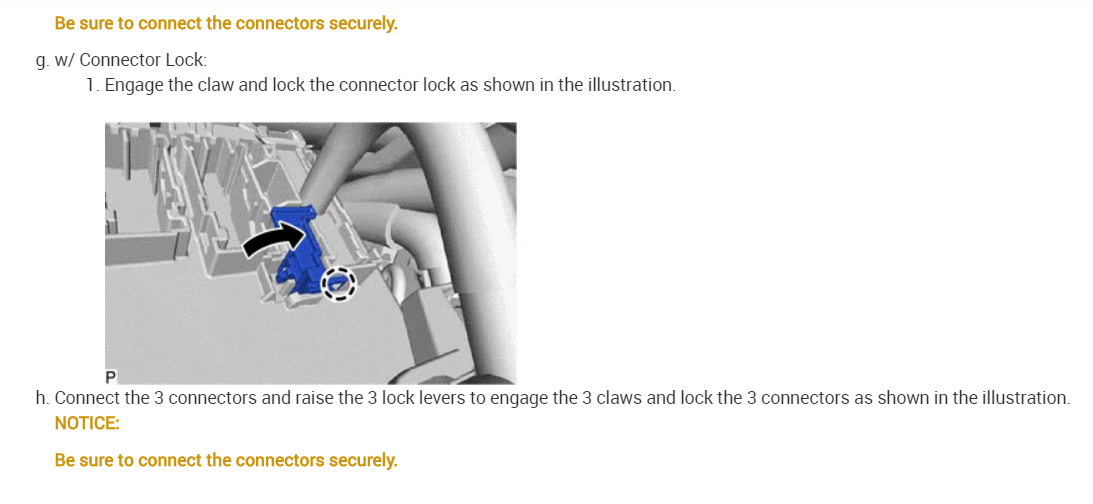

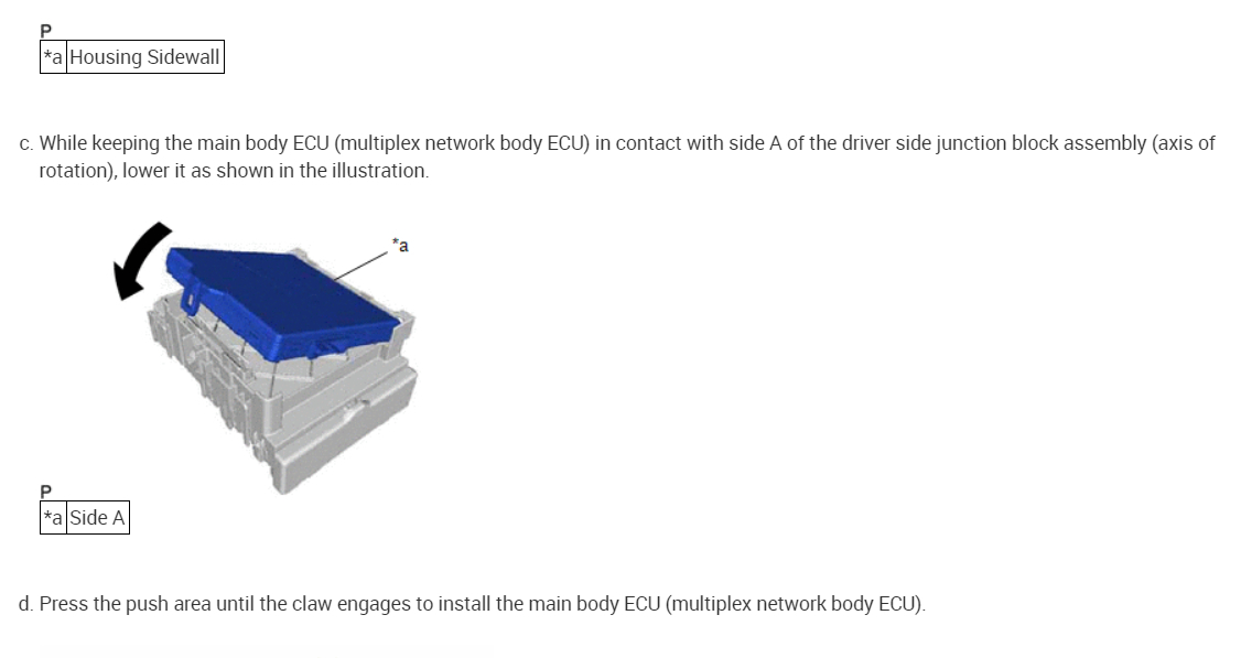

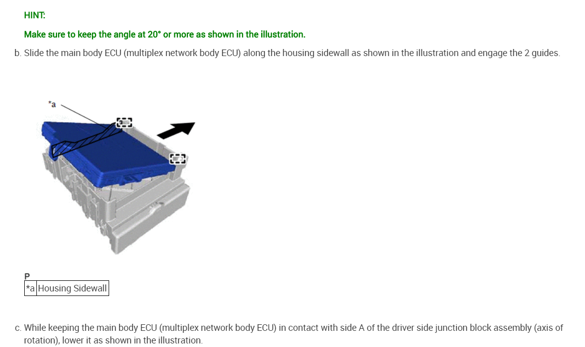

There are 10 fuses that run the headlight system through the main body ECU (BCM). Here is a guide to help check the fuses and the headlight wiring diagrams so you can see how the system works and what fuses to check:
If all fuses are good I have included how to replace the BCM. Check out the diagrams (below). Please let us know what you find. We are interested to see what it is.
