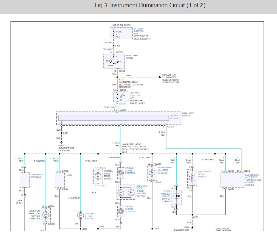

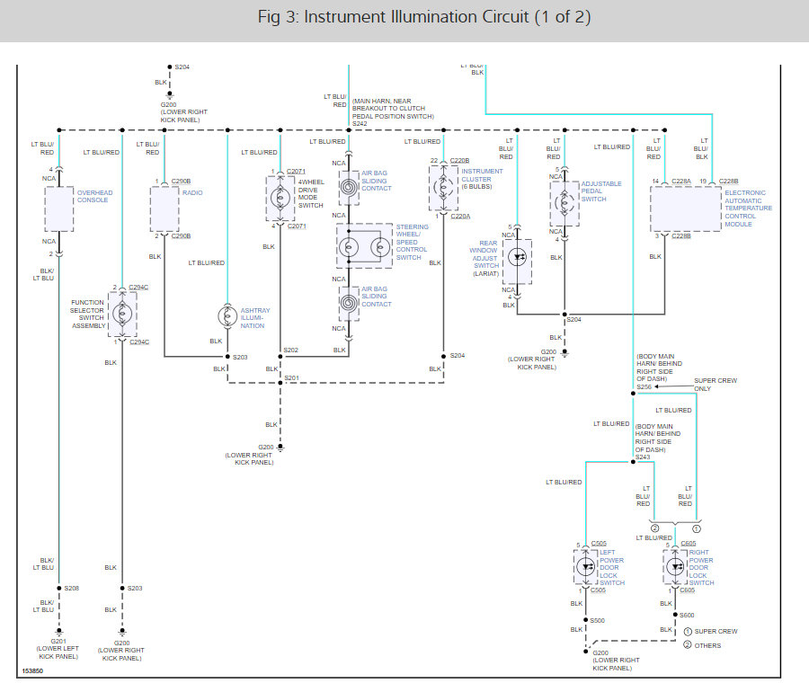

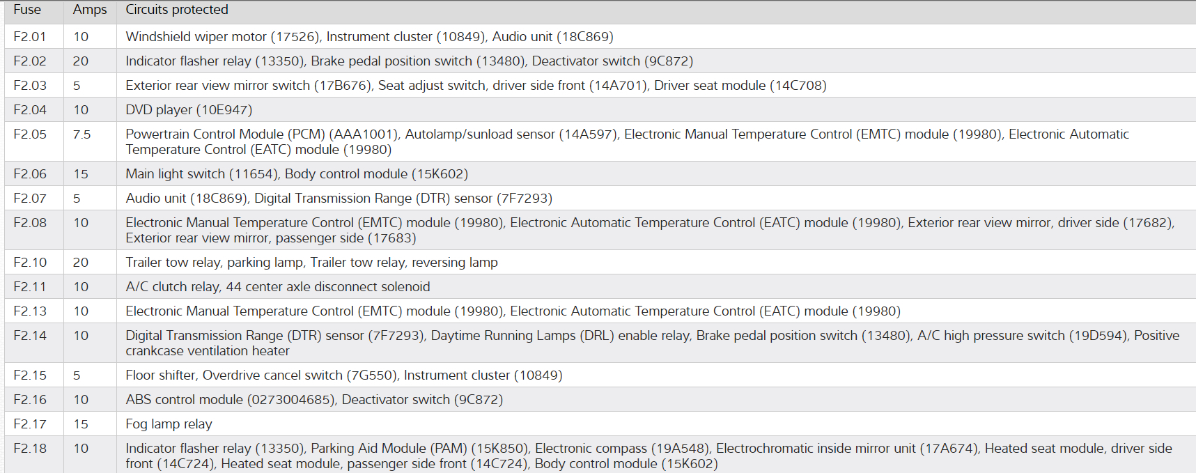

No dash lights; blinkers, brake light, ABS light, all lights work. However, at night cannot see the dashboard. no light at light switch, no light at AC/heater controls. move dimmer light and no light. move dimmer to turn dome light and it works. headlights work, taillights work, parking lights work..

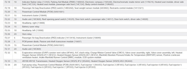

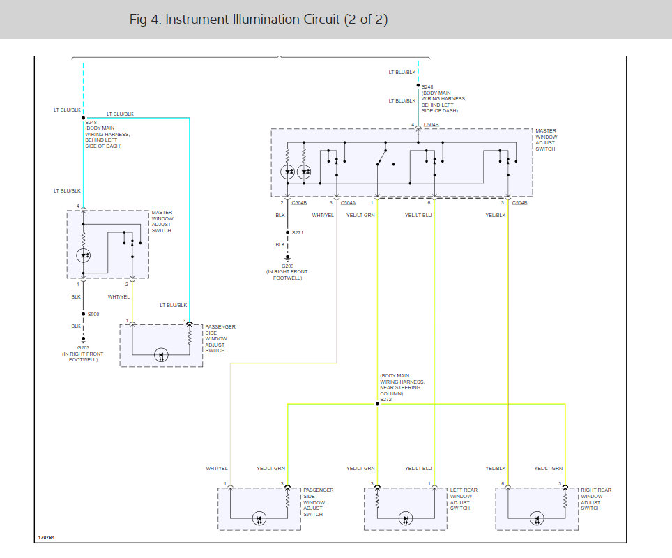

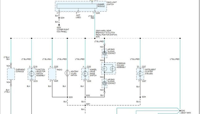

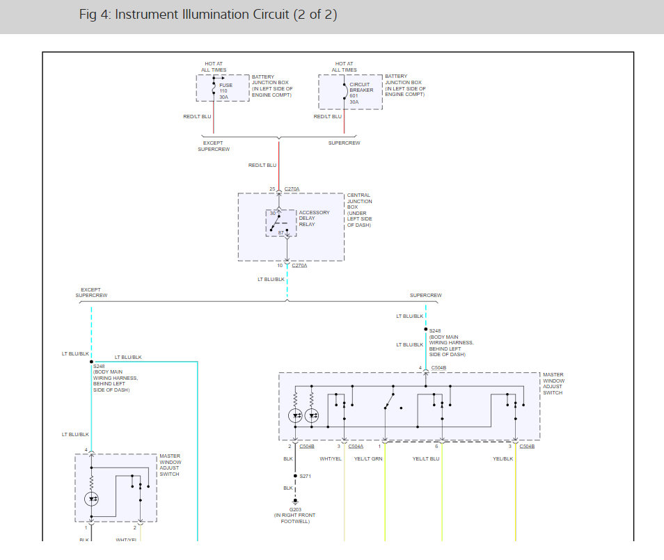

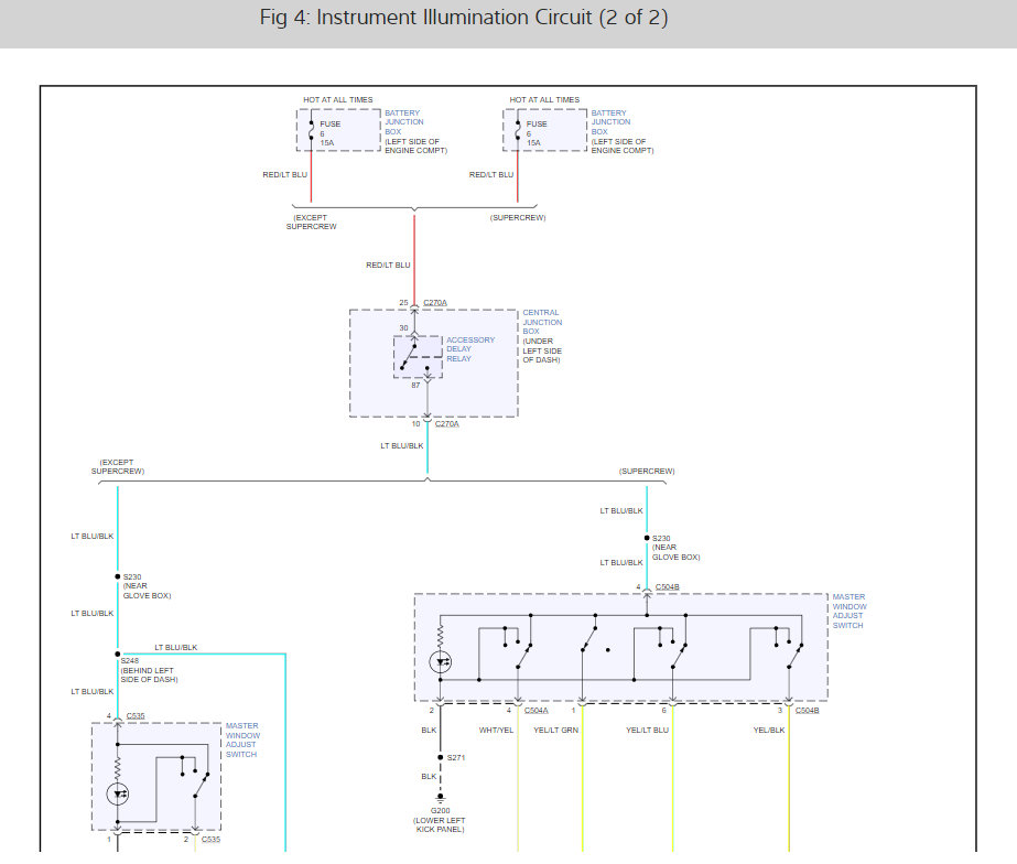

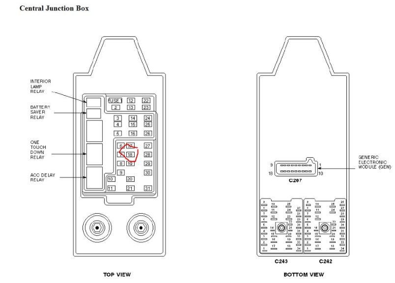

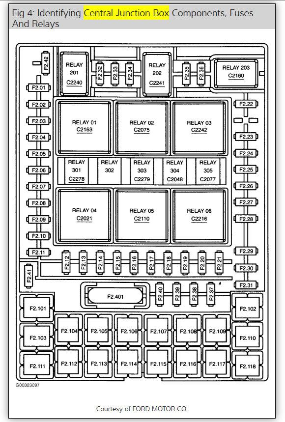

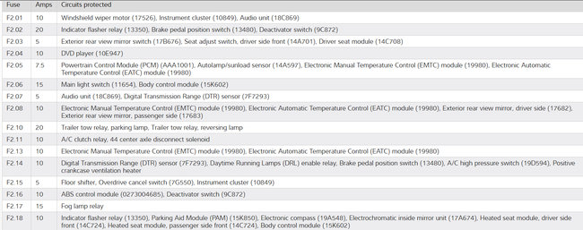

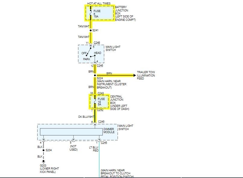

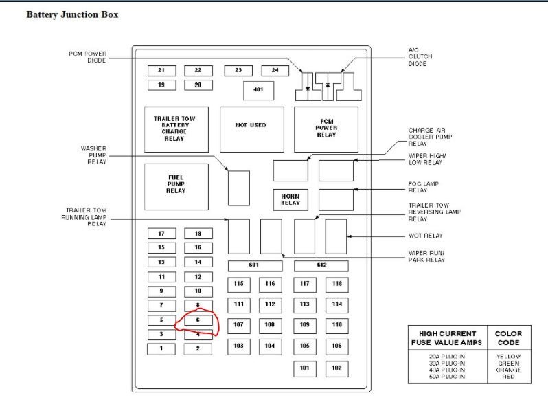

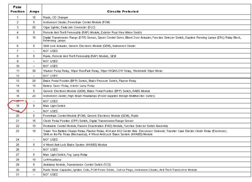

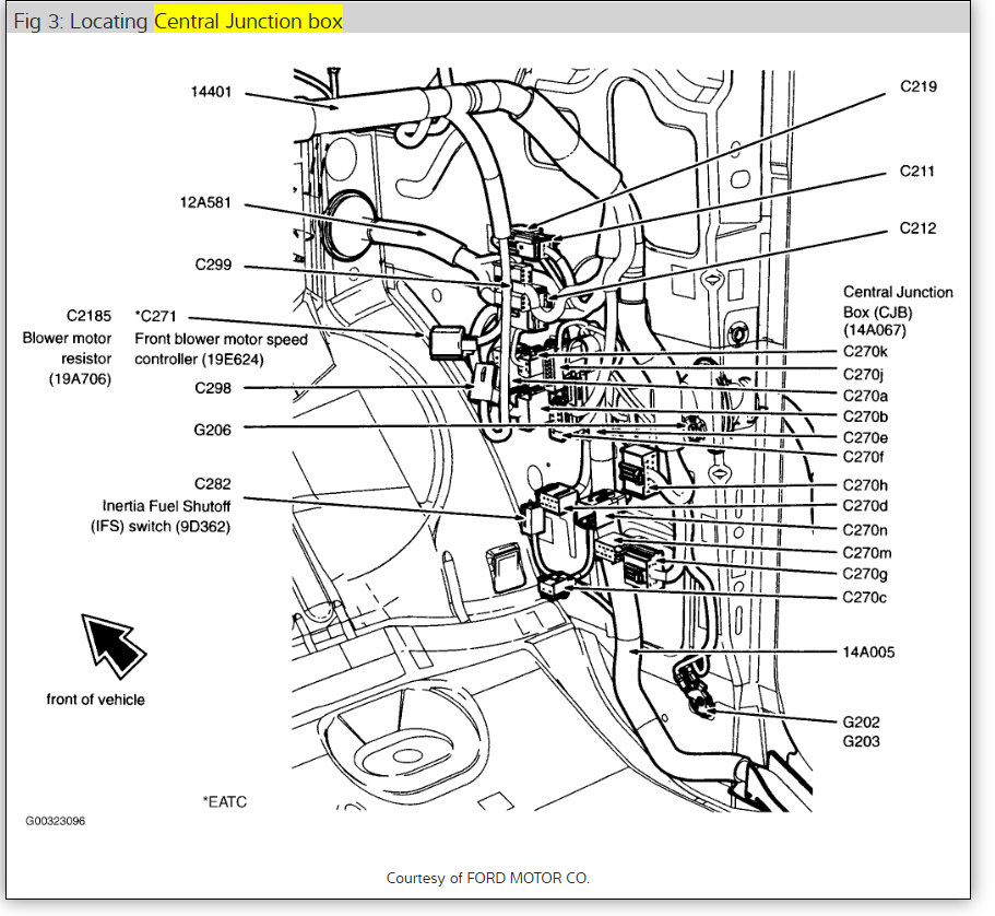

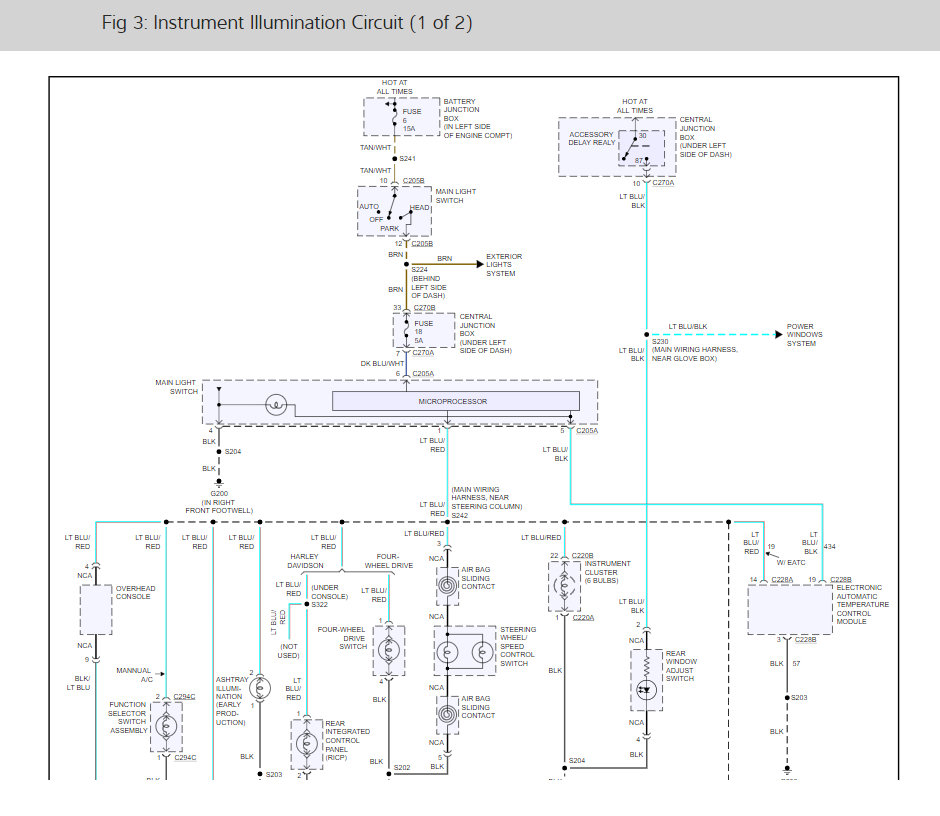

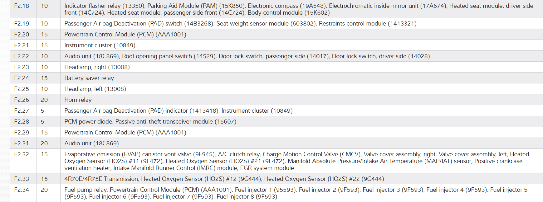

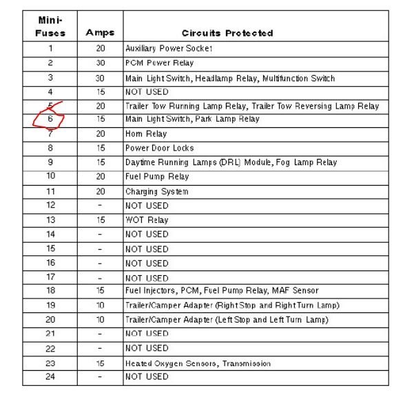

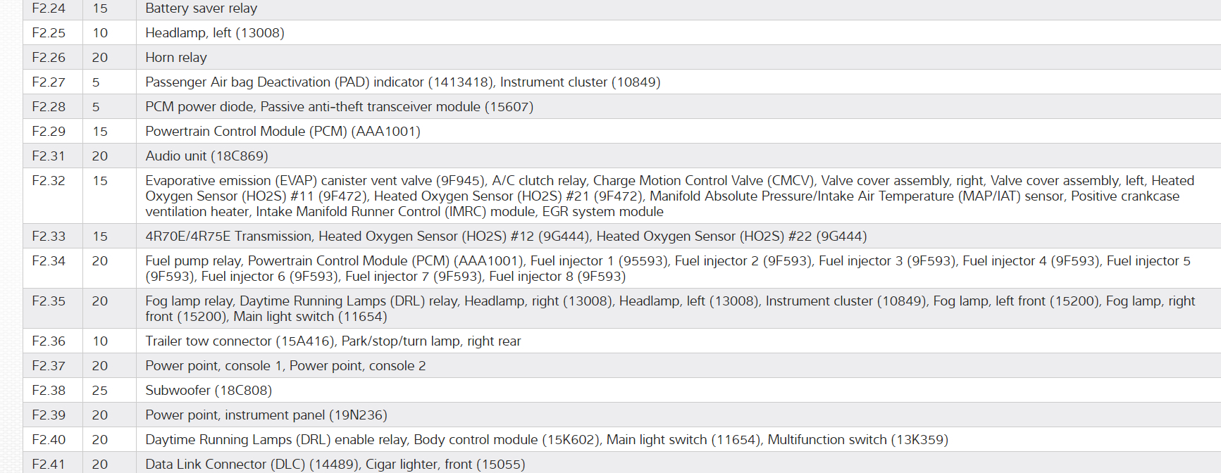

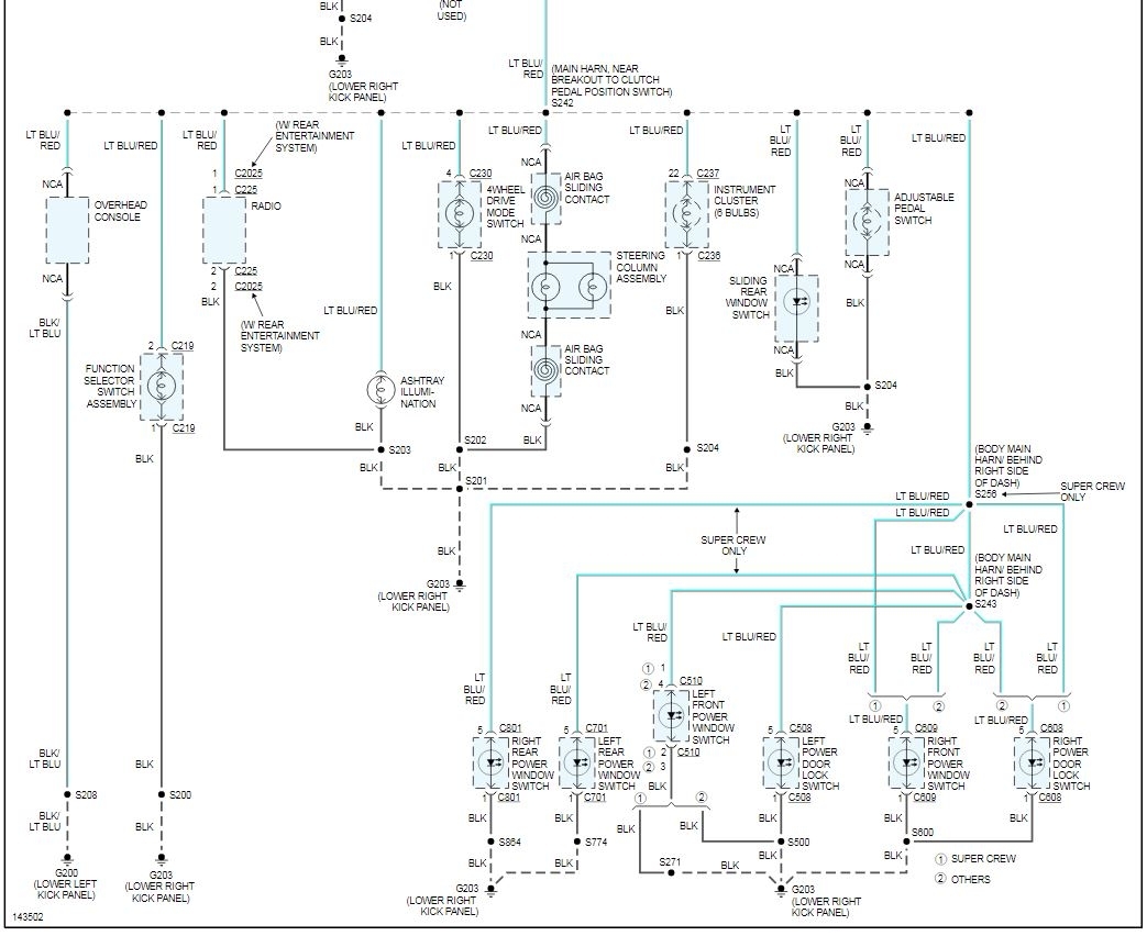

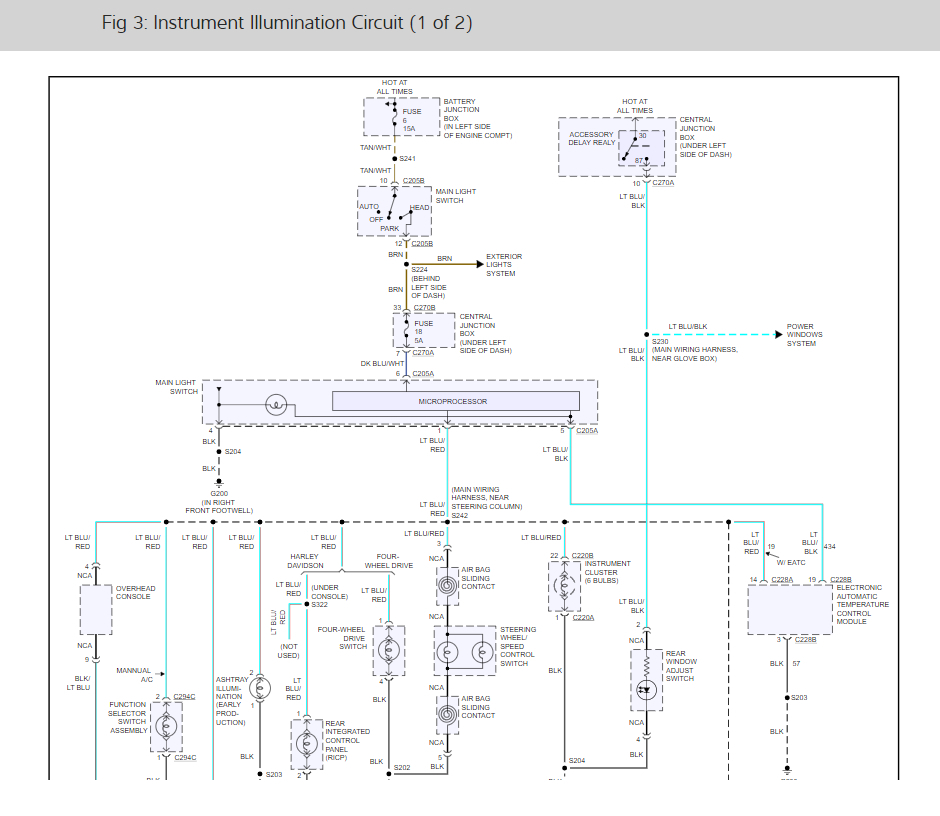

There are two fuses and one relay that run the system #6, 18, and the accessory relay. Here is are guides to help you with the testing and the fuse and relay locations in the diagrams below I have also included thew dash light wiring diagrams so you can see how the system works:

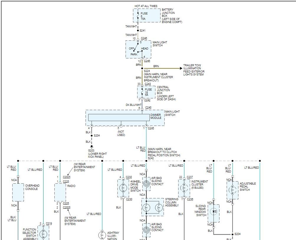

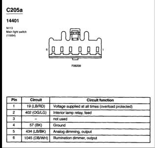

Hi beavr711, It sounds like the headlight switch can be bad but to be sure here is a guide and the wiring diagrams so you can see which wires to check and how the system works. I might need a little more info, are all the lights not working on the dash such as the lighting behind the climate control unit and the lights on the radio etc. or is it just the lights on the instrument cluster that are not working? Let me know. If it is all the interior lights and you have already checked the fuses then more then likely it will be the multifunction headlight/dimmer
https://images.2carpros.com/forum/automotive_pictures/472271_f150_headlight_switch_2_1.jpg
https://images.2carpros.com/forum/automotive_pictures/472271_ford_head_lamp_switch_1.jpg

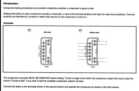

switch that has gone bad there are ways to test it if you are familiar with using a multimeter. let me know which lights are not working and here is a few testing procedures to get you started. https://www.2carpros.com/articles/how-to-use-a-test-light-circuit-tester Check out the diagrams (Below). Please let us know what happens.

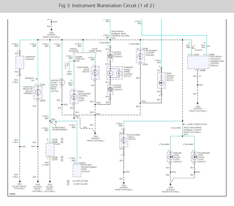

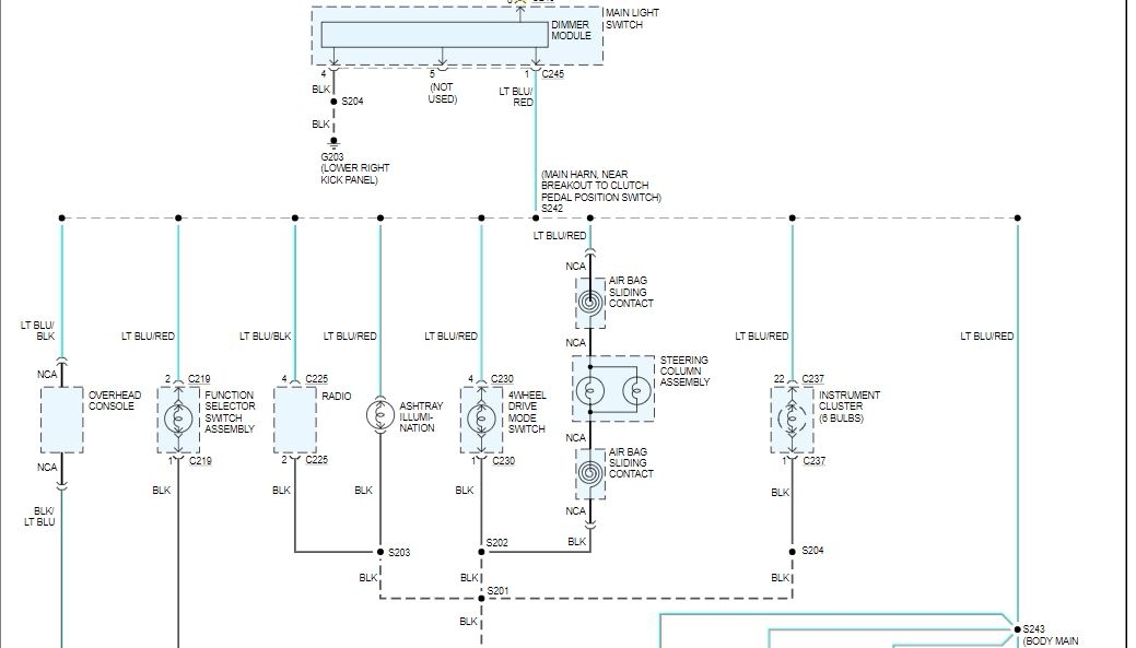

The wiring diagrams helped me find out the switch has bad when to AutoZone got a new one back working again for $43.00.

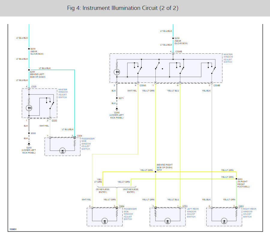

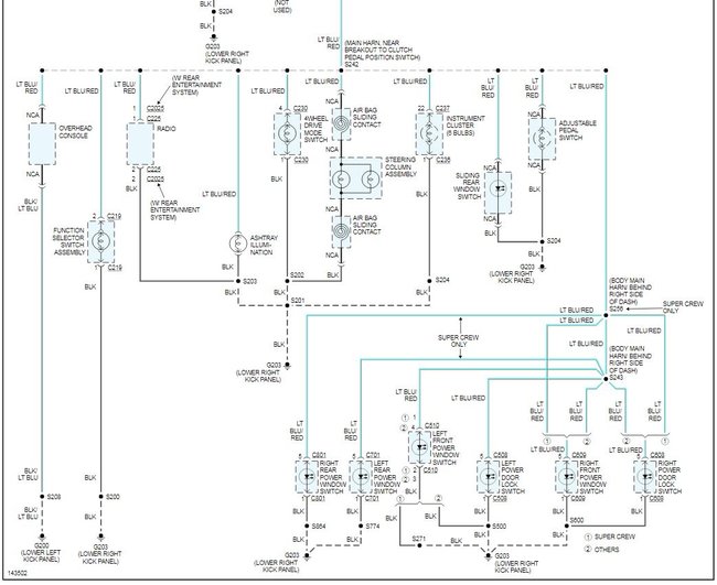

Could be the headlamp switch, could be dimmer switch, could be dash cluster circuit board, could be any wiring in between. You would need to systematically trace the circuit with a test light starting at the power source.
Heres a guide on using a meter and a test light
Attached below you will find the wiring diagrams for your dash lights

Good evening,
I attached the wiring diagram for you to view.
Check the 2 fuses listed for power on both sides as they control the lighting for the cluster.
