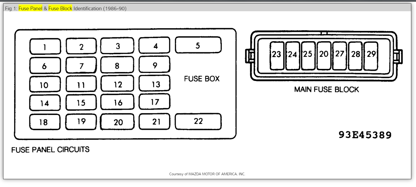

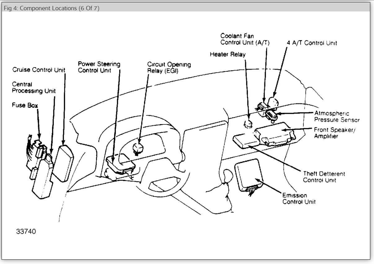

No horn, then a week later, no dash or taillights.
Nov 6, 2017 at 1:17 AM
Experienced Mechanic
110,248 POSTS
Check fuses first. If they check good, make sure there are no body ground wires off, damaged, broken ...
Nov 6, 2017 at 9:21 AM
HAP
MEMBER
37 POSTS

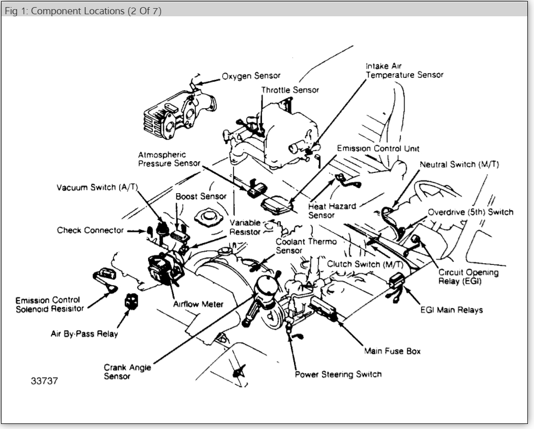

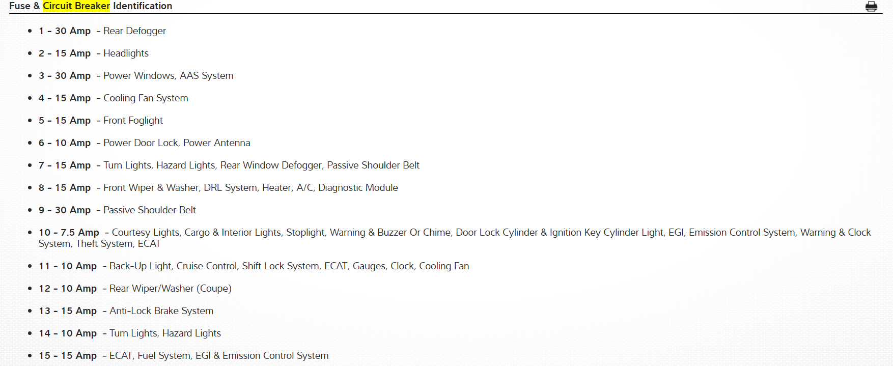

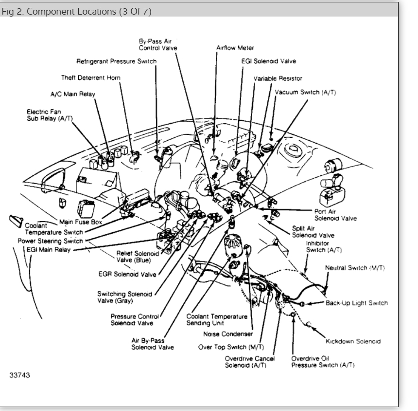

Where can I find the fuses on this car ?
Also, Where can I find a harness plug & the left side cluster switch?
Nov 6, 2017 at 1:36 PM
55,711 POSTS

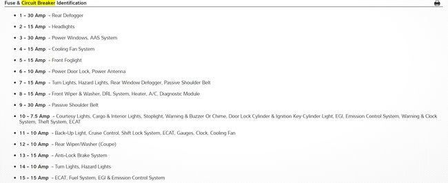

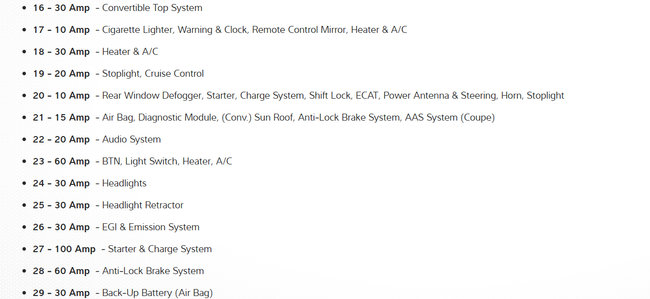

Here is a fuse testing guide and a wiring testing guide as well:
Fuse panel in passenger compartment on left front kick panel.
I have also found a fuse panel diagrams and location for you (below).
