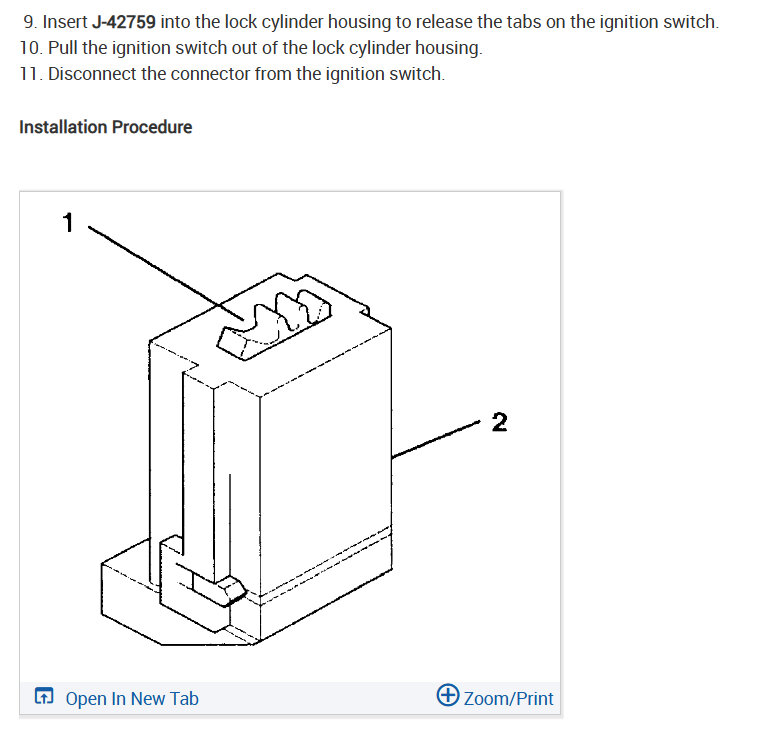

Have no dash lights but have odometer eliminated. No heater, no radio, no taillights. Power windows power locks don't work. All fuses look good but still no dash lights taillights radio heater window door locks.
Nov 12, 2024 at 4:07 PM
  • 55,691 POSTS

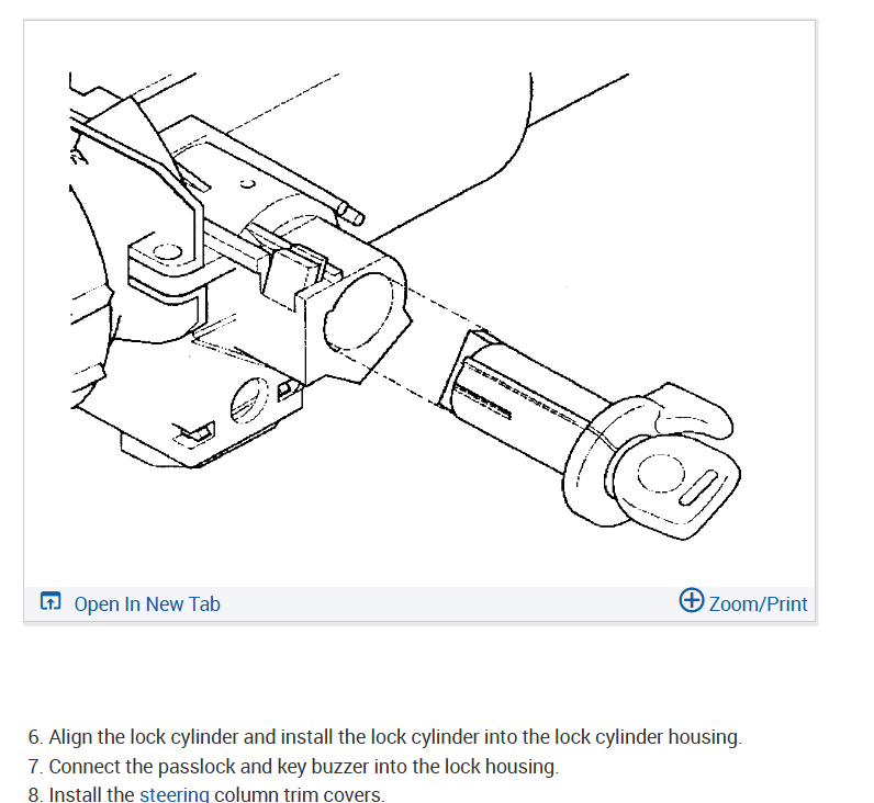

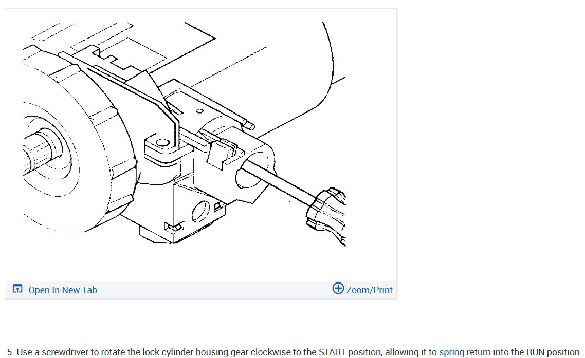

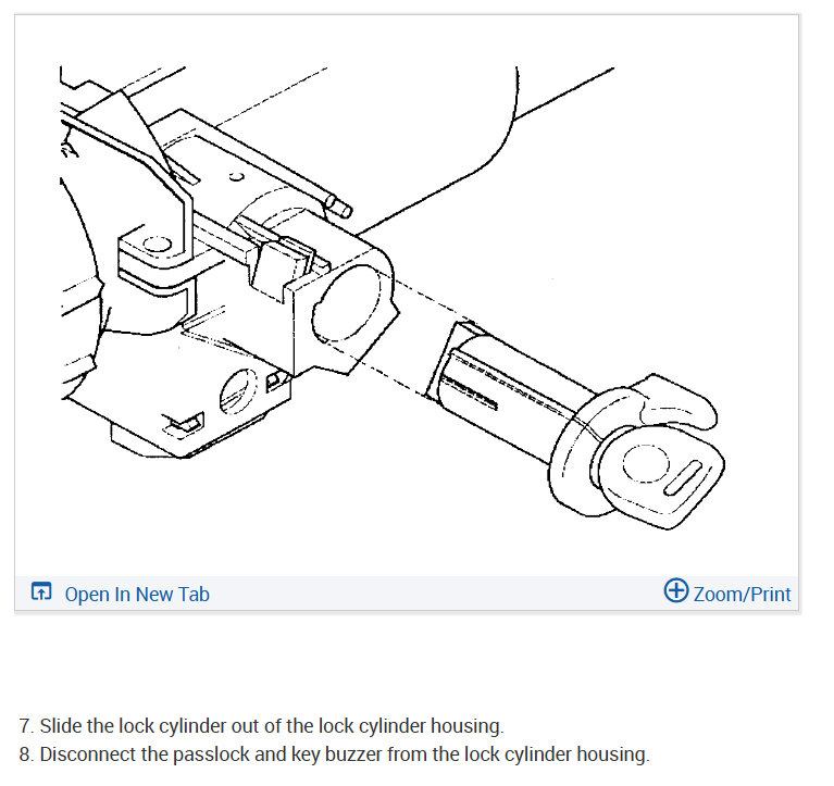

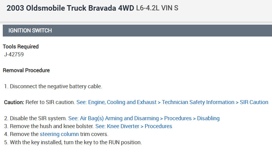

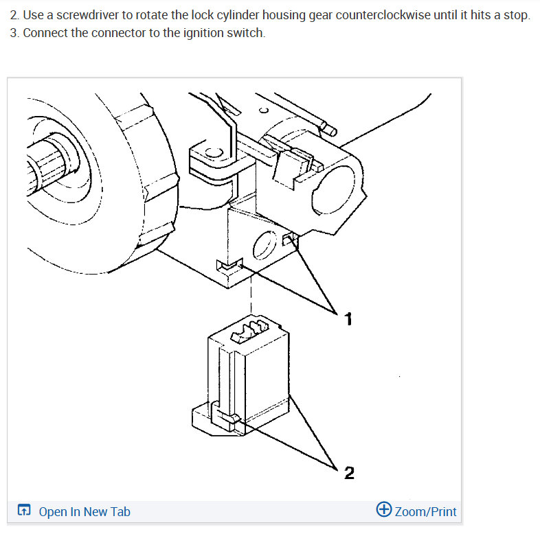

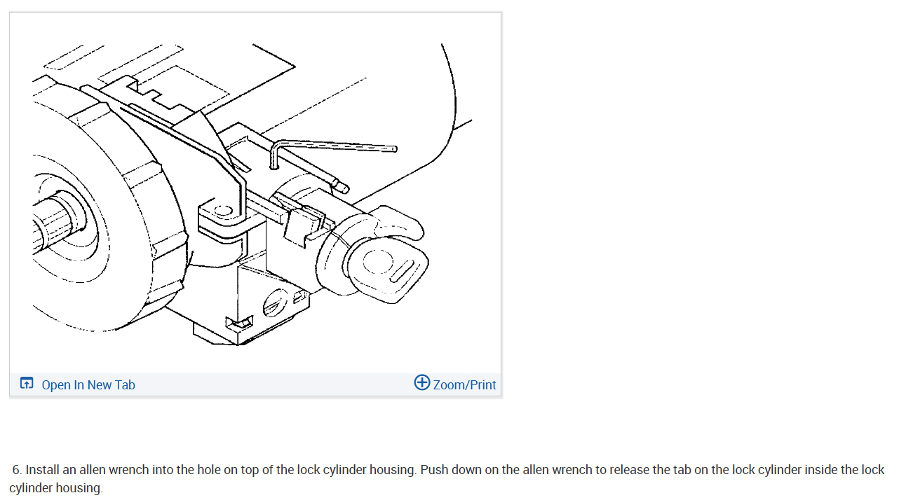

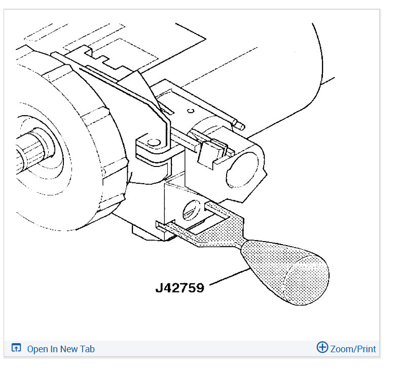

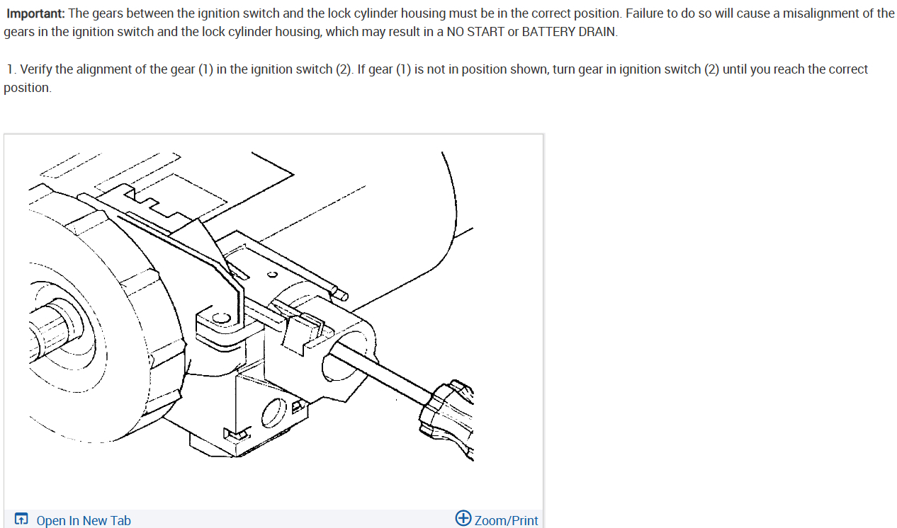

The fuses are probably good but do they have power going to them? This guide can help us see, and if not, it sounds like the ignition switch has gone bad.
I would test the orange wire from the ignition switch for power with the key on. If no power is present the switch is bad. Check out the images (below). Please let us know what happens.
Nov 13, 2024 at 12:49 AM
RICHARD HILL
Thanks for the reply. But it ended up being the 125 Maxi fuse. Thanks for the help.
