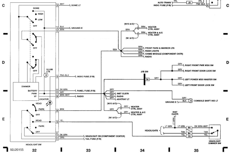

My dash lights and tail lights are not working. All other lights are working fine. Took it to a garage. They checked the fuses. All were fine. Replaced the dimmer switch. They worked for about a week then stopped again. Took it back to the garage. They worked while there and that day then went out again and have not worked since. Cannot figure out what is going on.

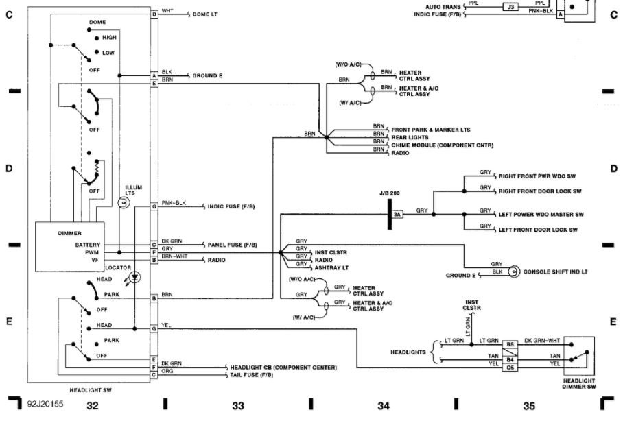

Are you going to try to diagnose this yourself? If yes, with the headlight switch on park, test for twelve volts on the brown wire leaving the headlight switch at pin B. Check out the images (below). Let us know if you need anything else.
