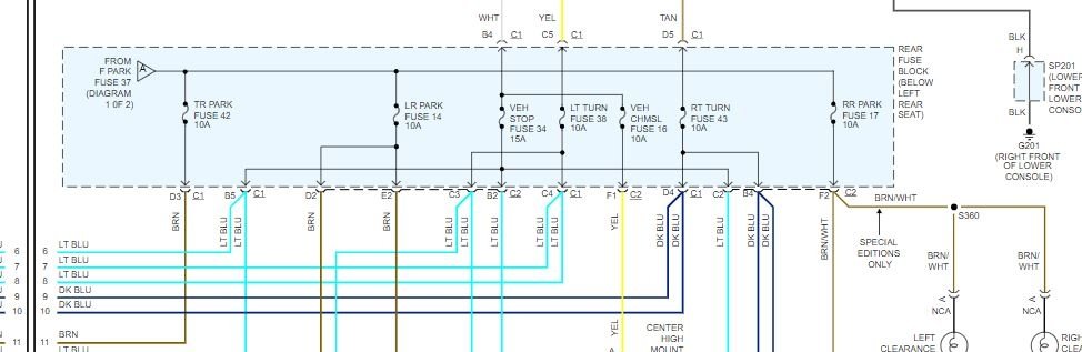

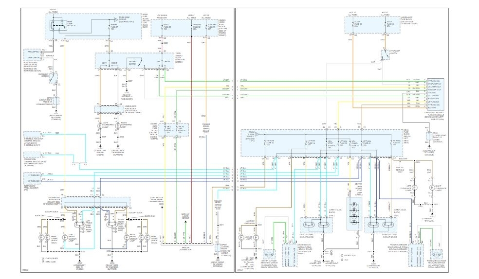

Driving at night I have no dash lights and no tail lights, but the brake lights and turn signals work. Is there a certain fuse located some where in the fuse box to get this working again?
Feb 14, 2019 at 8:37 PM
Good morning,
I attached a wiring diagram of the system for you to view with the fuses that need to be checked. Check for power on both sides of the fuse to be sure there is power available.
Feb 15, 2019 at 3:54 AM

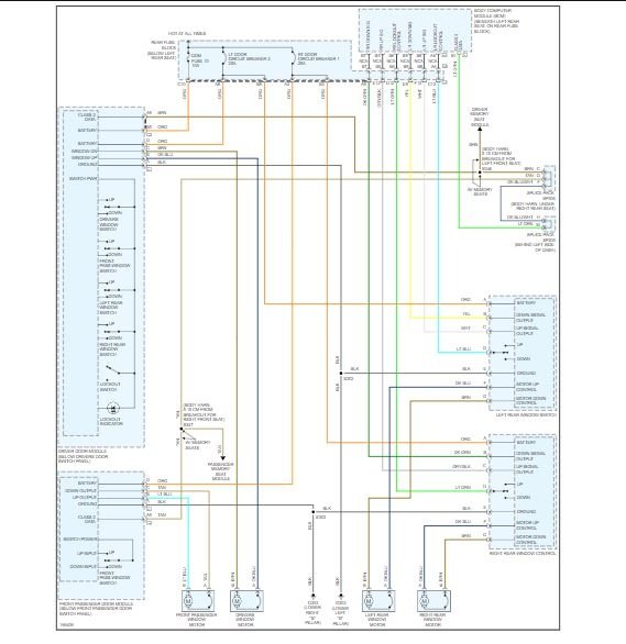

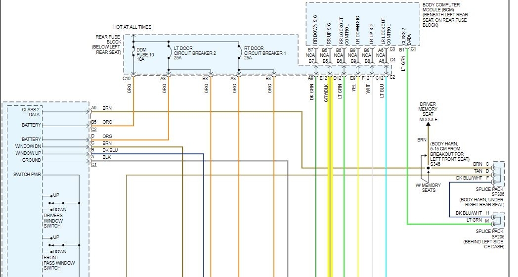

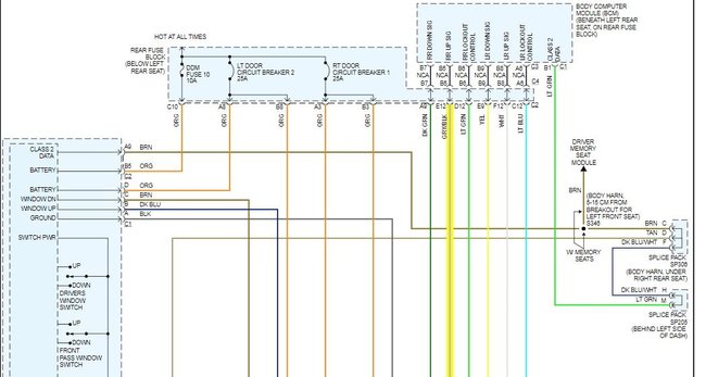

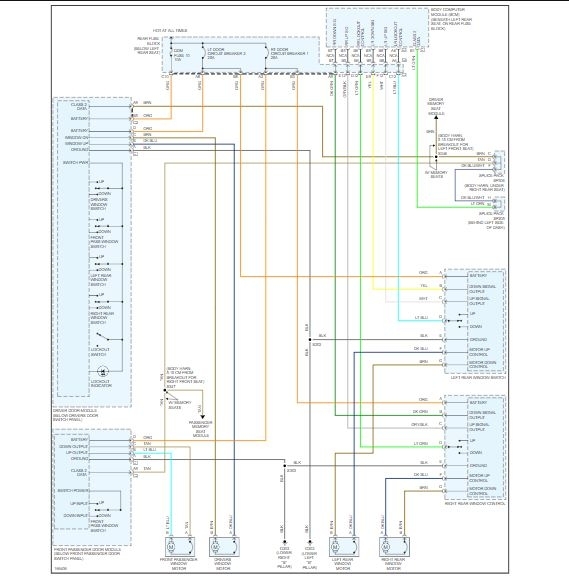

Thanks Roy. what about the fuse for the power windows and door locks?
Feb 15, 2019 at 6:04 AM
Sorry, senior moment.
attached below.
Feb 15, 2019 at 9:23 AM
