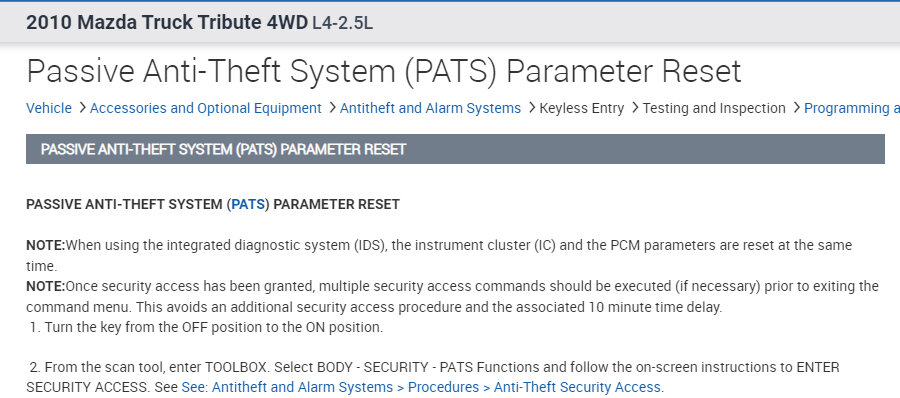

I attached the reset procedure below. Let me know if this is what was done.

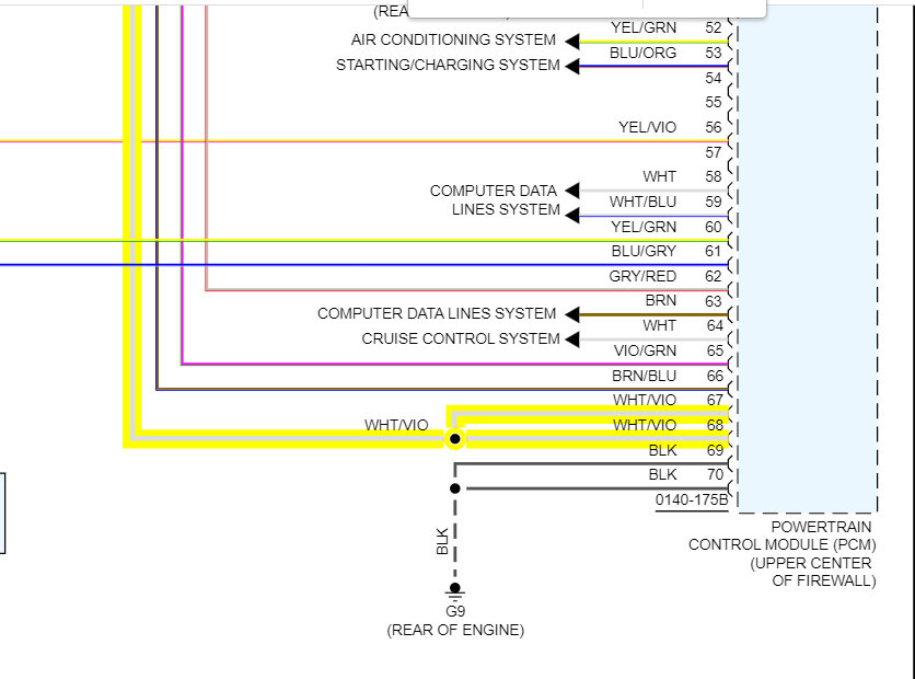

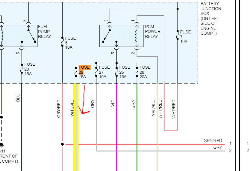

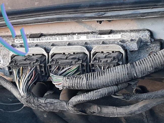

I looked at the schematic and fuse 29 is for the PCM, as you said. Disconnect the PCM and reinstall a new fuse. Does it still fail? If it does, we know there is a short between the fuse and PCM. Next, inspect the wiring connector at the PCM. Make sure nothing is bent and touching.
If the fuse doesn't fail with the PCM disconnected, the short is likely in the PCM. Try what I suggested and let me know what you find. Also, please note that the wire in question is placed right next to the ground pin at the connector, so that could be the issue. See pics below

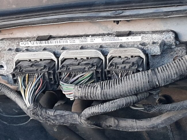

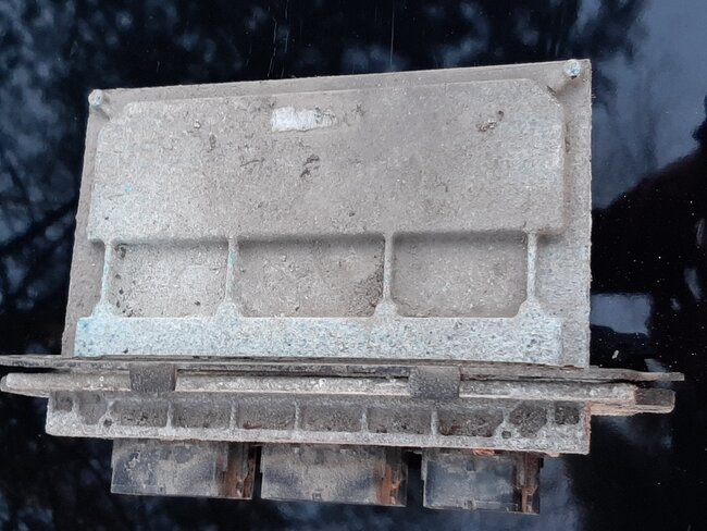

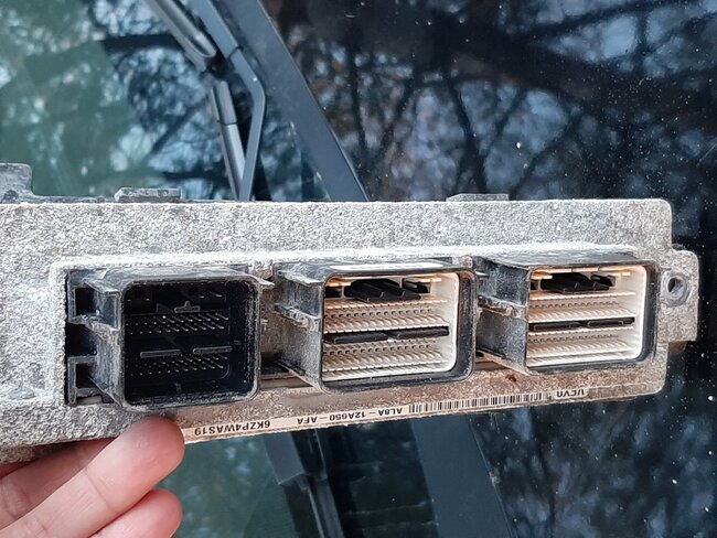

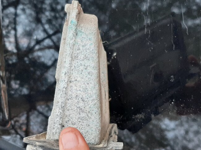

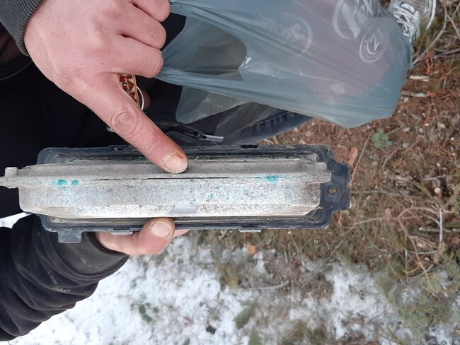

Thank you for your assistance. So, I did the test with the PCM unplugged, 15 Amp fuse did not pop. Repeated the test with the PCM plugged in and it popped right away. Ignition doesn't even have to be turned on. It blew. I repeated the test, by plugging harness back into ECM and 1st plug caused fuse to blow. Left side of fuse was getting full power of battery and right side of fuse was .48 when tested with multimeter. So, I pulled ECM out to inspect. Plugs and wires are all in good shape, but ECM is dirty and corroded and green. On the back has a space in the seam that has a split. So I have to assume at this point between the coils and ECM in this kind of shape it's my problem. Now, I have an ECM I am picking up on Monday from a wreckers. Same make and model, codes, etc. My question is will this have to be flashed? Will the keys have to be programmed as well? I guess this can be taken as a warning for people to check their electronic system more closely. I just purchased this car a few months ago.
Apr 7, 2023 at 9:53 AM
  • 110,248 POSTS
Wow, that looks like it has been through a war. LOL If the fuse pops as soon as you connect it, the short is likely internal. If the connector pins are in good condition, the problem has to be internal.

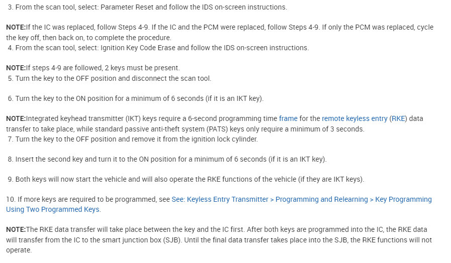

As far as the used one you are getting, I attached directions below. Under normal conditions, the PCM configuration needs to be copied so it can be uploaded to the new one. I'm not sure that is possible with yours.
Additionally, yes, the PATS needs to be programmed to recognize the key, wireless entry, and so on. If you look through the directions, it lists what has to be done.

I have added an arrow to pic of connection that caused fuse to blow. So I have to assume no short in wiring definitely ECM with the shape it is in.

The directions above are for the PATS. If this isn't done, the vehicle will likely not start. It will set the immobilizer.
I hope it works for you. If you have a chance, let me know how it turns out for you. I'm interested in knowing.
