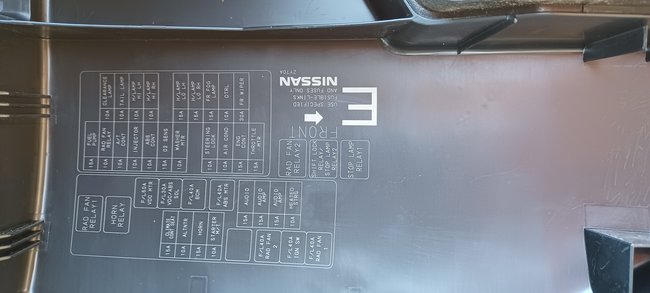

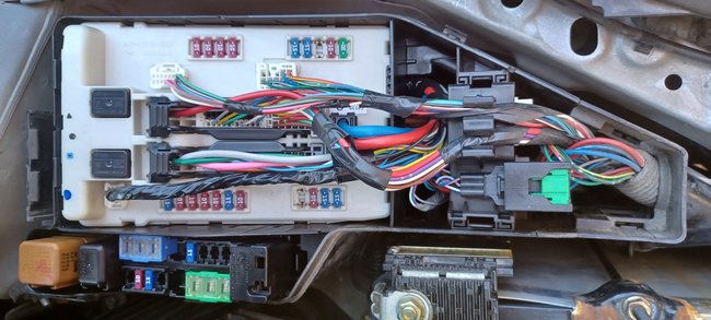

I found an "Eng Con" 15 Amp fuse under the hood was blown.

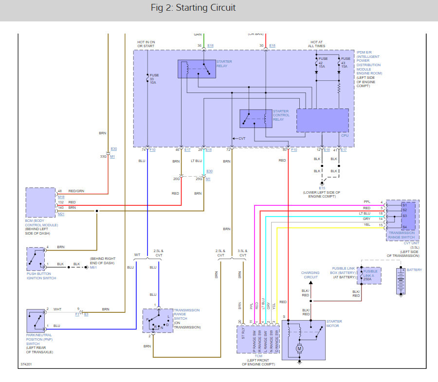

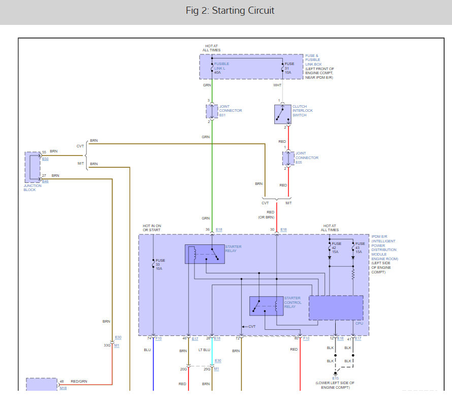

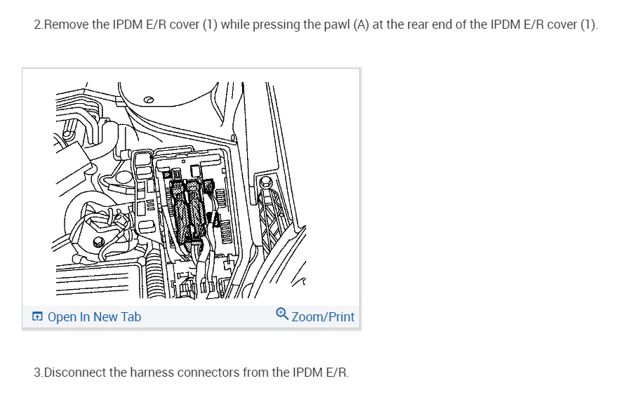

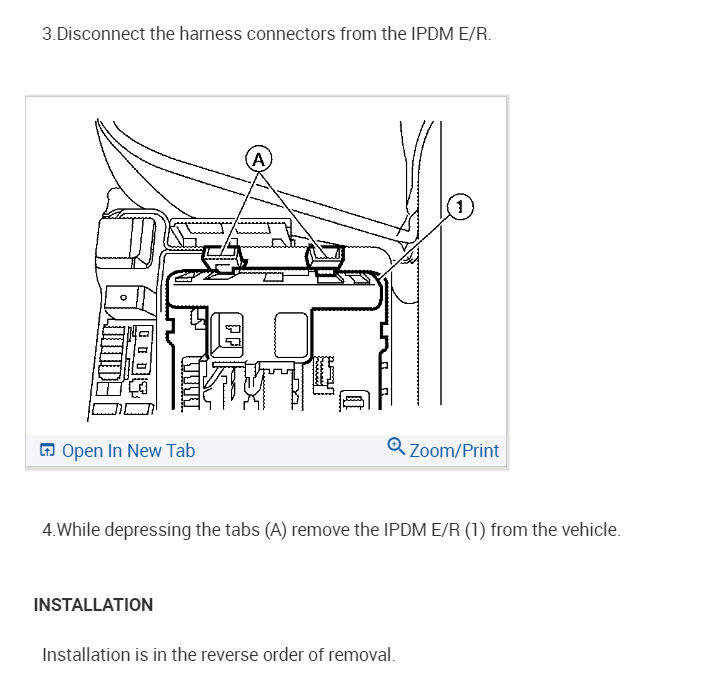

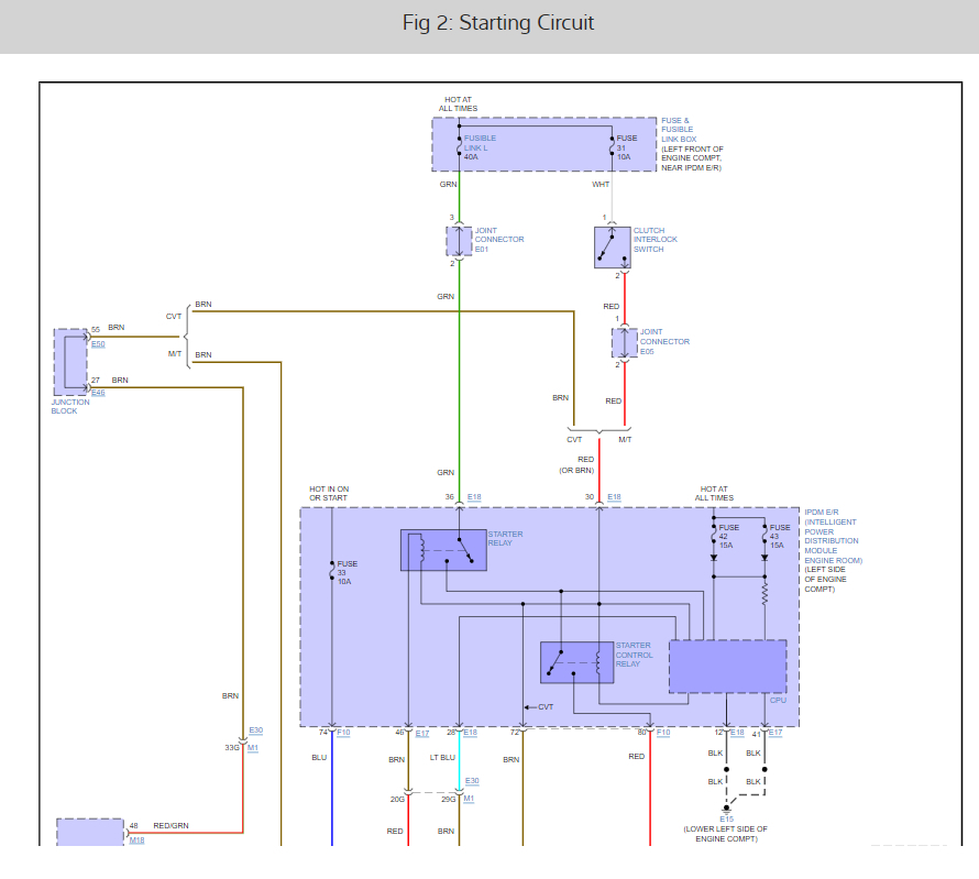

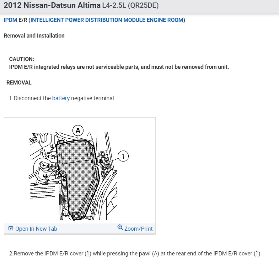

Which number fuse is it? They don't show it by name, but it sounds like the IPDM needs to be replaced because this has two starter relays inside of it. It is common for this unit to go out. Here is a wiring diagram so you can see how the starter system works and how to replace the IPDM which is easy because it-self learns in the images below. Check out the diagrams (below). Please let us know what happens.

The white box, 2nd fuse from the bottom on the left. The 15 Amp fuse that's upside down. Had blown.

Thanks for the images, when you replace the fuse does it blow again? if so I would unplug the ignition coils and try to replace the fuse and then turn the key on to see if the fuse blows gain if not, plug the coils in one at a time to see when the fuse blows this will be the bad coil.

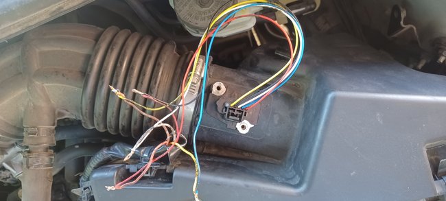

I used propane. I'll go buy a can and use the spray.... I thought I had it wired correctly, maybe not.... my MAF. Are you able to verify the wiring? Different colors on the pigtail.
