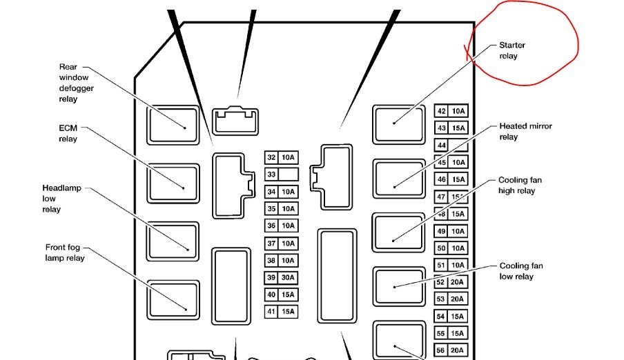

No crank which relay and terminals
60,000 MILES • 4.0L • 6 CYL • 4WD • MANUAL
PERRY PELTONEN

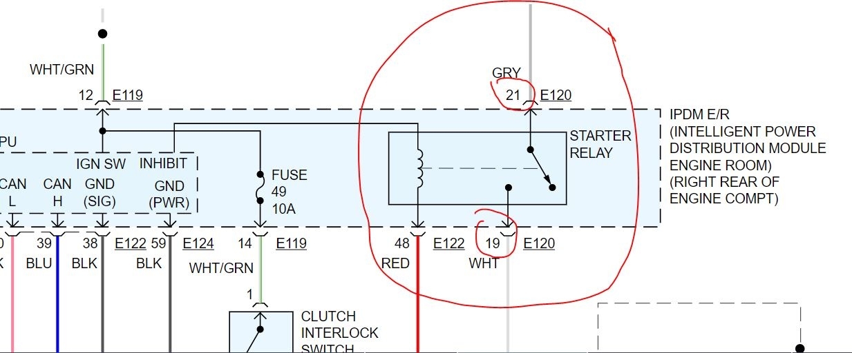

your answer pull relay jumper wire 19 to 21 which relay see no numbers.

Welcome to 2CarPros.
I need more information. What is happening with the vehicle and where did you find the information you mentioned?
I attached a picture below showing the starter relay. It is under the hood in the intelligent power distribution module (IPDM).

search your site pops up on 2008 Nissan 4.0 l 6 speed manual. no crank new battery fuses relays,one click is all i get.

Diagram of jump wire attached. meant to see if it is starter or neutral safety problem.
Oct 30, 2019 at 12:59 AM
PERRY PELTONEN
not clutch pedal rubber button.

I attached a picture of the starter relay. The picture doesn't indicate pin allocation, but does identify wire color. You will need to locate both a white and gray wire. The relay is under the hood in the relay box.
When you say there is no rubber switch, do you mean there is no clutch interlock switch?
Let me know if this helps.
