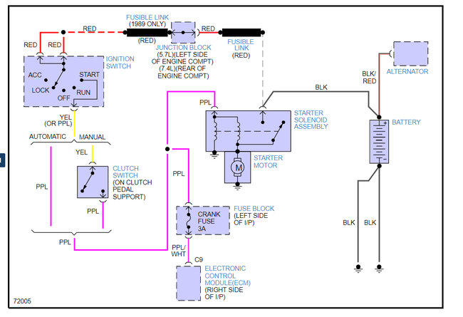

Fried the starter wires so I used a starter button and that worked for a few days then no power to the dash.
Jul 23, 2022 at 10:44 PM
  • 55,273 POSTS
Have you checked the fuses? Also, you must have a good ground to the engine from the battery and then to the frame. Did you fix the fusible links at the starter? Here is a wiring diagram for the starter so you can see how it works:
Jul 24, 2022 at 3:50 AM
MONEYBALL76
Where it says left or right of i/p in the wiring diagram what are the referring to?
Jul 27, 2022 at 3:40 AM
  • 55,273 POSTS
This means the fuse panel under the dash on the left side.
