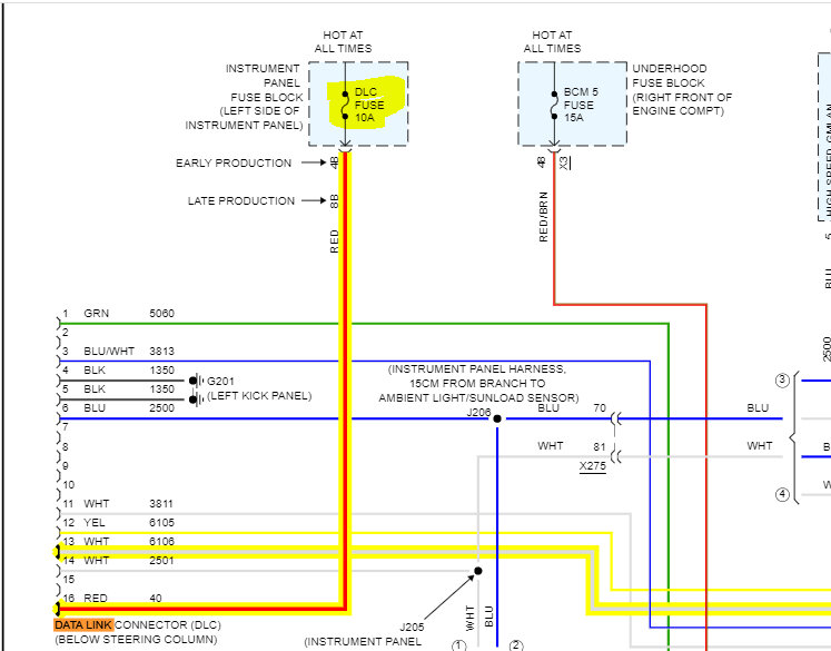

No obd2 power. No security light at all, all lights come on as they should, it even has the date and time correct on the stereo after sitting with a dead battery, also put a new ECM on the car. Please help me I’m overwhelmed.
Nov 8, 2022 at 7:34 AM
  • 110,240 POSTS

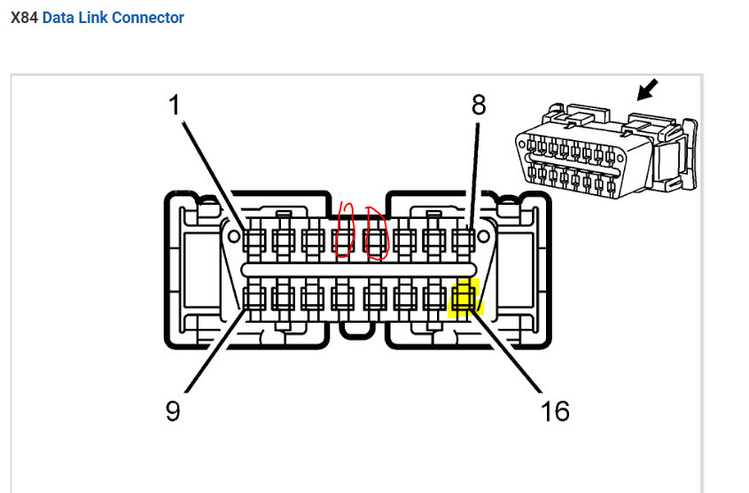

Let's start with the data link connector. I attached a pic of the connector below. I highlighted pin 16 and circled 4 and 5.
Check pin 16 for battery voltage at all times. Pins 4 and 5 are grounds. Confirm there is continuity to ground.

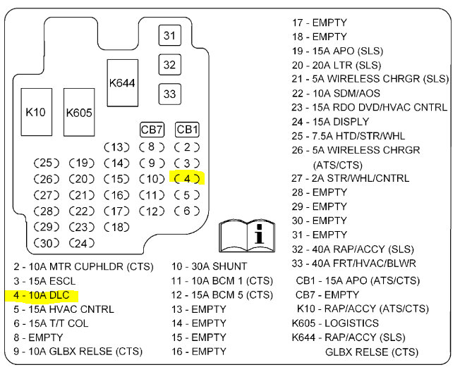

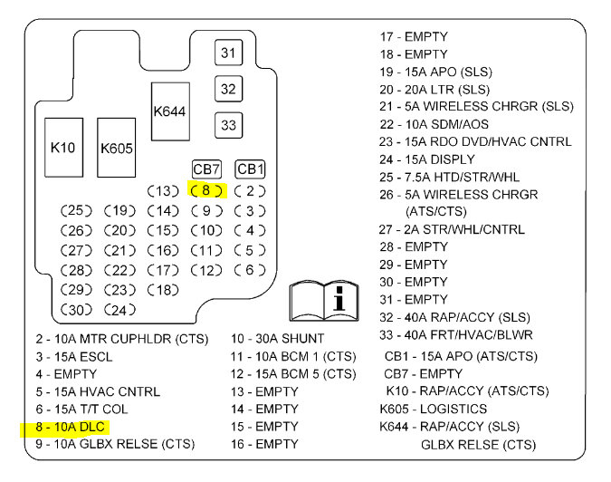

If there is no power, I need you to check the DLC fuse in the instrument panel fuse box. I attached two pics below. Pic 2 is for a late production and pic 3 is an early production vehicle. They moved the fuse. LOL When you check this fuse, not only is it important to confirm the fuse is good, but also you need to confirm there is power to and from the fuse.
Do this and let me know the results.

Okay, so I checked everything you said. Both grounds are good but no constant power or power at all to pin 16. Checked the DLC fuse and have power to both sides. Now what I’m stumped here! Thanks in advance. I’m here with the car rite now, so if you get this and think of anything let me know.
Nov 10, 2022 at 2:07 AM
  • 110,240 POSTS
The red wire that goes to the DLC may be damaged. What you need to do is trace it to see where power is lost. If the fuse has power, something is preventing it from getting to the pin.

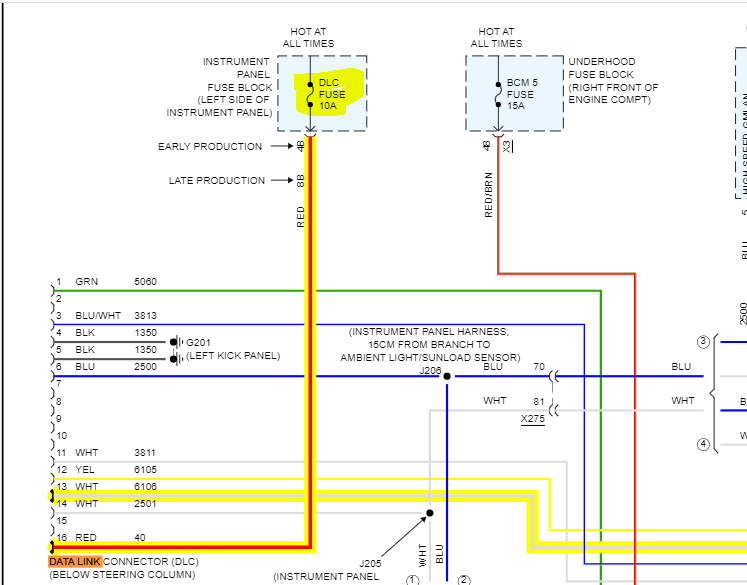

Diagram says it runs from the fuse straight into pin 16, but when I look at it, I don’t see how that’s possible.
Nov 13, 2022 at 2:06 AM
  • 110,240 POSTS
What is presently in pin 16? Is it a red wire? Let me know why you feel it doesn't seem possible.
