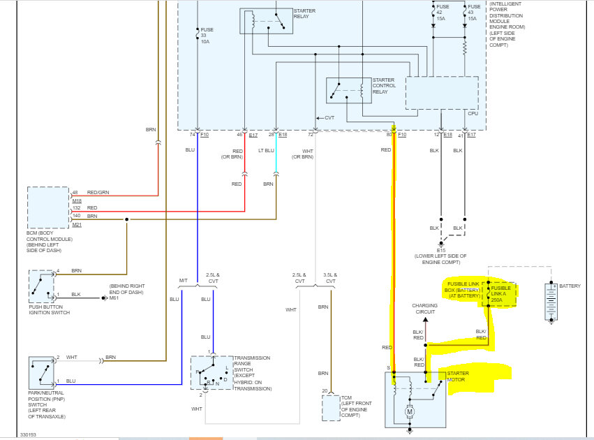

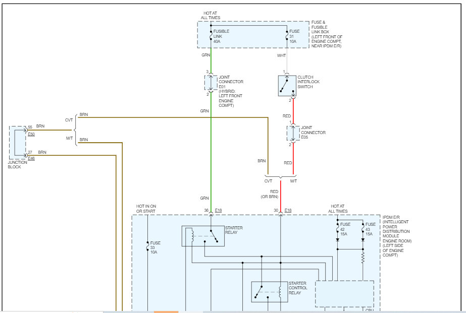

If the starter clicks, chances are it is either bad or we have an engine issue.
Do me a favor. I attached the starting circuit wiring schematic, so you have a reference. At the starter will be a heavy gauge black wire with a red tracer. It should have battery voltage at all times. Check that for me.
Next, there is a smaller gauge red wire that will not have power until the key is in the start position. Have a helper turn the key to start while you check if you are getting power to that wire.
Let me know the results. Also, if you could record the click you are hearing and upload it for me, it may be helpful
See pics below. Note: I had to cut the schematic in half to make it readable for you. I did overlap the two so you can follow from one to the next.
Jan 25, 2023 at 12:47 PM
