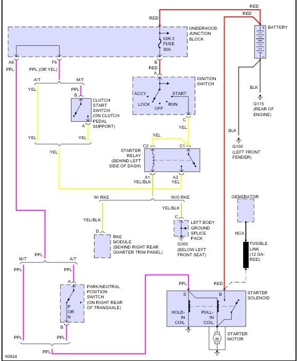

My car will not start after getting music hooked up and I would like to know how to bypass the solenoid to get my car to start. Help would be greatly appreciated, thanks.

I assume you meant the relay not the solenoid which is on the starter. According to this wiring diagram, jump at the starter relay terminals C2 to A2 with the key on start. But if you meant at the solenoid, jump 12 volts to the S terminal where the purple wire is. Make sure you are in neutral because you will be bypassing the neutral switch.
